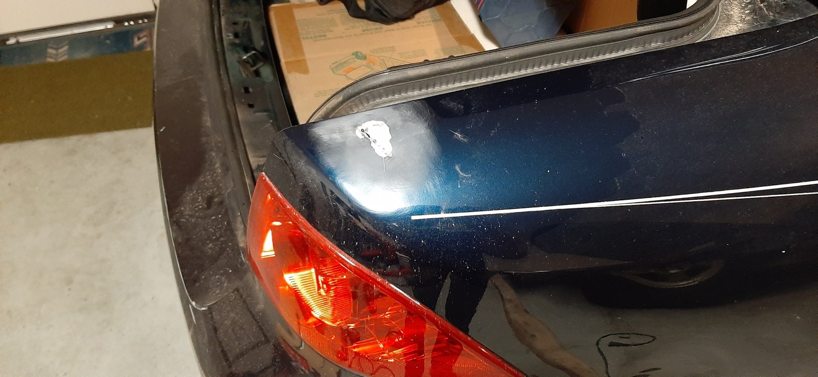

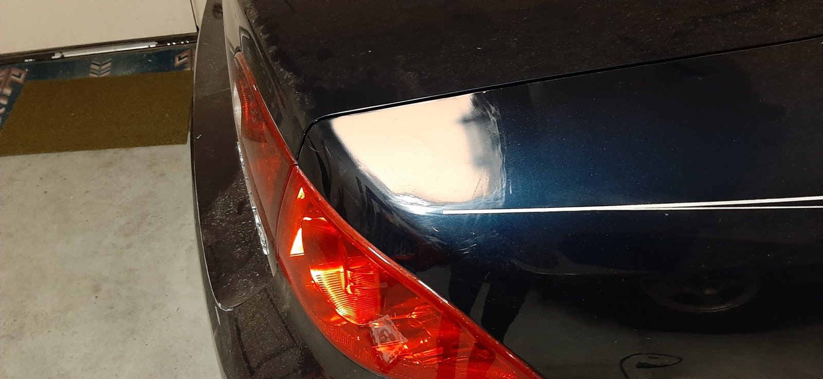

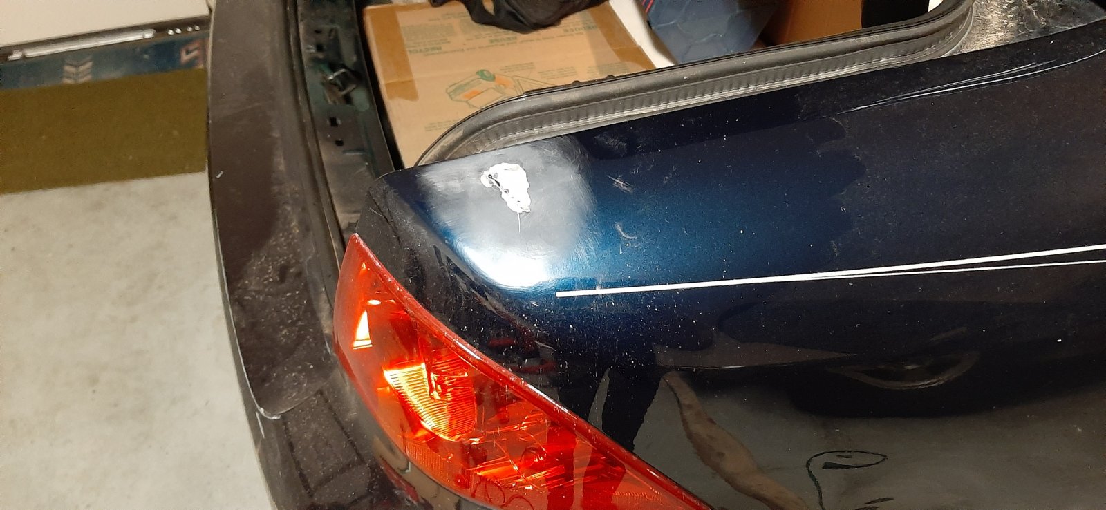

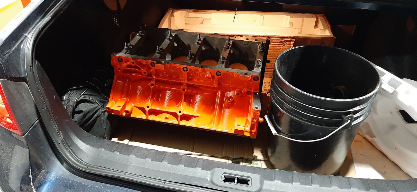

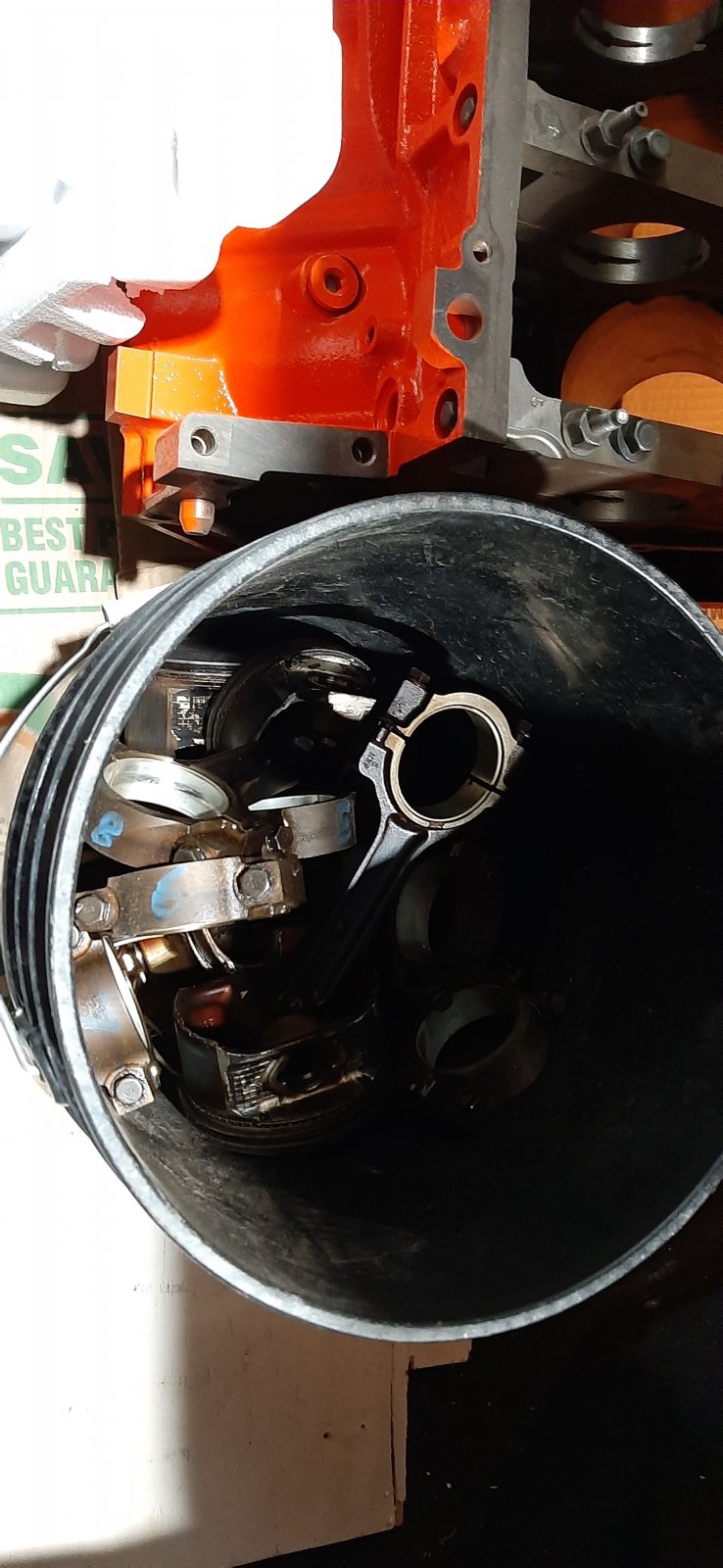

I felt like a kid in the candy store. Picked up the 6.0 block today. Guy was is an engine builder in Los Cruses, NM. He had all the cool stuff in his shop and was like a rolling encyclopedia of knowledge and experience on engine building. His friend was there who listed the block on facebook and they were building an engine for him. Chevy 350 with roots style blower and two massive cathedral style 4 barrel carbs on it.
He sold me the LQ4 cam, LQ9 (full float rods), LQ4 pistons, prepped and ready 6.0 Block, and a wind-age tray for $950. Not a steal but not too bad a deal either. I'm not sure what cam I want to use but he threw it in. They all swear by the LS9 cam but requires some cam sensor hackery to get it working as well as a custom tune. I have software to tune truck but know enough that it's a PITA to tune.
Only blooper was I went to get the block out of my trunk, and the damn engine hoist fell over and punched a hole in the back of my good car :( I'm now doing a little body work to fix it.
20201111_182233.jpg 20201111_182239.jpg 20201111_201002.jpg 20201111_211156.jpg
33,336
51,819
View attachment 262265 View attachment 262266 View attachment 262267 View attachment 262268
Sux about the dent. How much does a bare block weigh?
Thx :( Yeah little sad my dd is taking a beating.
The block was manageable with 2 people to set it in the trunk. I think it's 215lbs. I just couldn't lean over and pick it up out of trunk alone haha. Now that it's out of car I can pick it up and move it around. Although it's a bit of a back breaker :|
