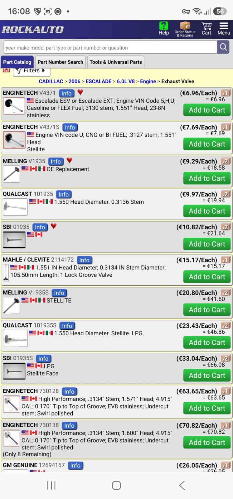

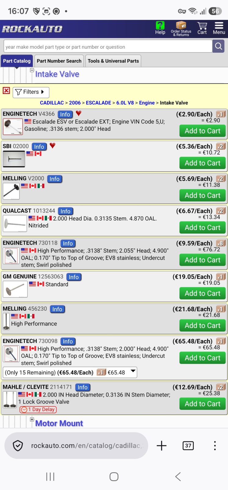

Now I wanted to order valves and a cylinder head gasket set from RockAuto or elsewhere, so I can finally do my engine overhaul.
However I'm having trouble finding the right parts because I saw on RockAuto that they offer valves in different sizes, both in diameter and length.
And I don't know anything about the different valve manufacturers or which ones are recommended.
So I am a bit lost as to exactly which valves I need to order.
Does anyone know anything about this topic and can offer some advice, as well which cylinder head gasket you would recommend?

No, I'm not talking about the fact that intake and exhaust valves are different sizes, that's obvious.
Rather, as you can see in the two screenshots from RockAuto, the valves are offered with different descriptions. For example, if we look only at the intake valves, it says "dia, stem, head," and the values are all slightly different.
For some, this information isn't even included. So, I'm wondering which valves are right for me?
Do I need to measure them using specific tables, or are the differences so small that they're irrelevant?
Of course, I'd hate to order valves, install them, finish my cylinder heads, complete my engine, and then find out something doesn't fit...
