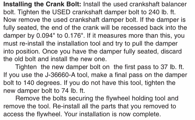

I think if you’re around .15” I’d put in the old bolt, torque it to 240, take it off and check where you’re at. I think Gm service info says to tighten to 37 plus 140 degrees, and 74 isn’t an option. However I’ve had new Gm bolts that would not stretch that far, and I think we called it enough when we struggled to get past 100 degrees, and checking with a torque wrench we were over 250 already

@ks03 OMFG haha I had not read that far yet in my build book. I don't think it has a lot of the fine details anyways. It assumes everything goes together perfecrly with no questions.
Wow 140 degrees. Damn its on tighter than my front 4wd hubs! Wow, but head def don't want it to come off.

Crank bolt......I have an ARP because I was not going to buy a new bolt every damn time.
Lock the flywheel and take it to 240ftlbs and done

I don't have a torque wrench that goes to 240 haha Maybe I need to invest in one. My hubs I guestimated by over turning the wrench.
Suprised a lock would hold to 240... I have one but wow. Did you install it on the engine stand or in the truck? Afraid I might break a stand haha

I’ve only done them in the vehicle, lots of potential to knock it over trying to do it on a stand.
I don’t know how critical this really is, or what the potential fallouts from incorrectly torquing this are, but I know lots get slapped back together with the old bolt and a couple impact burps.

I use an impact wrench. I use the old bolt to put it in then the new bolt when done.
And by done I mean in the car with the accessories on to make sure the belts lines up.
I think on this one position is much more important than torque.

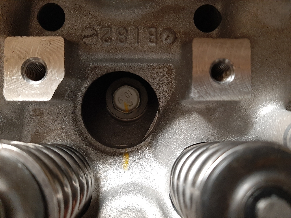

Don't lube the factory head bolts and, yes, they have a dry thread locker on the end of them. I use a protractor to make a template and put marks on the heads around each bolt hole, one at "zero", one at 90° then one at 70° from that 90° mark. I do the initial torque to 22 ft. lbs., mark the head of the bolt at the "zero" mark, turn the bolts so the mark on the head meets the 90° mark, then finally to the 70° mark. This is on a Gen4. Gen 3 has slightly different specs. https://www.tahoeyukonforum.com/threads/growing-up-doesnt-have-to-suck.93510/page-69#post-1455929
I do it this way because I put the heads on with the block mounted in the bay and the trans bell housing bolted up. Also, I torque the crank bolt with it on the stand. I use a breaker bar and socket and bounce my body weight on it, check the marks (I use the same method as the head bolts), turn it more, check the marks, etc. https://www.tahoeyukonforum.com/threads/growing-up-doesnt-have-to-suck.93510/page-56#post-1428052

@iamdub good to know you also have the harbor freight stand. I got the $50 one. It seems okay but sometimes I wonder.
I have a torque to angle gauge but is kind of a POS. I better like marking off thr bolt head method. How I did it before the gauge. Thanks for tips!

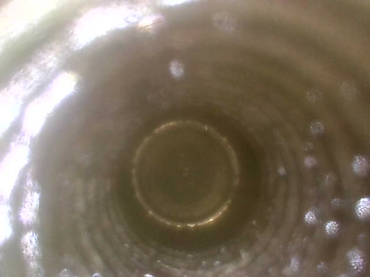

Bout had a heart attack. Went to put on odd side cylinder head. One of the bolts would not go in... I got to troubleshooting. Pulled out my bore scope. It was full of dirt and junk... Feeling a bit proud of myself for fixing it.
1. Sprayed carb cleaner in bolt holes.
2. Used a pipe brush to agitate dirt
3. cut notches in old headbolt. And threaded it in each hole.
4. Got a soda straw, attached it to shop vac, and sucked gabage out.
Took about an hour of fiddling around but got em super clean. Tightening rhe head bolts was a breeze :)
I used the sharpie method. No clue why I bout that dumb angle measure now haha... was way easier using shaprie.
