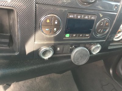

Today I accomplished a few things besides what I messed up this morning. First I tried using the sticky mount for my magnetic phone holder but it fell right off since I had no smooth flat surface for it. I looked at where I wanted my phone and the best place was right in front of a small useless pocket so I fabbed up a block of cedar that fit perfectly in the 2 1/2" deep hole with enough friction that I had to tap it in until it was about 1/16" inset so when I screwed the mount into the wood, it would be flush. Then I fabbed up a piece of black textured plastic that I cut out of one of the hood hinge covers that I'm throwing away. It came out solid but the cheap mount wasn't that solid so I might end up buying the good Nato mount that I have in my Denali. Looks great though and now I have something solid to mount to.

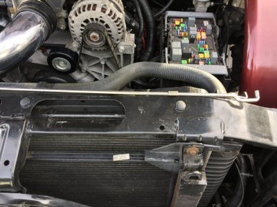

Then as I was doing that, USPS delivered my prop rod. It wasn't too bad to install but it did take a bit of figuring out how to make it work since it was for a Jeep. Came out allright. Now I don't have to grab a stick and lean it against the grill while I open the hood and then stick it in and hope I don't bump it while I'm under the hood. Don't say anything about chrome dammit. I know I know. It was hard enough to find one that I thought would work period.
