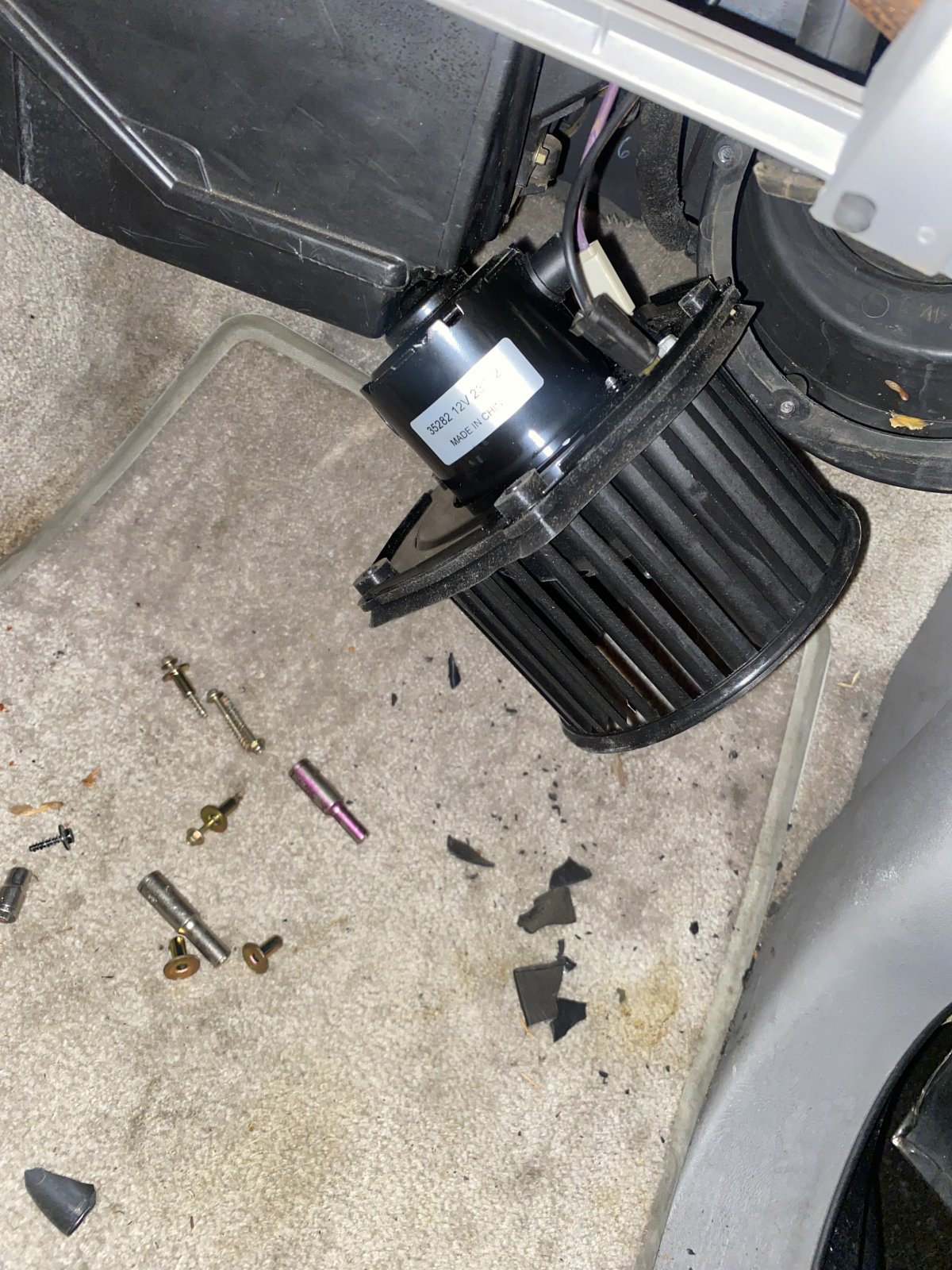

Blower motor stopped working yesterday after making noises for last 2-3 winters where it sounded like a leaf was stuck in the blades. No a/c due to evaporation leak so I don’t use fan much in summer. Think it’s time to take the dash out. I got various dash lights out or dim as well. I’m on vacation the coming week so I’ll see. Can it be replaced without pulling the dash. I’d like to wait until it’s warm

Fired up the parts cannon and Swapped in a new fan blower motor. Nothing lol :( busted up the knuckles a bit and pulled the resistor to swap out tomorrow smh. Thankfully I didn’t need to pull the dash. It got cold today after I started working.

New heat/ac control came in yesterday and I switched them out today and I have power to the blower again. 3rd shot from the cannon successful. Replacing the dash bezel I knocked the rear view mirror loose. I've always enjoyed replacing rearview mirrors, NOT. Also notice now that my side mirrors dont go up and down anymore so more shit to do smh.

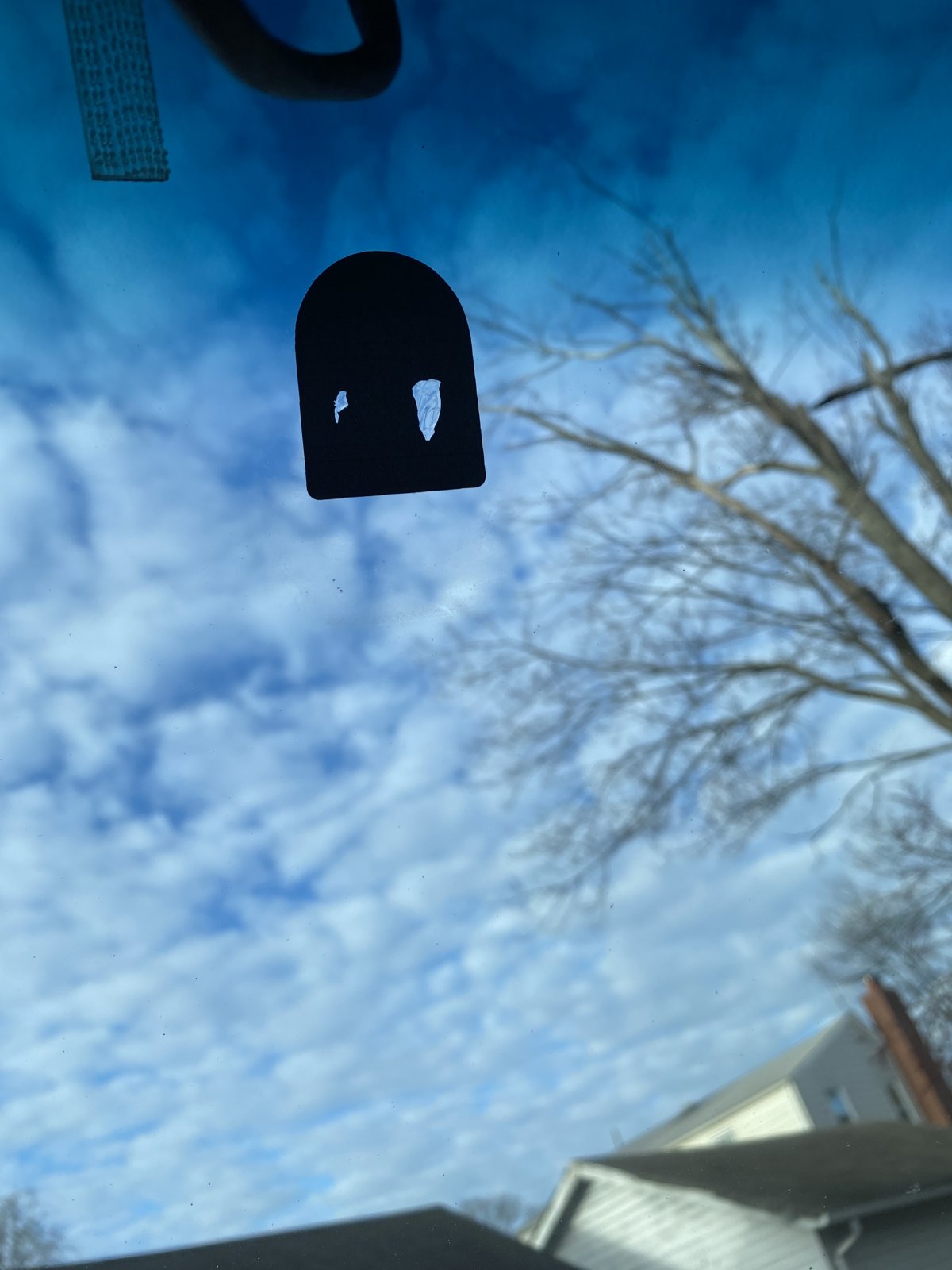

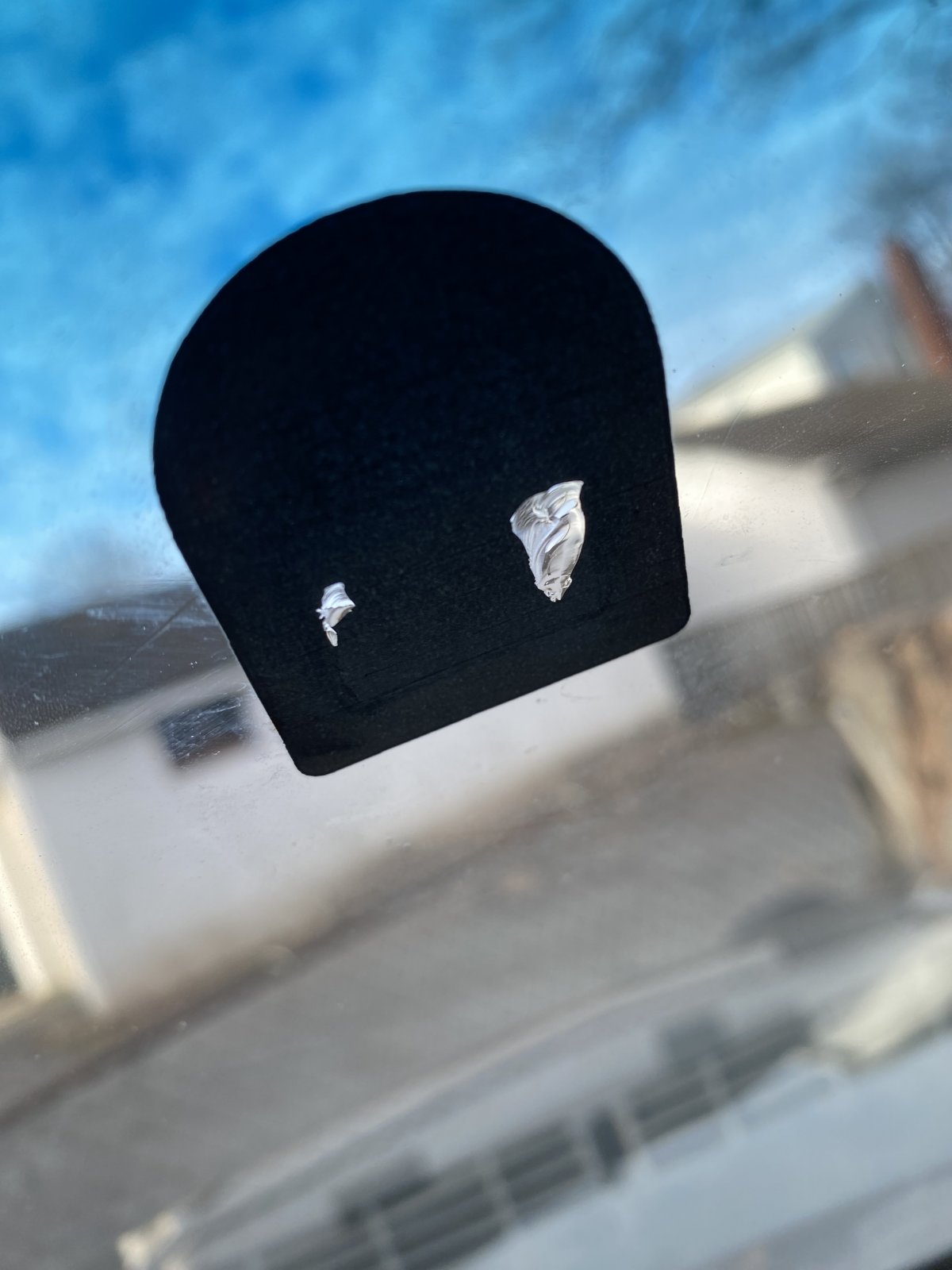

What is this piece called that the metal disc for rear view mirror is attached to? If it’s needed what’s it for? It’s like a really thin aluminum pad maybe. (Apologies if a dumb question)

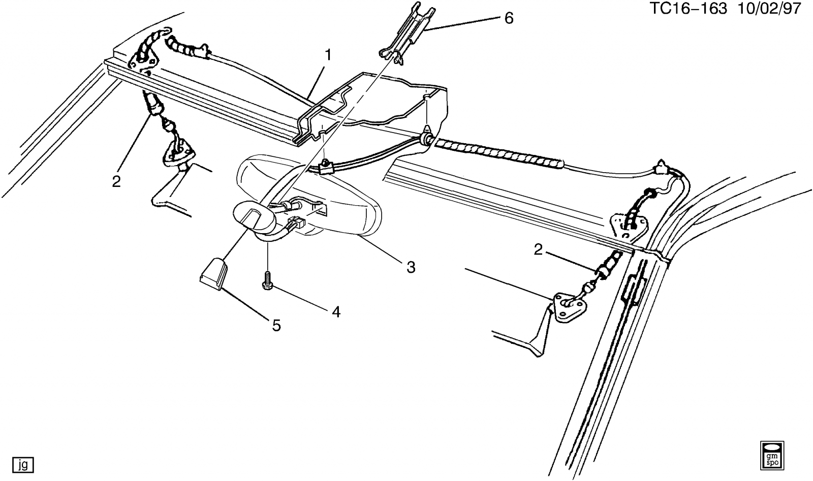

GM doesn’t show it as a part with the mirror, so it may be something that comes with the windshield to help the glue stick better.
Thanks. Google hasn’t been much help in giving the answer. None of the repair kits I’ve seen come with one either. I was thinking it was part of the mirrors readouts but it would have been on that chart. I’ve never known how the mirror reads the outside temperatures.

Are replacements available? Does it even need to be replaced
I honestly dont think its even necessary…it probably helps adhesion and maybe even keeps the windshield from cracking in that spot (ive done that a long time ago) but Ive also glued countless rearviews to the plain glass over the years. Just make sure surface is clean and dry and dont put the mirror on before glue is ready.
