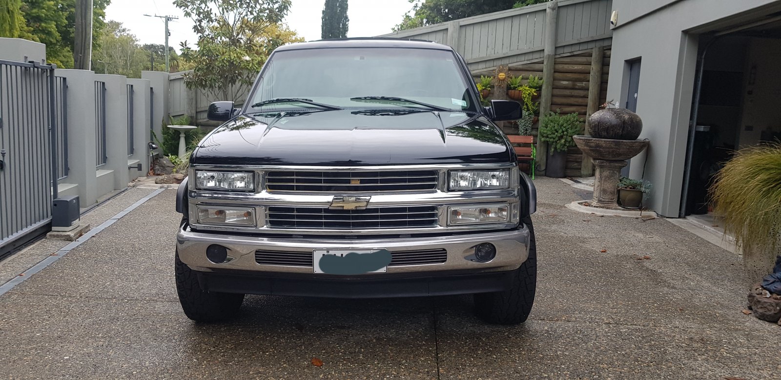

And so here we are.
This is how she was new to me.

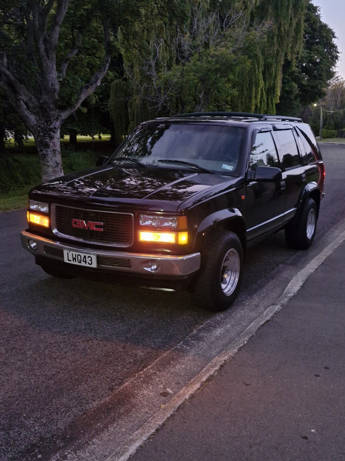

I have repaired and painted the new to me original grill,painted the bumpers black. New headlights,park lamps, added some led fog lights with park & indicate halo to update the lighting.
Liking this new look and thinking of the next jobs on the' to do" list

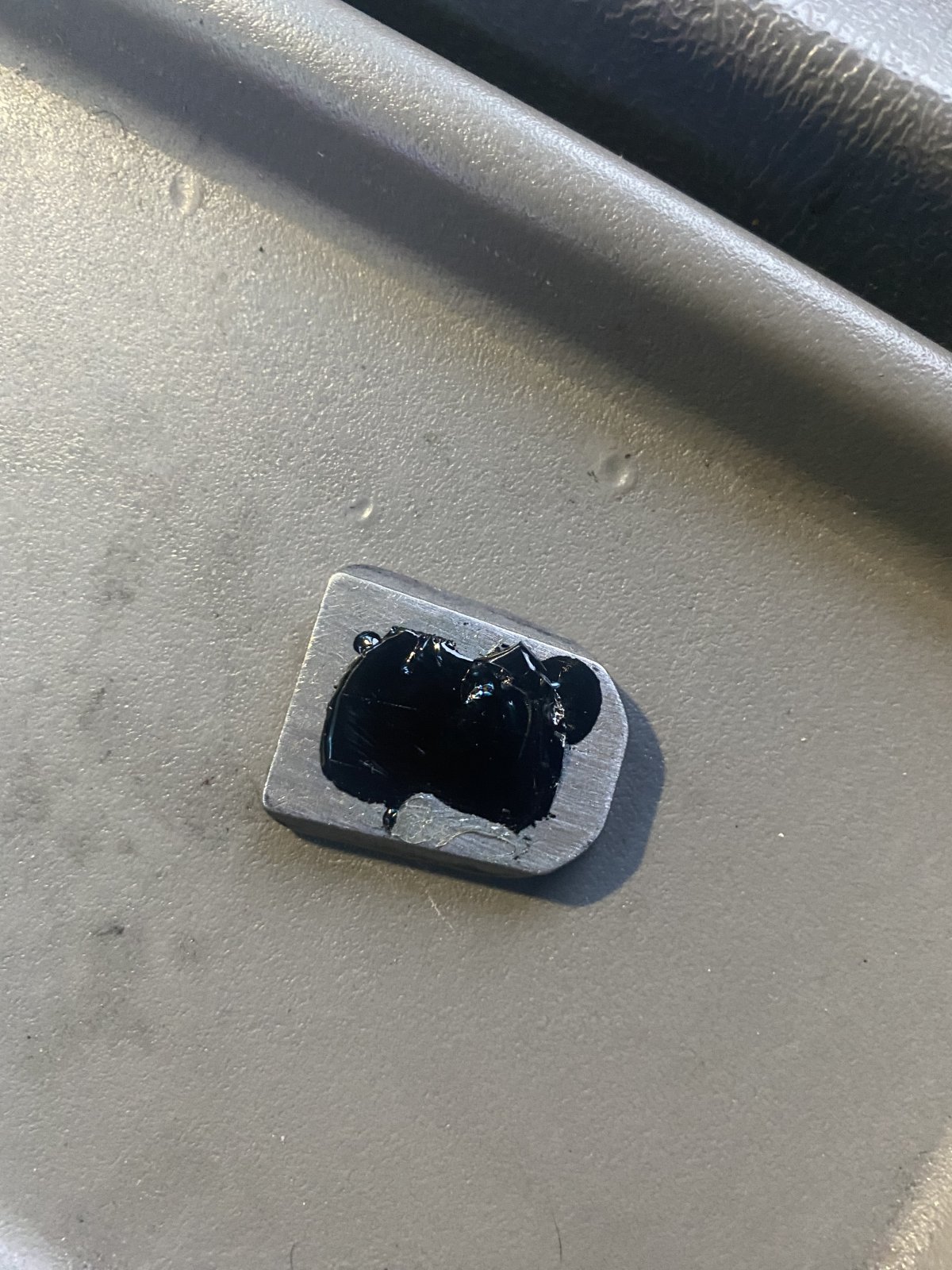

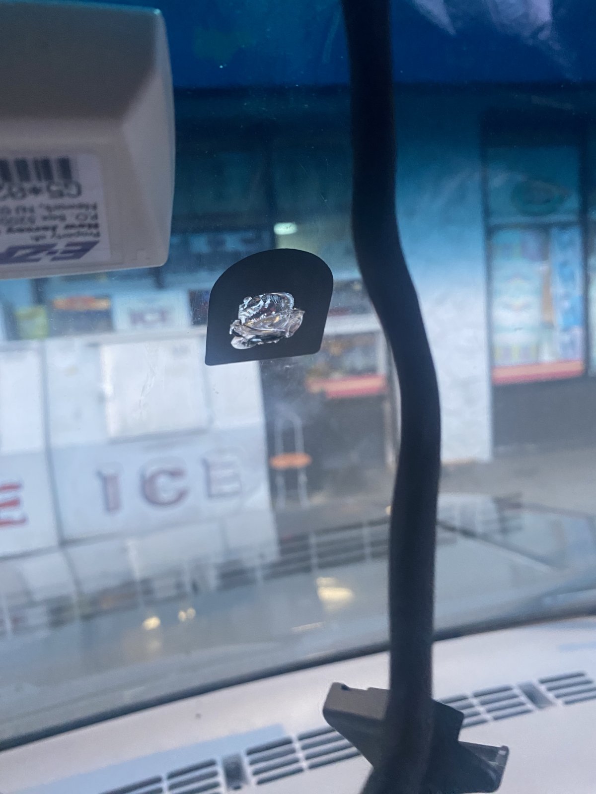

A couple months ago I repaired my rear view mirror knocked loose during heat/ac control replacement. Well, that was strong glue as it took a piece of the windshield off. Maybe I should have tried to remove the disc thing I was asking about. My track record of never repairing one correctly continues.
That's some good glue.

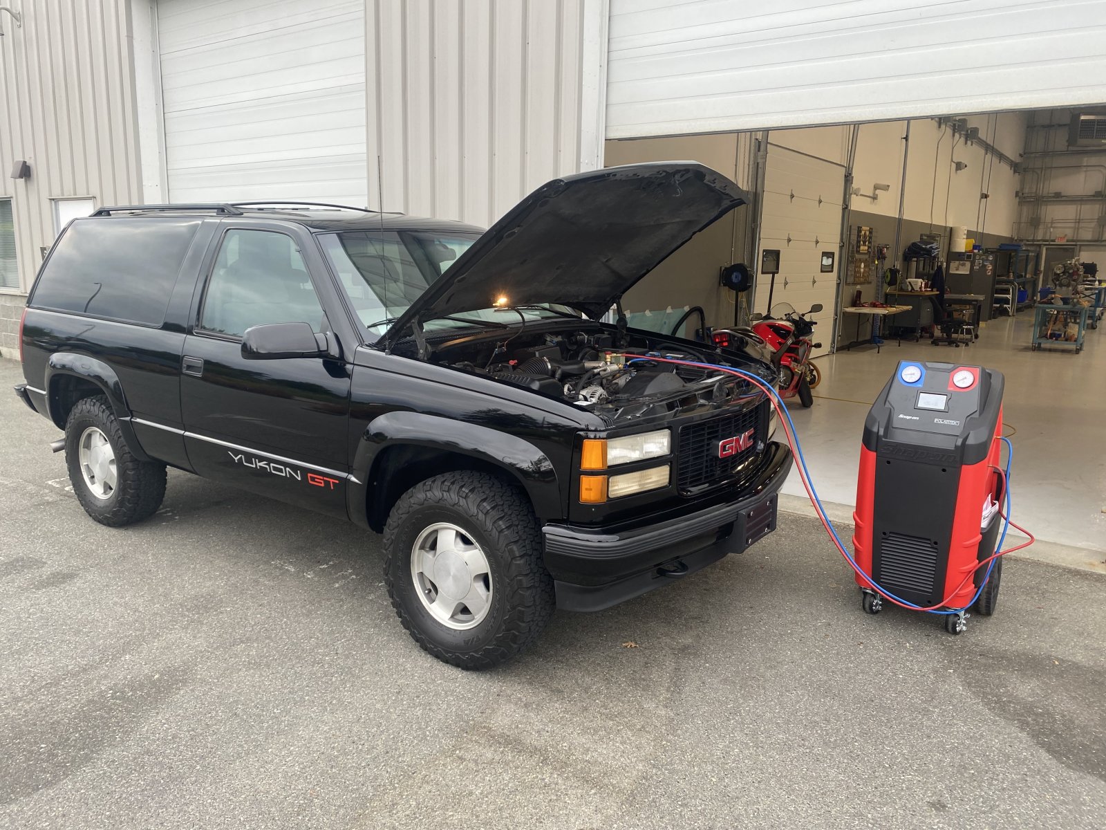

Air Conditioning service this morning with a Snap-on Polartek unit. I'm injecting some dye, as it seems I have a slow leak somewhere.
I need to do this as well. I’m getting my transmission cooler lines replaced tomorrow due to leaks. The one good thing about the various leaks this rig has had over the years is that the front end isn’t bad to work on as the various oils provided a pretty good under coating. Far less rust than the rear end :)
The one benefit to having oil leaks--in Jersey.
