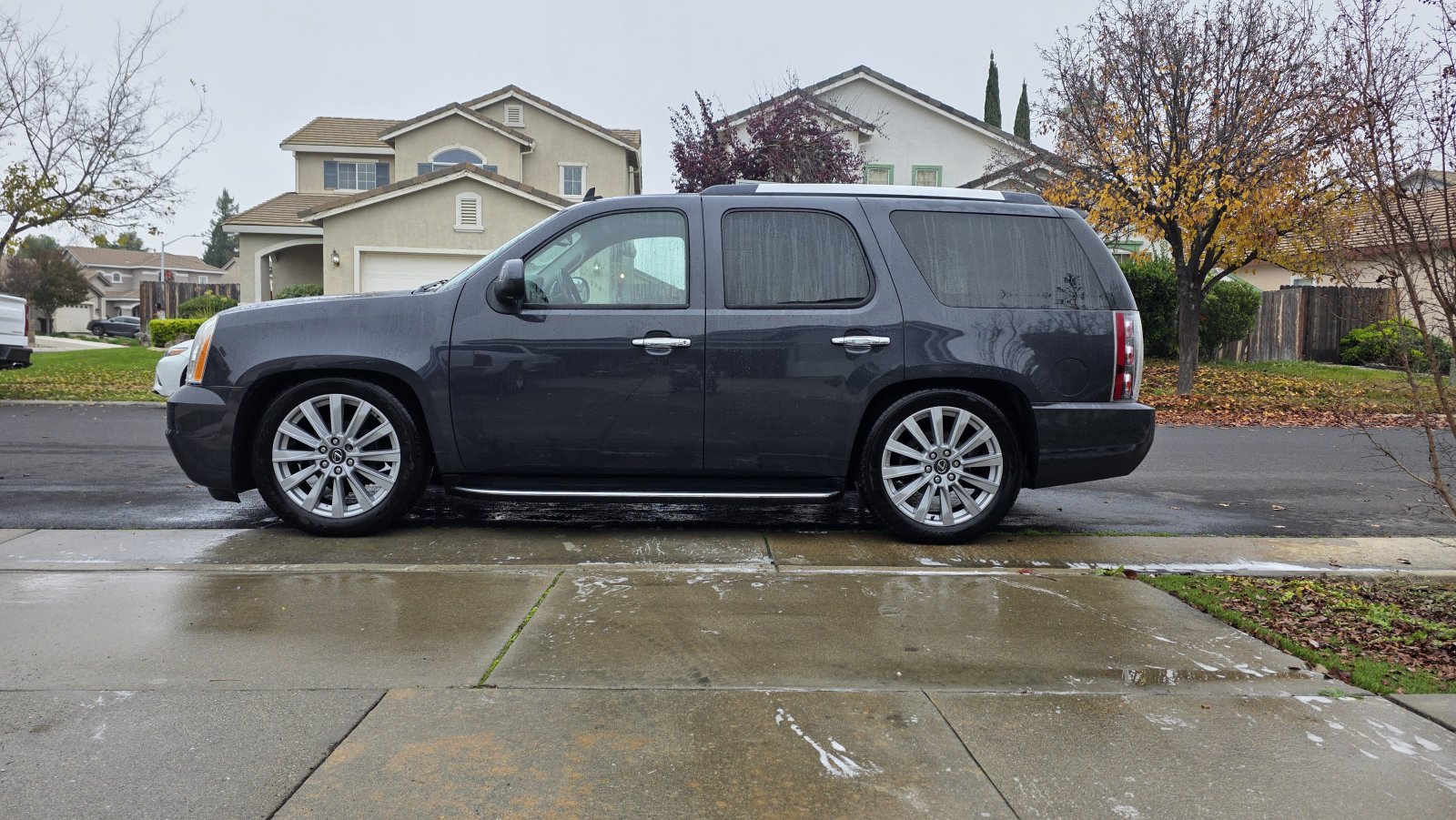

swapped out the z55 front coils for some, non air ride coils. Paid $98 including shipping on a pair of mevotech from rockauto. With the strut flip and these springs, sure does ride really good. Also got a bath.
Looks great. What did you have to do to get the rear-end to sit at that height?
