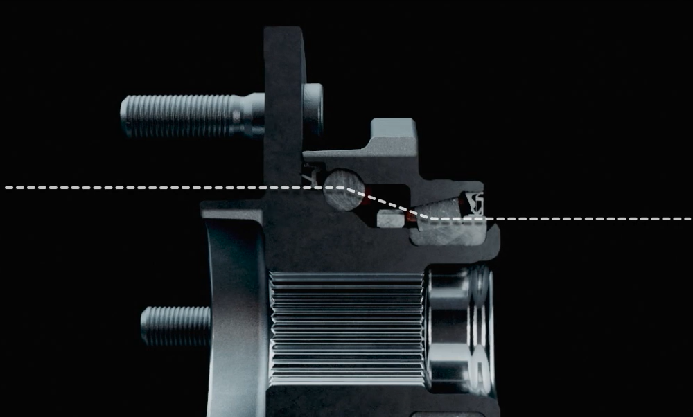

Started again in the morning when I could see, Good thing the bushing material softens the blow, or you could really damage the hole.
I hammered the bolt with a nut on the end, it didn't do much.. But I eventually got the arms in.
If ever I struggle with it again, I will make a spreader. I don't like hammering on it, and it takes a bit to move it.
Both lower front mounts were tight, possibly moog was a little narrower and the hole really deforms. Bolts still fit tight, thank god!
On another note, the SKF xtracker hubs lasted less than 20k miles before one developed some play. Was pretty minimal, and both hubs still relatively smooth.
Though they didn't feel as smooth as the Timken, even when they were new. Both were made in iljin korea.
Here's a cutaway of the SKF xtracker... Looks like the ball bearings can be loaded in a couple directions.. might cause some scrubbing or something..
I can't say I noticed any improvement using the SKF xtracker vs OEM, and they seemed to groan when cornering from the beginning. Not a fan.

5lb wouldn't do it!
My SKF Xtracker hubs lasted almost 5 years before starting to make noise. I had them replaced through Rock Auto just before the 5 yr warranty ran out.
If these somehow manage to make it past the 5yr warranty this time then I will probably go back to GM OEM hubs when they finally crap the bed.
