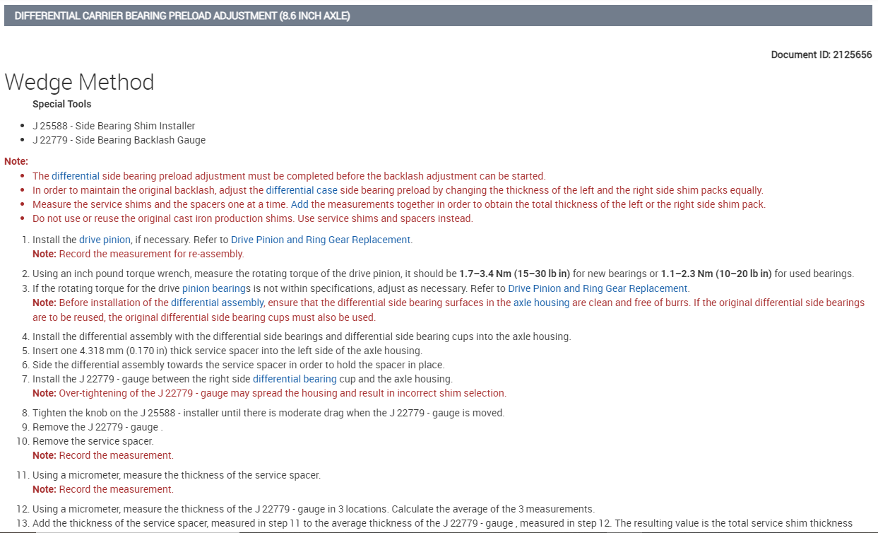

Rebuilding the rear diff, (8.6")
Seems that 14-19 inch pounds of pinion preload is what's documented, and there's a few articles showing 15-30.
I can't tell if that's a revised figure, or maybe pinion with carrier preload.
It's all back together and I had 18 inch pounds of pinion, and about 25-27 ish total of pinion and carrier with the 3.42 ratio so all should be in spec.
There are specs for a new preload and one for after seal replacement which is about 3-5 pound higher.
