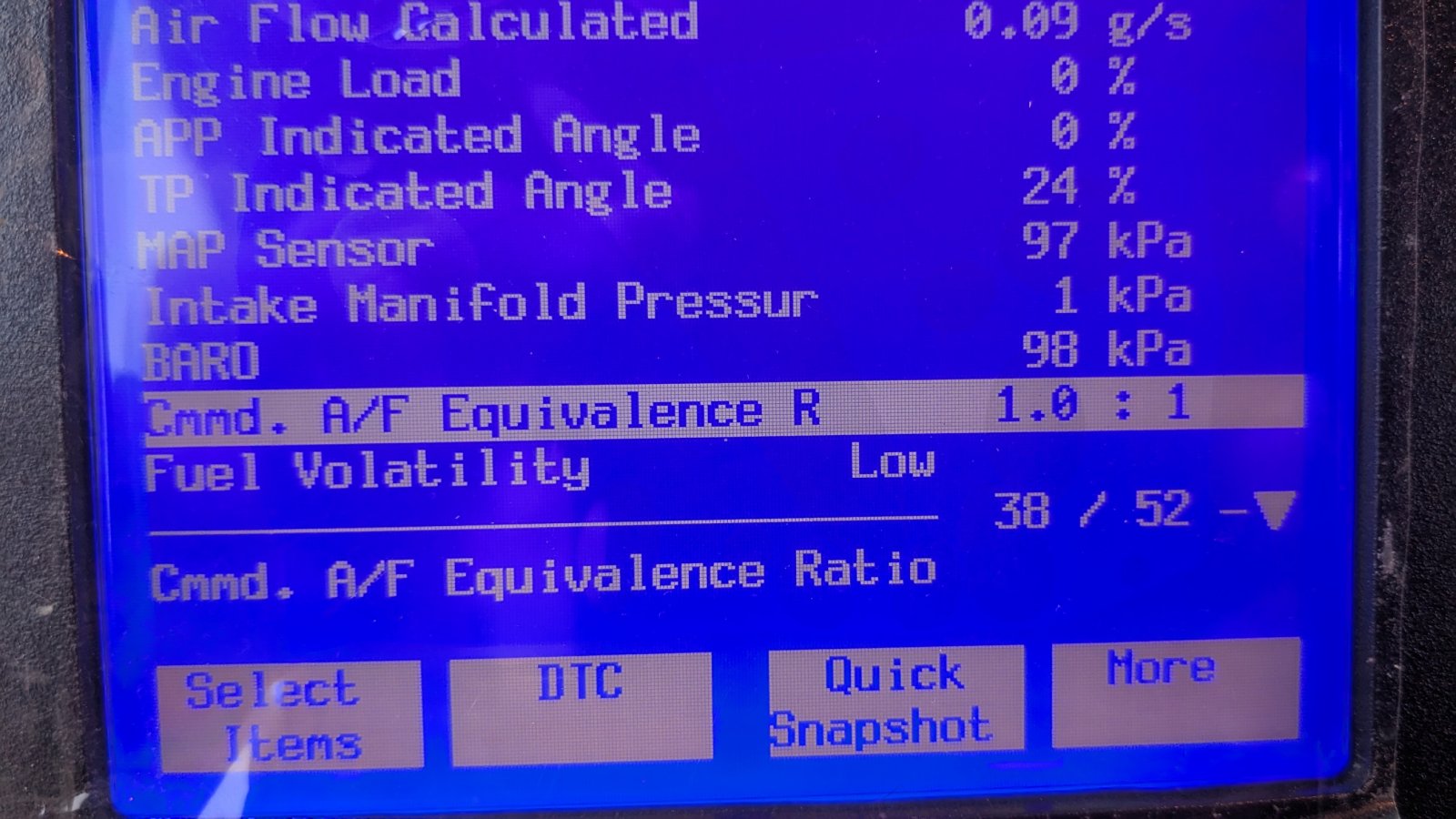

what's the fuel alcohol % named under fuel trims?
I have this, but I'm thinking that's not it.. that's just what it's currently targeting Lambda wise
if that's not it, I guess that settles that hybrids can't run E85. I don't see a E% anywhere
Do you have Engine Data 1 and Engine Data 2 and, if so, did you look there? It should show no matter if it's E85 compatible or not.
I'll have to look again, I'm honestly not sure. I looked under fuel trims and fuel pump related stuff. the normal engine parameters and some random stuff. I didn't see anything.
but I don't remember a data 1 and 2. might not have it named that. engine stuff is kinda a very small percentage compared to all other other stuff in there.
