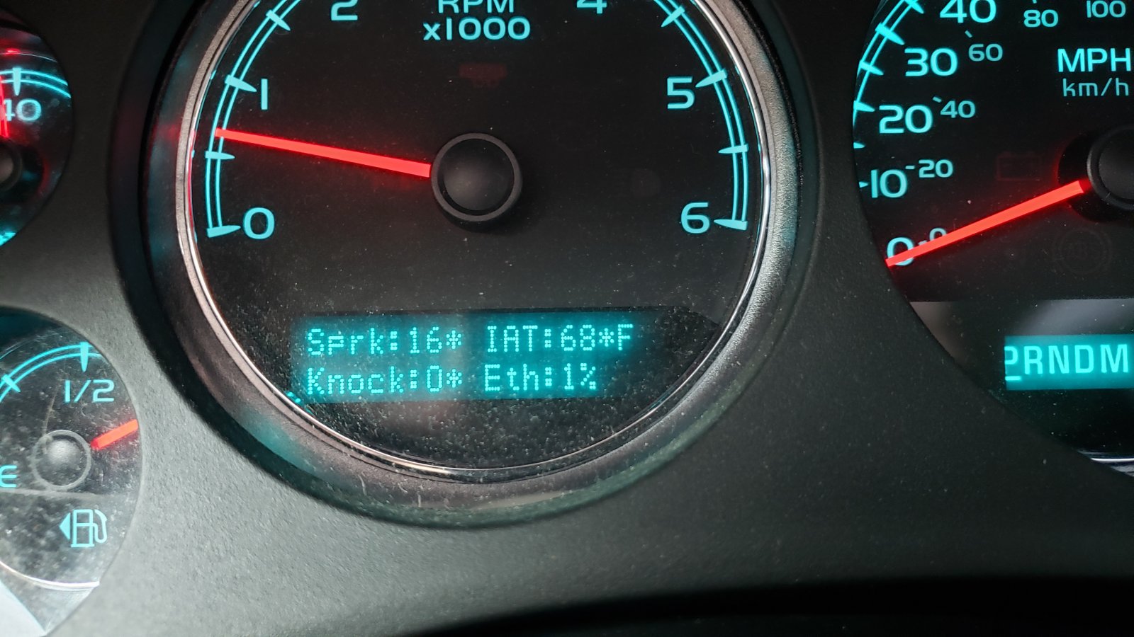

Got gas a couple days ago. Thought this was an interesting alcohol percentage.
It was previously 31% then I fueled up with about 25 gallons of 93 octane from ExxonMobil. Read about 15% right afterwards, then 12% and has finally settled on 1% for the last 2 days.
