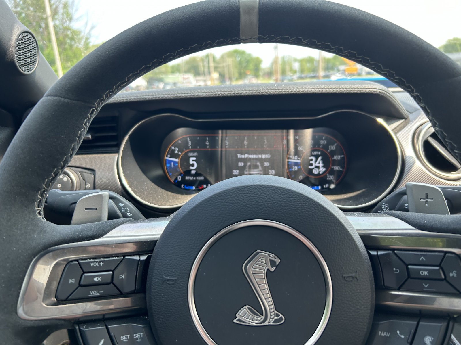

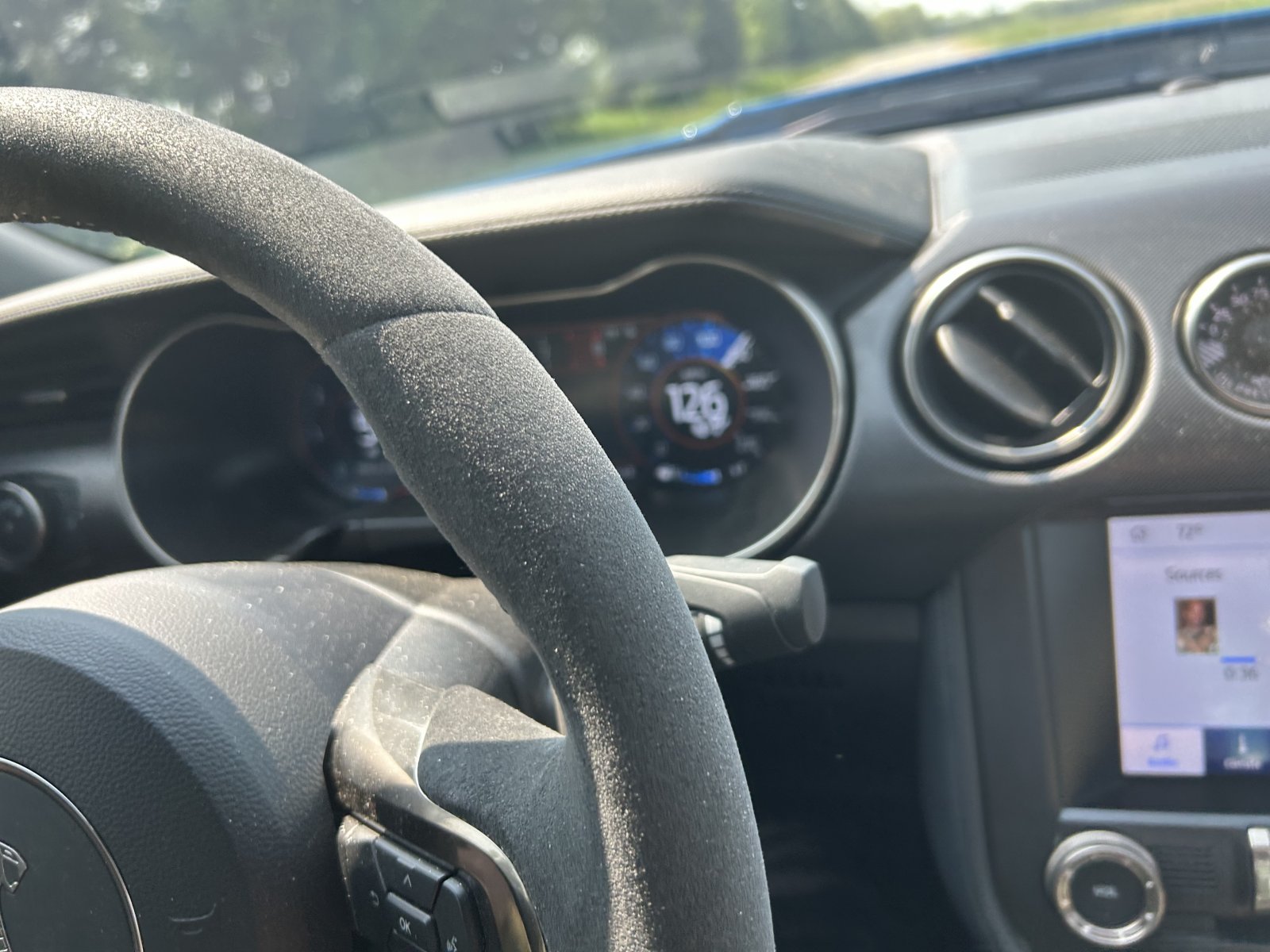

View attachment 400024View attachment 400025
We ran out of road in a 45mph zone yesterday, so I didn’t quite make it to 140.
I’m still happy with the fact I sold that car, but do not like the newer Denali's enough to buy one and have it sent to Hennessy. I’ll send my 2011 before I send a new one.
I just pretend mine is something fast by driving around in m3 :driver:
