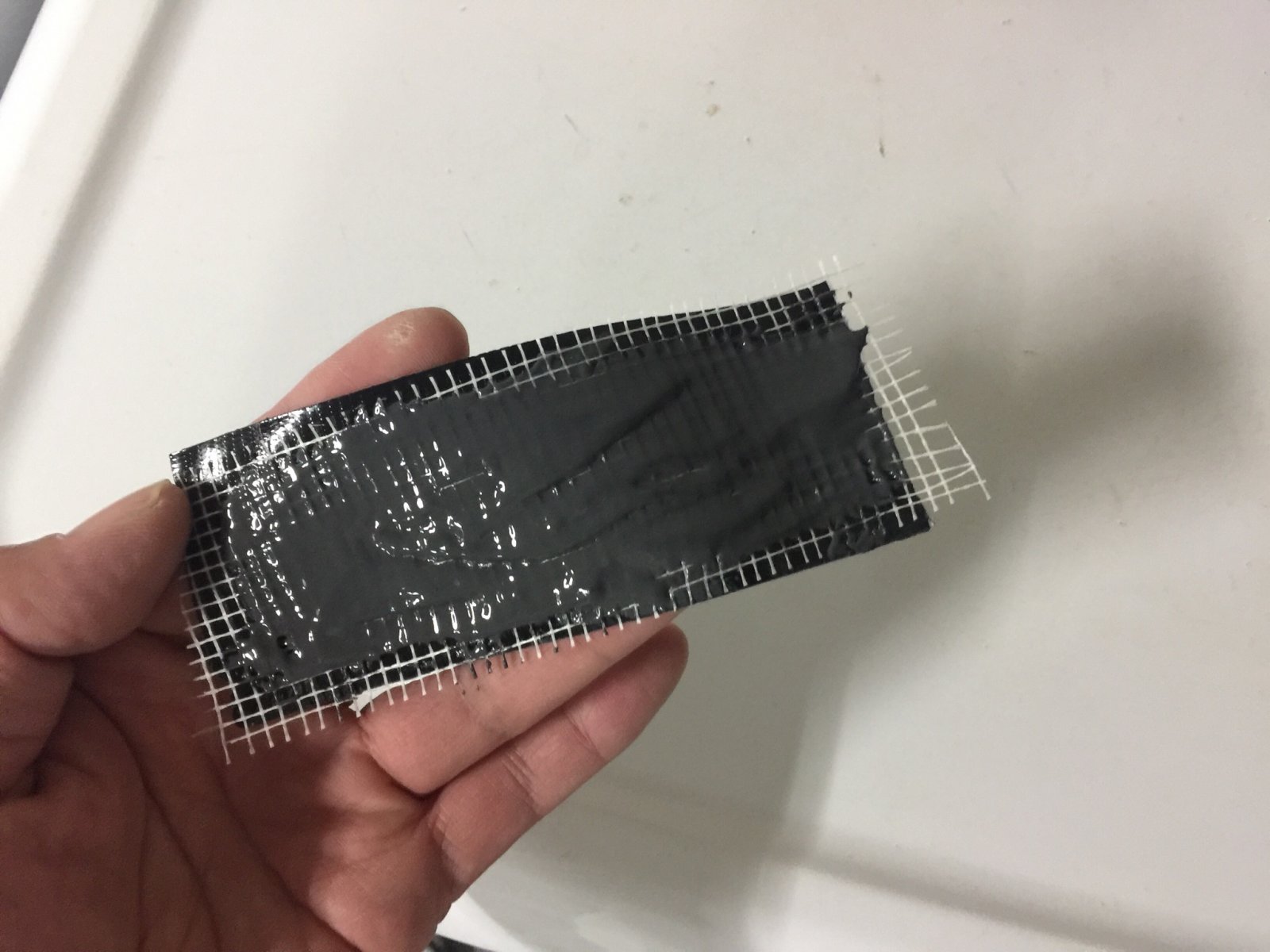

made some dashboard band-aids..
these went underneath of course (removed cluster and glovebox/airbag.. )
how long will it last? I didn't really prep the surface other than an alchohol wipe..
would change the dash, but after investing that kind of money i would want to fiberglass the bottom and vinyl wrap the top.
if the bandaids break, i see a dashcap in my future.. I know some of you hate them, but i dont like fuzzy things on the dash...
when I got mine is was cracked.. started checking it out and seems the center speaker has no support. it's just hanging off the plastic that gets hard and brittle. I made a quick support for it, popped the cracks back together so they didn't look so bad. it's not gotten any worse so far and looks good enough not to bother me everytime I drive it.
the thin plate near the base of the windshield just pops up with clips. a few are going to break off, but mix up some plastic weld for them and it pops right in after making a center support.
after seeing it, I'm convinced if gm would have supported that speaker the broken dash wouldn't be nearly as bad is it is. the plastic is crap, but all gm dash plastic is kinda crap and they don't break

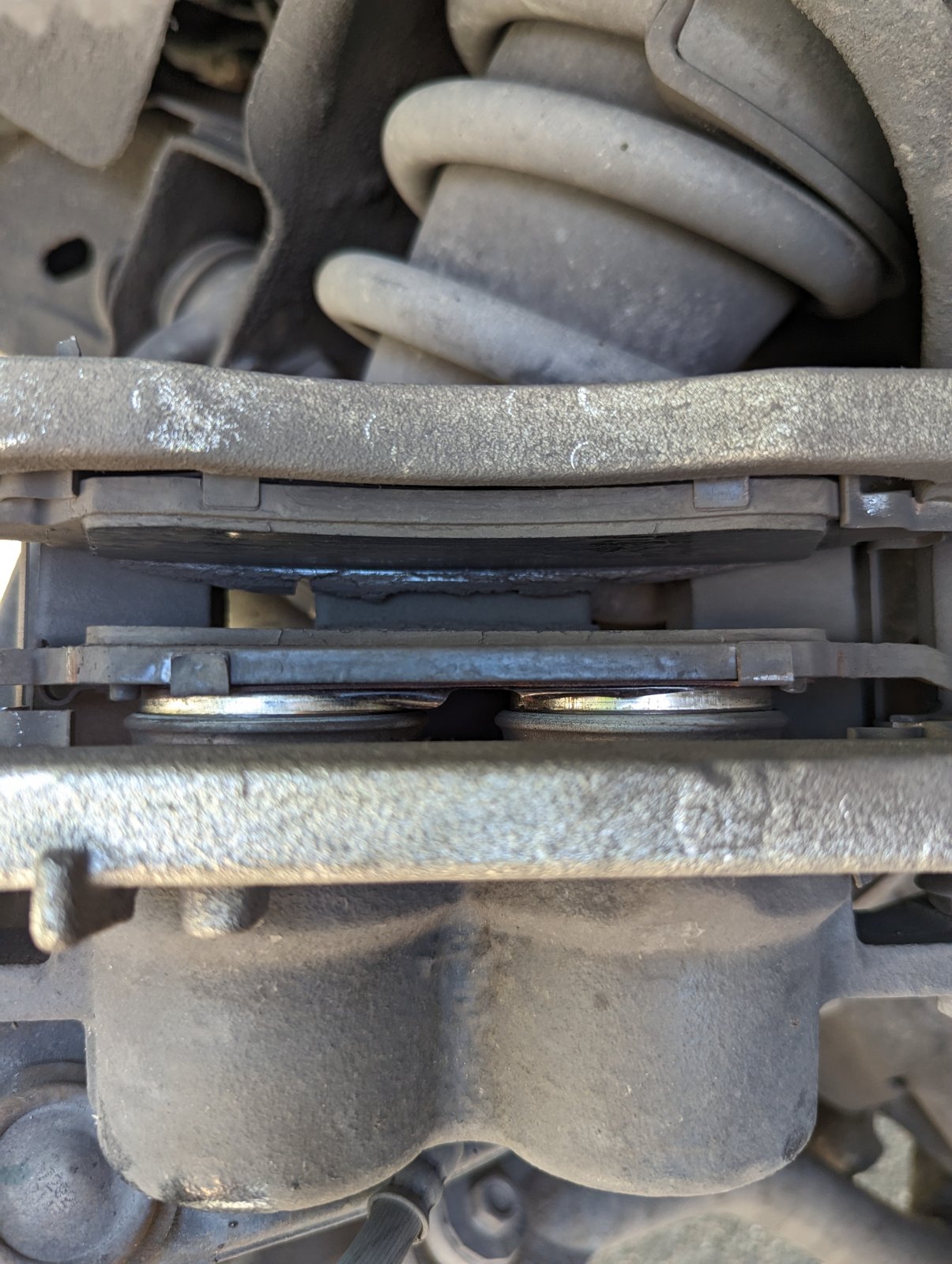

Well brakes are done but took a lot longer than it should have,, pad clips were no good and the bracket slider boots were bad and nobody had just the brackets in stock and I wasn't going to do it twice nor leave it all apart on the street so I ended up buying 2 new complete calipers for the brackets only so they ended up costing me $76 instead of $40 if I had ordered them.
