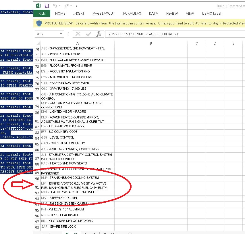

how do you know what engine you have? Ie: l94 l9h etc

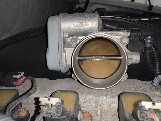

I know its not a Yukon/Tahoe... but I cleaned the TB on our 2006 Chev Trailblazer L6 4200. It had a bad idle would stumble etc.
Here is b4. pic
After cleaning on the vehicle w/ TB cleaner old toothbrush, leaning over etc. and using a rag.....
Smooth idle , no surge, etc.
Denali is next....View attachment 249829
I have also used a toothbrush-sized, soft brass wire brush to get into the tight edges and it also polishes the surface. ( Great for the aluminum outside for clean up)
