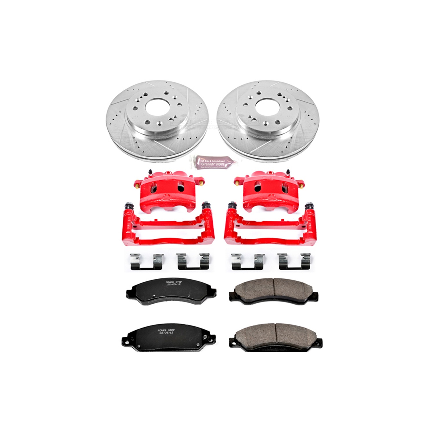

I just ordered my Powerstop front - rotors/red calipers & pads..... Also ordered my S.S. brake lines from Russell Performance.
