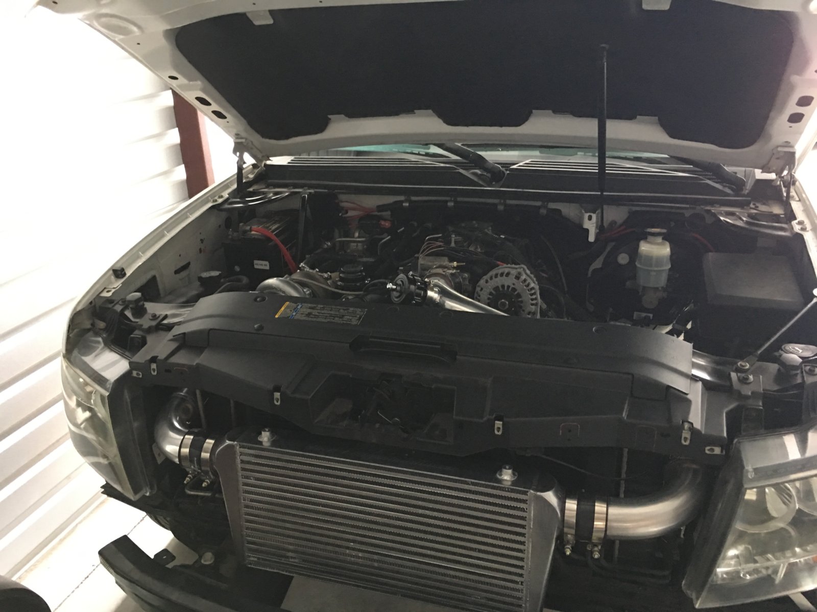

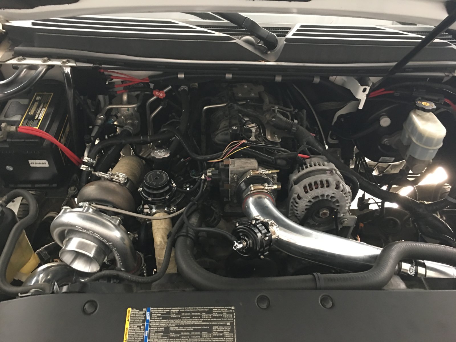

The kit comes with brackets for the intercooler which worked well. But to be honest if I were do it again I'd probably go with the trick performance kit for simplicity and what seems to be more quality parts in regards to V band clamps and T bolt clamps etc.

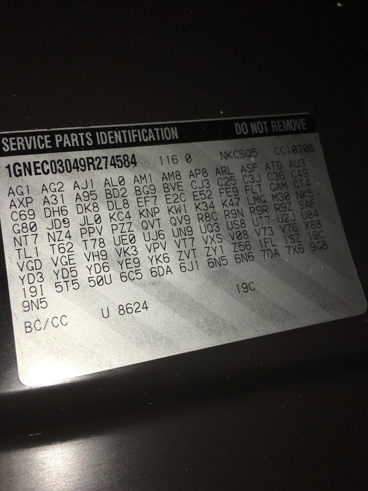

Someone went through a lot of work to backfit the 4-speed in there then, even the TCM had to be changed, should be a T43.
My truck does in fact have a 4L60e and it came from GM that way. M30 on the RPO codes.

Definitely an odd one! I know the 09 trucks split the year between the 4L60 and the 6L80 (I was a tech and a parts guy for GM) and every 09 Tahoe 5.3 had a 6L80, while the 4.8 2WD only had the 4L60. I bet it's a very early 09.

Odd and unexpected! Tenth digit in VIN is "9", designating it as a 2009. "LMG" is the 5.3 and, as you already know, M30 is the 4L60E. Oh well, with enough power and with a good shift tune, you won't miss the other gears so much.

GT4 = 3.73 gear, that's good!

I hope I don't sound like an imbecile but, How the heck do you guys read that?
Is there a book on how to read RPOs?

Haha you don't. I had no clue about what it even was until earlier and then google once again filled me in on some new useful tools. Just search RPO code for what ever you'd like to know about your Tahoe etc and in most cases something will surface.

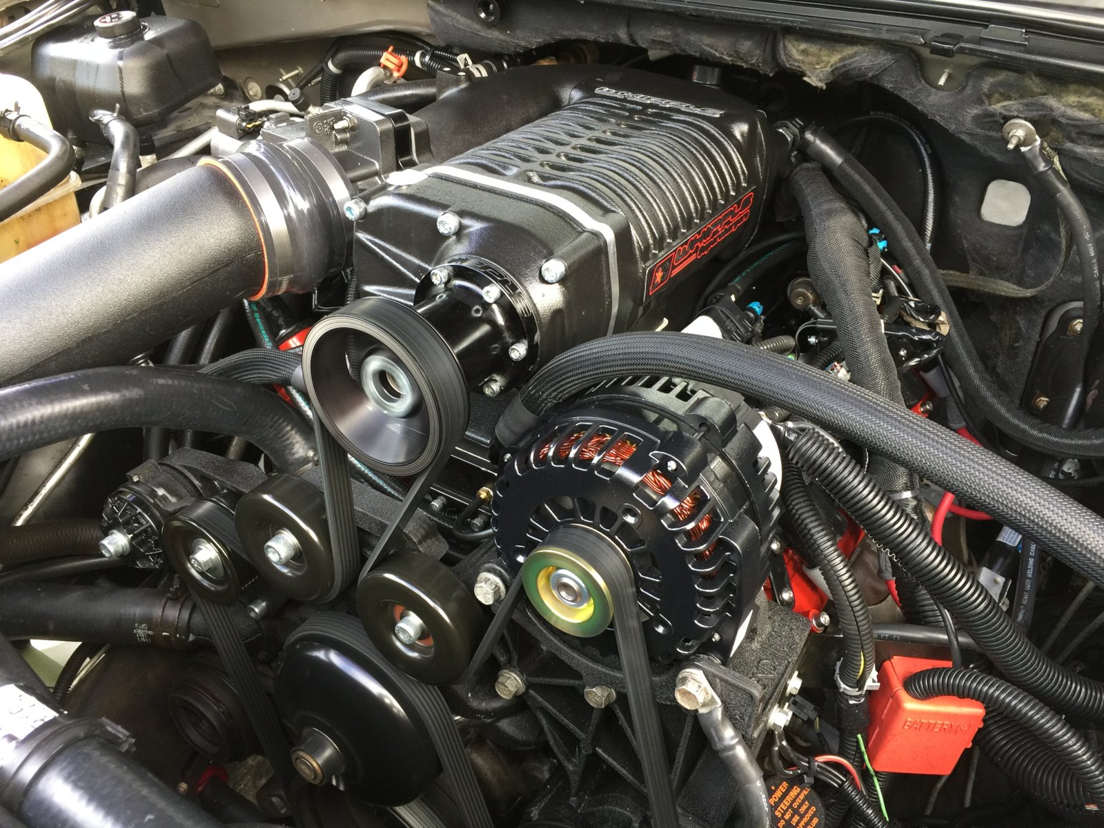

I went with a supercharger. I have a huge ass build thread for the whole truck but here's a link to the part where I started on the blower. I've done about everything I can do to the 02 except bag it. As far as the engine, I did a cam, roller rockers, dual valve springs, and headers as well as a Whipple. Like I said, addictive. At the bottom of my posts are links to both my builds; if you're on a phone you have to turn it sideways into portrait mode to see my sig and the links.

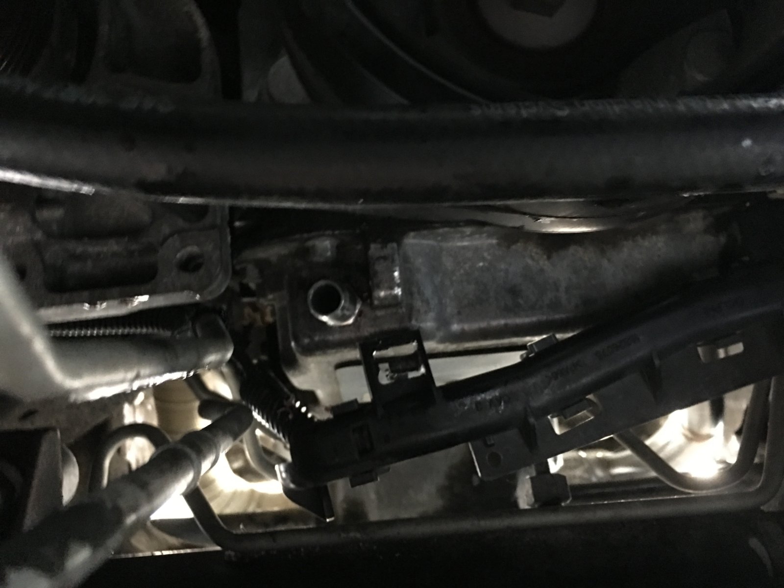

Well cut work short today and went and wrenched on the truck for a few. Got the vaccum lines run as well as my fitting in the pan for the return. Started extending my wires for my MAF sensor but I need some more materials. Just waiting on my fitting for my oil feed and it's just about complete aside from fluids.
