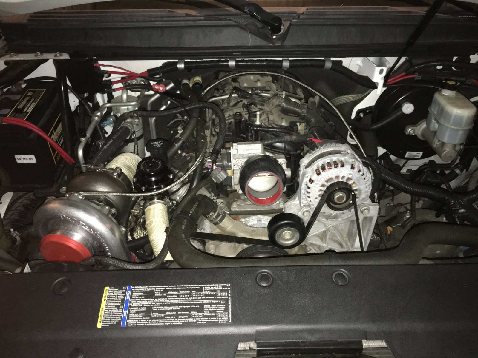

Went out for a few after work today got the turbo mounted up and ran the oil feed need to get 2 90 degree 5/8 fittings to relocate the heater hoses that go to the coolant neck. Gap and install my plugs and then I can install the downpipe and wastegate.

Where are you getting oil feed and return from for the turbo?
Also what happens to vacuum for brakes and such when it's under boost?

I will be getting my vaccum source from a currently capped port on the top of my intake manifold so my brakes will not be affected. Also in regards to the oil feed there is a small factory plate above the oil filter that I am going to remove and tap for the fitting supplies. And the return I will tap the front of the pan under the balancer.

looking good man, how's it all coming together?

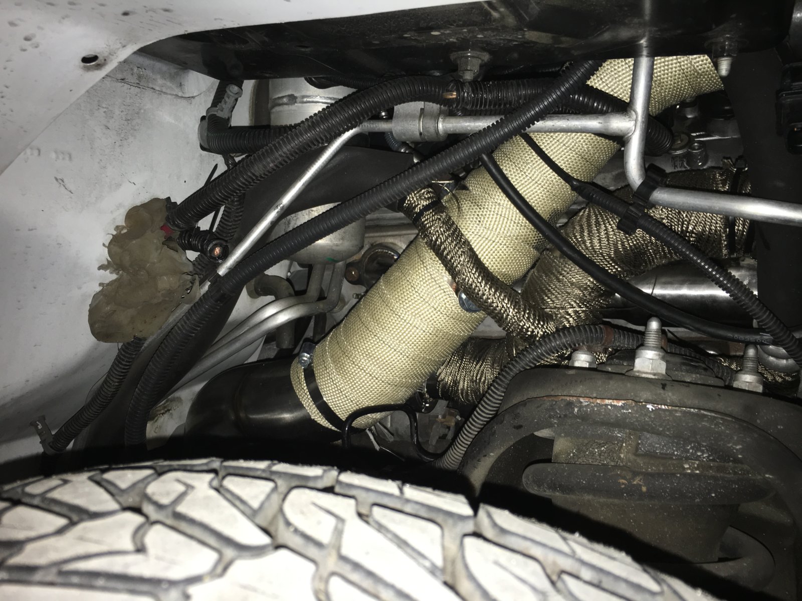

passenger side looks like its getting crowded - does your truck have rear ac/heat lines down that side also?

Thanks man. It's coming along slowly but surely. I do have the rear AC so there's plenty of lines to be wrapped in the area. I'm throwing the kit on stock for now, then hopefully a year or so I'll do the 4L80e swap followed by a cam and turn it up. I was hoping to have it running this weekend but I forgot I have to buy HP tuners as well so I guess I'll probably just have the full kit installed.

Man, you're rollin right along.
I'm just glad to finally see someone put a Turbo on a Hoe.
That engine bay shot looks killer with the snail sittin pretty.
It looks great and is coming along nicely.

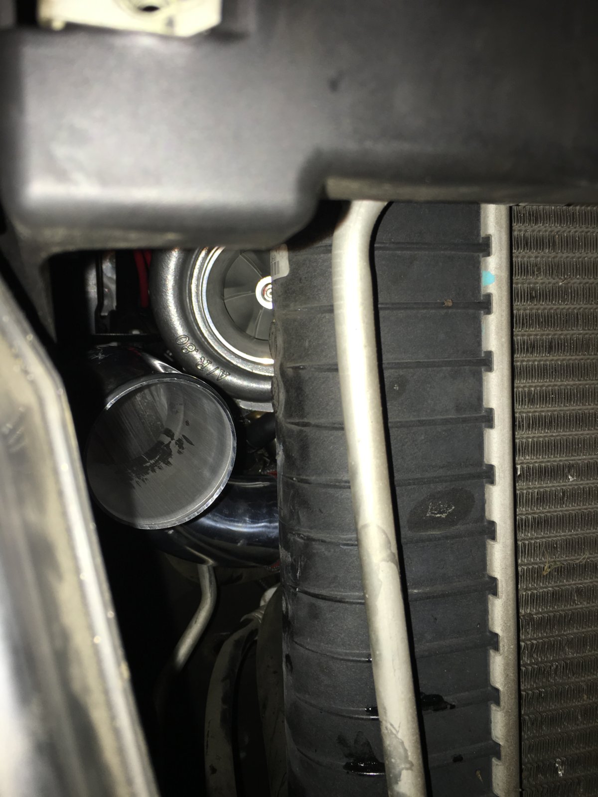

Ran into some more issues today. Kit is made for a Silverado not quite a Tahoe so the rear AC lines and stuff associated kind of take up a lot of the space for the downpipe, and it also hits the frame rail as well so I'm going to have to take it to a local shop and get it fabbed up. Also the factory plug wires will no longer work with the new manifold. This may be a direct bolt up kit for 07-13 Silverado but for us in the Tahoe world it requires some work.

Well that's disappointing. Is it advertised for the Tahoe?
