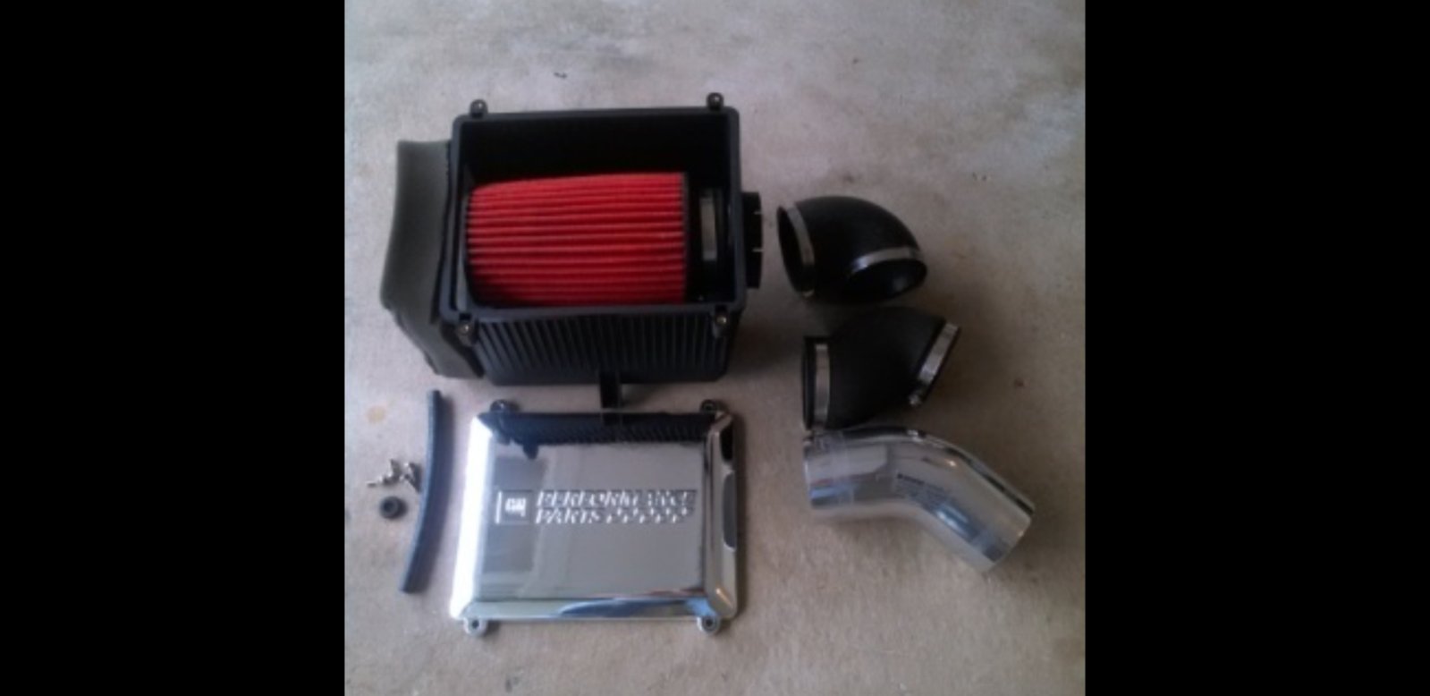

Got a great deal ($50) on a GM PERFORMANCE OEM COLD AIR INTAKE part #17800809. I want to put it on my 2013 Tahoe but my make isnt on the fit list. Has anyone here successfully made this kit work for newer models. I currently have a AIRRAID kit on but really like the Aluminum intake box on the oem kit. Only issues I've read so far is MAF sensor location issues, but I'm wondering if a combo of tubes from the oem kit and airraid kit would solve the maf sensor location potential issue. Anyone out there gone through this to lend a little experienced advice? I'll attach a stock photo of what the kit looks like

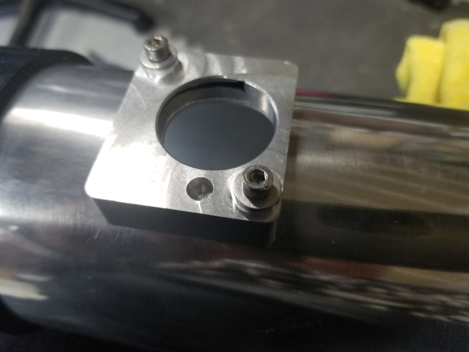

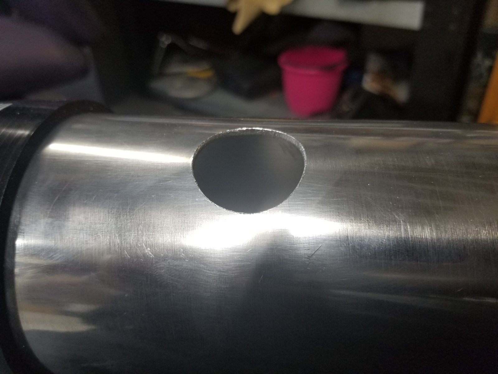

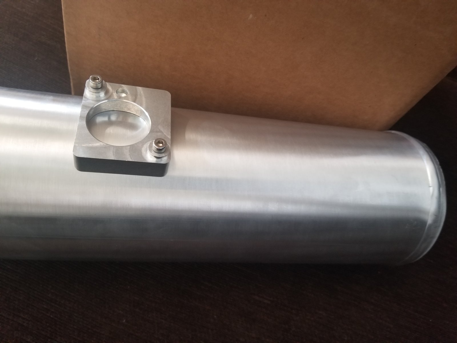

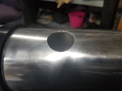

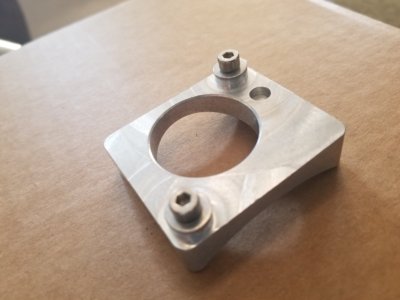

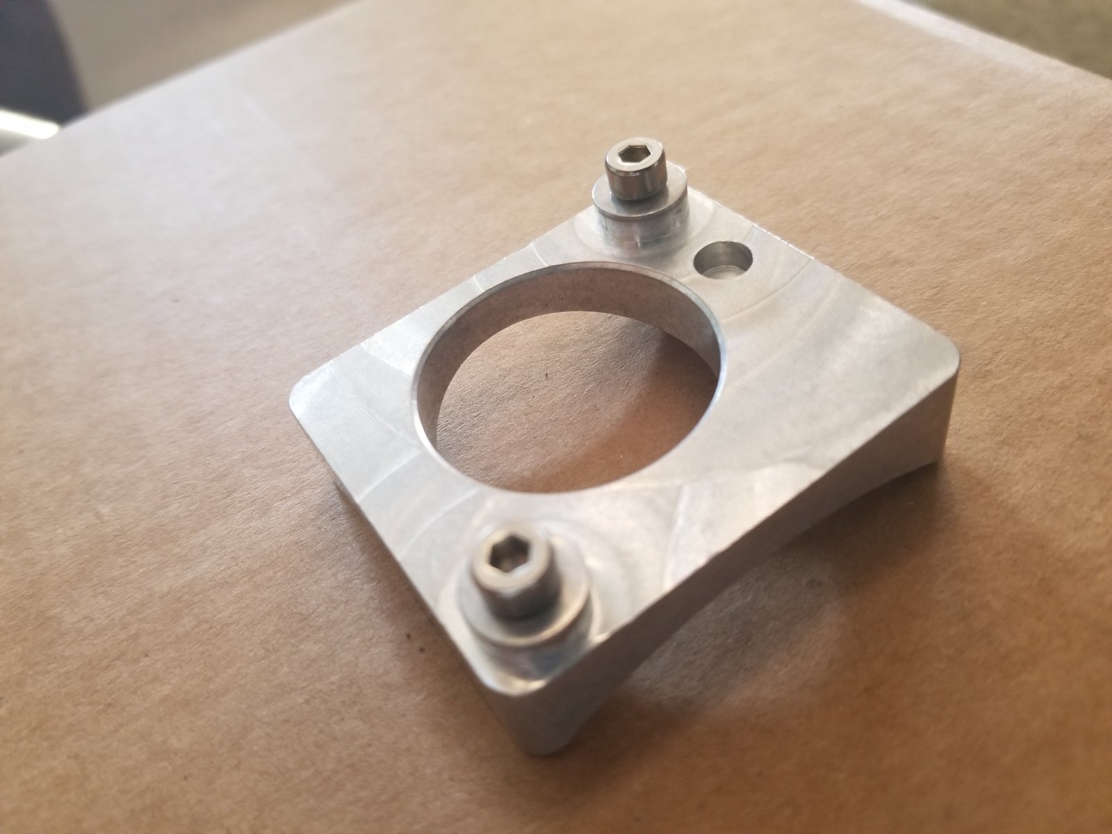

UPDATE: Here's a possible solution to my problem of getting a GM PERFORMANCE INTAKE that wasnt meant for a 2013 Tahoe 5.3.
The main problem was the MAF sensor mount location or lack there of. On the GM PERFORMANCE INTAKE I got, there wasnt a place to mount the MAF SENOR. Well easy enough right, cut off the plastic 3.5" diameter tube that sticks out from the stock intake box. I got it to mount and all the GM PERFORMANCE INTAKE parts fit good and was functional. WELL, after looking It, I didnt like it. I didnt like the GM PERFORMANCE INTAKE tubing was 4" diameter and the cut off plastic MAF being 3.5" that choked back the air flow and the plastic stood out from all the polished aluminum tubing. So after some research I found a 4" tube that's 10" inches long. And from Summit Racing they had a aluminum MAF MOUNT that is to be welded to the tube. Gonna have the tube polished to match the rest of the parts. I will post a update after I get the next stage done.

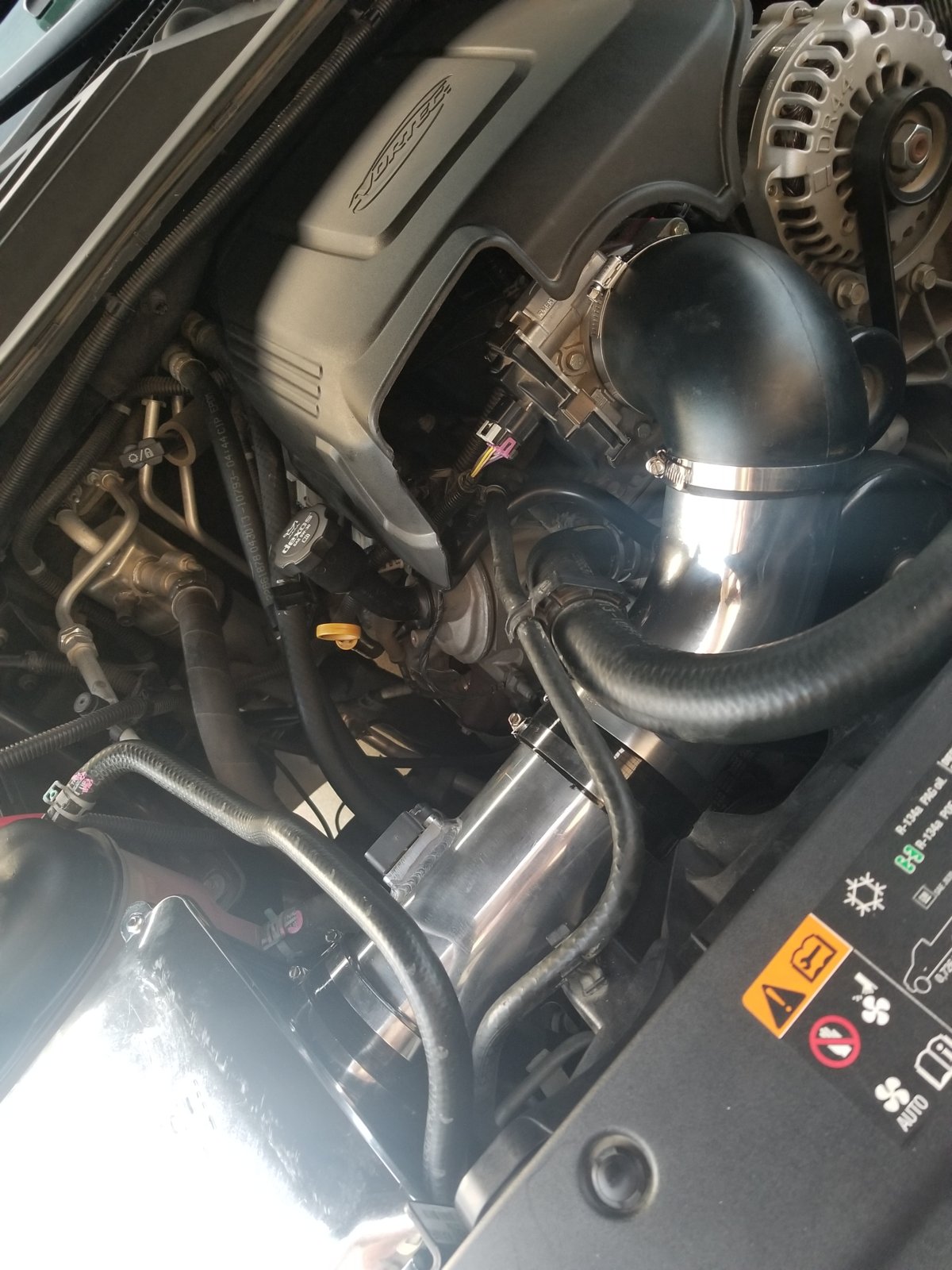

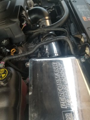

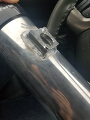

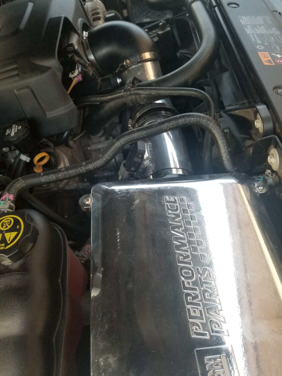

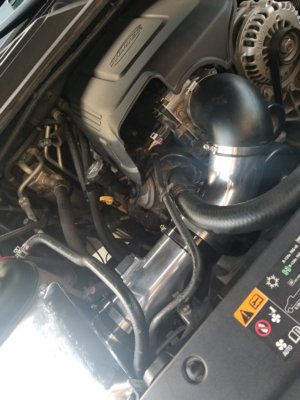

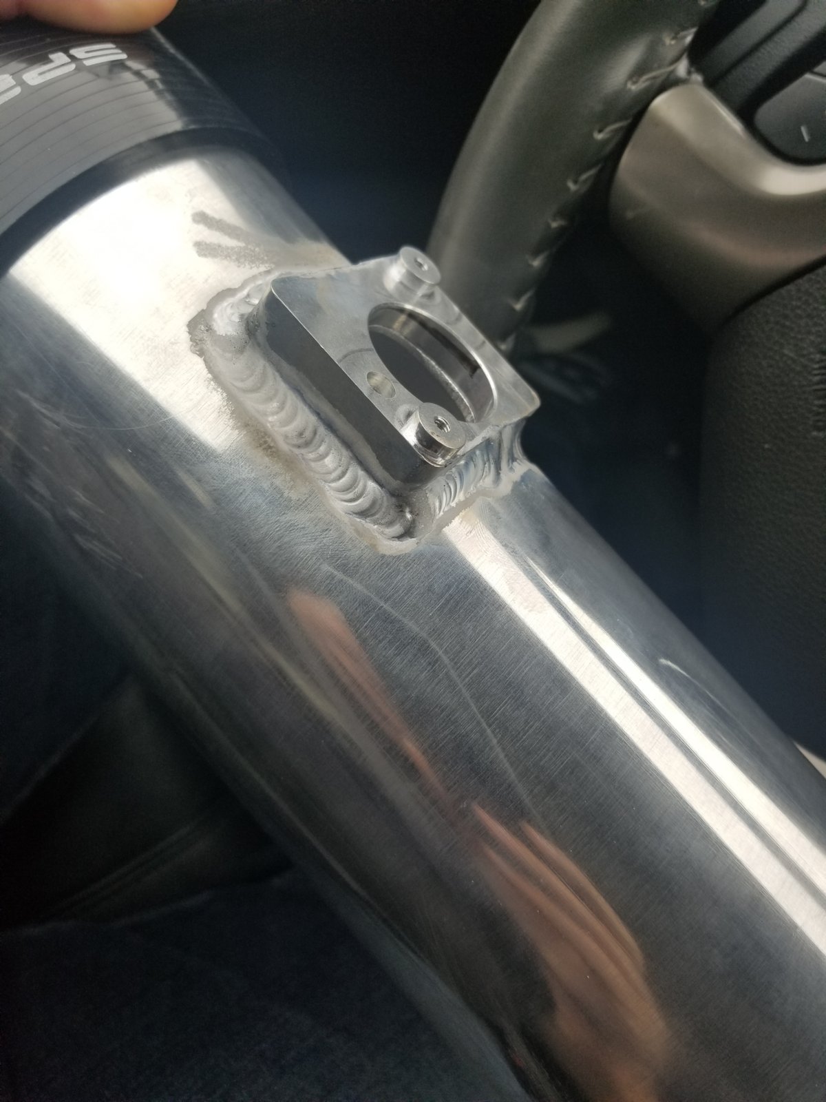

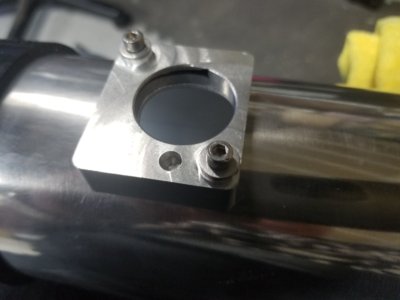

Update: I got the 4" tube and MAF sensor mount welded up and installed. I attached photos of the various steps. After all was installed there was a few noticable differences. First off I noticed a lower RpM at a warm engine idle. 2nd I noticed a quieter engine at idle. 3rd after test drive I noticed lower RPM to hold steady at driving 40 mph. When I got on the freeway I punched it and the high pitch engine rev was not there and quiter. I talked to my neighbor who is a professional mechanic and race engine enthusiast (race boats) He explained to me the quieter engine is due to the more air flow that is resulting in my engine not working as hard. Lower RPM due to more force air induction equals a more efficient working engine.

Looks cool, Great fabrication work and a solid leak free install "but" your engines ability to breath is directly controlled by the throttle plate, your only chance of noticing a performance gain is at wide open throttle and extremely high rpm. Why cant i just stfu? I swear that is a great install equal to oem in reliability/function. You have skills!
