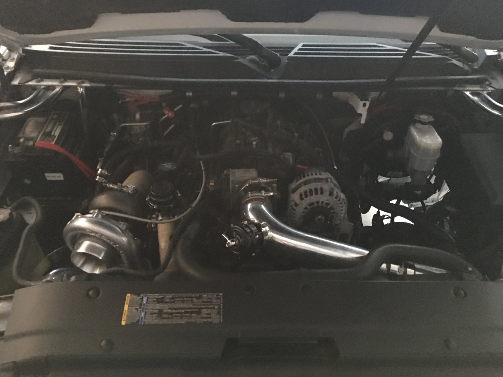

Went and tinkered for a few last night. Still need to install the BOV but the little O-ring didn't want to cooperate last night. also the t bolt clamps that come with this kit are a pain in the ass they are barely large enough so every single one is a fight for your life with only 2 hands available trying to squeeze as well as put the nut back on.

I can't get over how big that intercooler and those pipes are! Too bad there's no easy way to put the fans in front, freeing up space for the intercooler to be located in front of the engine how our Buick's were designed. The piping was much shorter. Anyhow, still exciting and looking forward to see her run, I'm sure you're more than ready to turn the key and light 'em up!

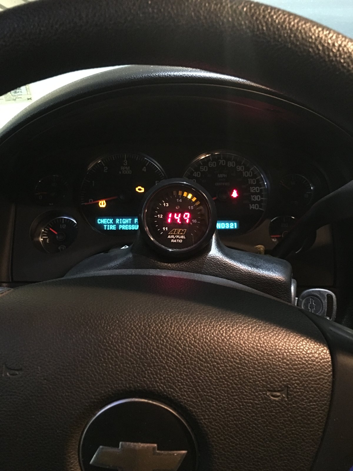

Got the oil pan tapped for the return today but I have to try and get a larger tap tomorrow so I can put threads in the hole drilled. Actually wasn't to bad at all and I'll snap some pics after I get the fitting in. Tomorrow I'm going to try and find an adapter locally so I can T off the oil pressure sending unit port for my oil feed, then it seems to be all small things. Run vaccum lines from wastegate and bov, check and top off fluids, and re-check all the clamps and fittings for tightness as well as wire up my Wideband. I'm just ready to hear it run again lol I'm over driving my daily.

Ran around looking for fittings and a tap today and came back empty handed so I'm just going to order what I need tonight. Did manage to wire up my wideband though so it wasn't a complete bust.

As I thought as well from little research I did before I purchased it. But upon looking underneath shortly after purchase I thought I saw something that said 60 on it but the next time I crawl under it I'll take a more detailed look based off the tell tale signs shown online. I Actually don't have much left on the truck I went today and installed the second piece to the downpipe as well as the blowoff valve and other miscellaneous things. I'm waiting on my tap to thread the pan as well as my T fitting for my oil feed which should be here this week, and then I just need to change the oil, extend the MAF sensor wires add coolant, run two vaccum lines and try and turn her over.
