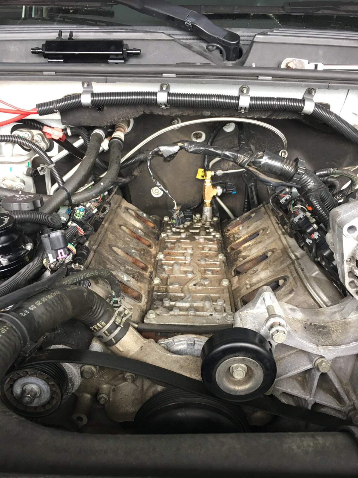

Just too keep you guys updated since y'all have kept me all going thru this process intake manifold and everything is off about to remove this T and try and get it sealed up for good.

Ran into another dilemma while putting it back together. When swapping out injectors noticed that the LSA injectors are quite a bit shorter than my factory ones and with the factory rail setup they aren't going to work so I'm currently trying to decide which route I'm going to go.
