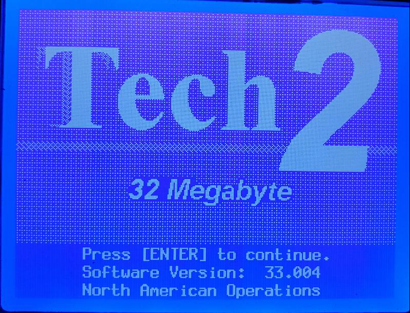

Power it up using ONLY the AC adapter. No data cables. It should go through the POST (Power On Self Test) and tell you if it passed. If it doesn't pass the POST, it's defective.
EDIT: should look like this after POST, and make sure your software version is this one:
I've been powering it up using the pwr port in my van while plugged into the obd. I did power it up in my house also--was the same both times. I guess it passes all the self tests because it goes to the next screen that you posted. It goes so fast I can't read if it all passes. I def have that version.
So what software version does that screen show? Not 33.004?

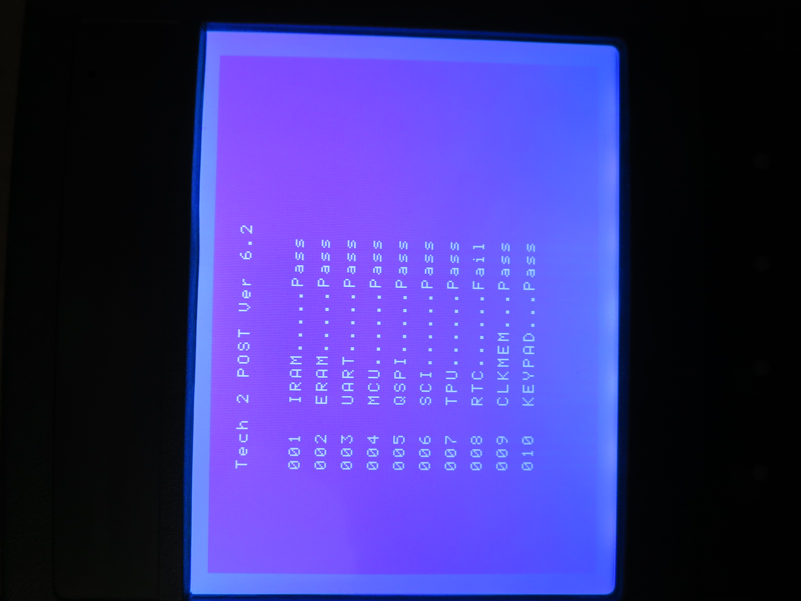

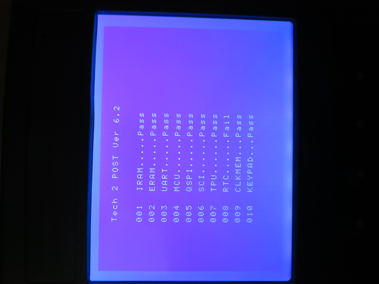

Just got another Tech2 delivered. This one passes the built in tests, but has a fail on the startup tests for RTC. Guessing that's real time clock but... Clock seems to be working and holds time when I unplug the power unlike the last one. When I go into the startup test results it shows RTC pass? I wouldn't be surprised if these are all returns they are selling. Both I received seem like they have been repackaged. Will try it in the truck in a bit.
About a year ago mine didn't pass the RTC test on start up and never has again, even after replacing the internal battery. Doesn't seem to have affected it though. My card also began acting up so I just bought another off Ebay AND a new main cord off of Amazon. Haven't had a chance to try it out on the old architecture yet but it's all working fine in my truck. The old card started reading on the splash screen as being only 10MB instead of 32. I took the door off so I could swap cards from slot to slot, the 800s like to read from the slot closest to the screen, the CANbus vehicles don't seem to care.
