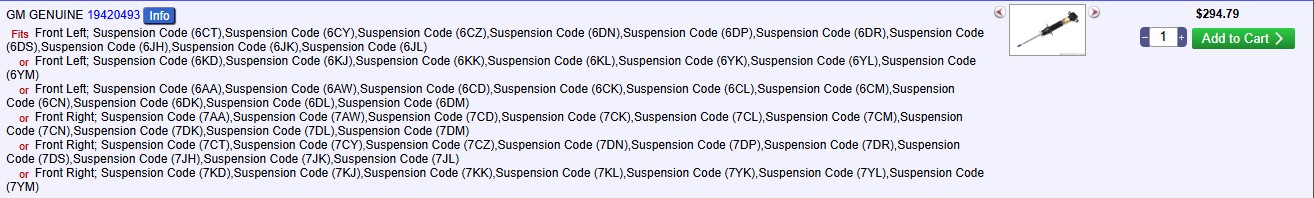

I'm not sure on your Arnott question, but I do not see any Z55 equivalent shocks offered by Arnott anymore. They do offer a shock that will fit, but it bypasses the Z55 electronic active shock feature with a resistor.
Check your RPO code sticker and look for 2 RPO codes that start with 6** and 7**, and post them here. If the codes are 6JK and 7JK, then your front shock part numbers are 19420493, and they are available at RockAuto.com at a cost of $294.79 each (You can get 5% off that price, using the RockAuto discount code that is posted in this Forum).
If your 6** and 7** codes are different, then we need to look further.

Ok thank you. Yea, thats the only Arnott I found as well. Older posts showed there being a z55 compatible/functioning one.
I put that part number in on rock auto and this is the only one it pulled up https://www.rockauto.com/en/moreinfo.php?pk=17916825&cc=1433415&pt=15174&jsn=663 . Nm, I went to assemblies not struts.
I found the one you were referring to here https://www.rockauto.com/en/moreinfo.php?pk=12522509&cc=1433415&pt=7556
Thank you for your assistance. Now i need to decide if I want to spend double the money and a lot more work. I've never experienced 'factory ride'... and I dont even know if my stuff would work lol.
