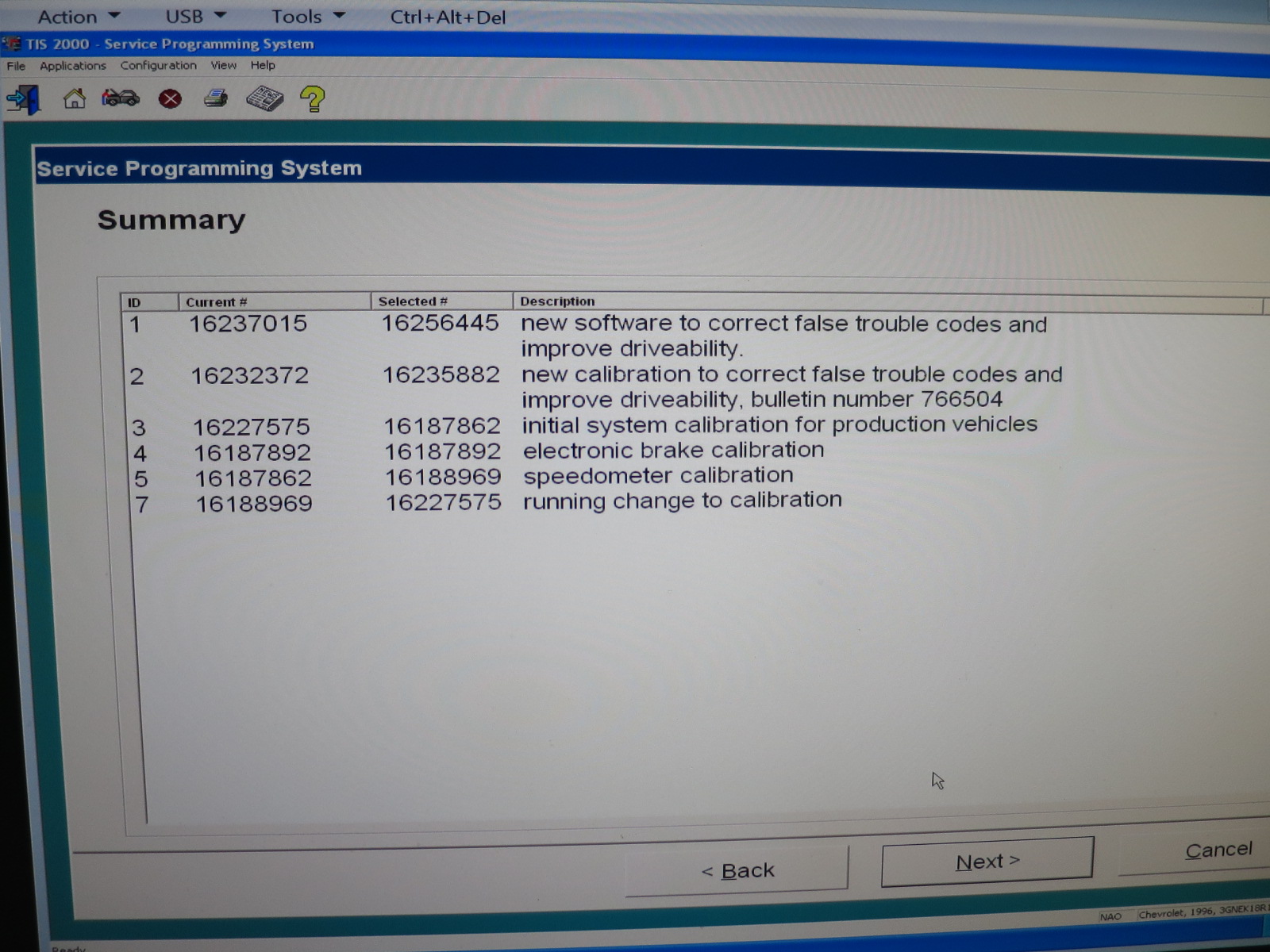

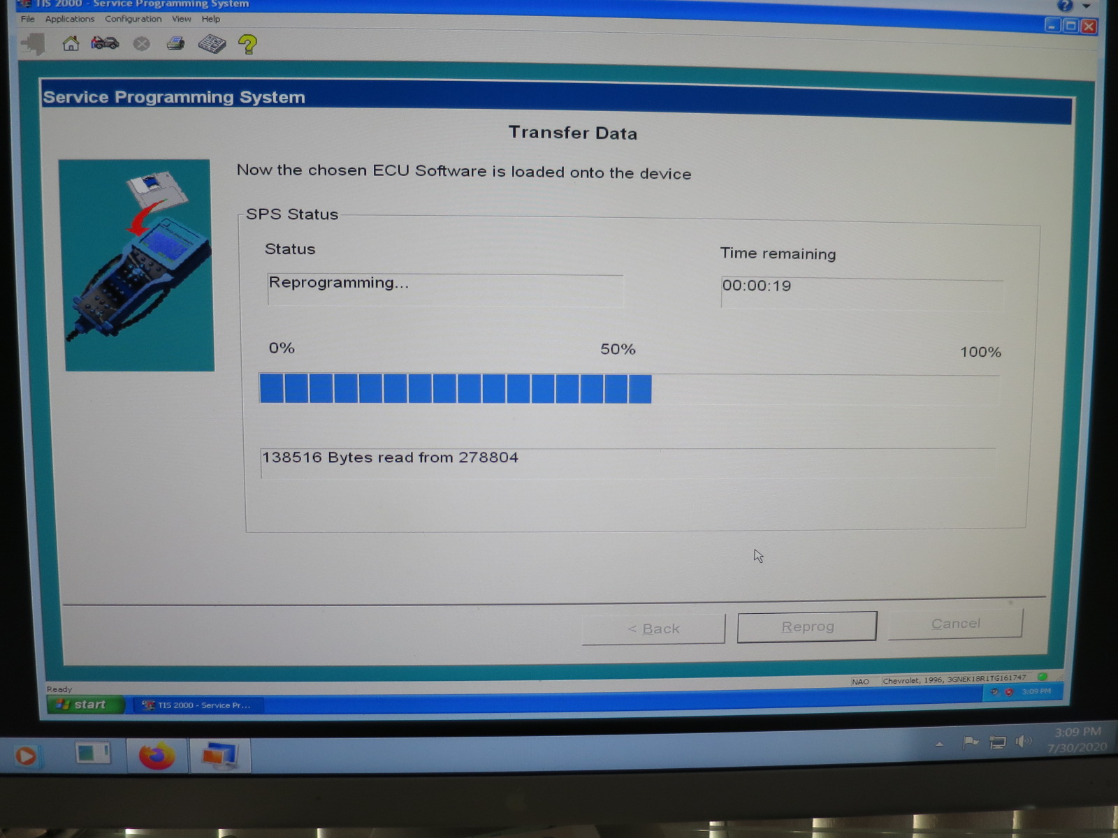

My USB serial adapter arrived today and so I've screwed around for a while to get it all to work.
Install the adapter driver in Win7.
Go to Win 7 Control Panel >Hardware and Sound / View Devices and Printers. Right click the device in the list and select Properties.
In the popup window click the Hardware Tab and Click Properties again.
In the next popup window click Change Settings.
In the next popup window click on the Port Settings tab and then click Advanced.
In this window you can change the COM port.
Mine installed as COM3 and I had to change it back to COM2 as that's what I chose when I installed the TIS2000 software same as the video.
Now when you open XP Mode click on USB at the top of the window and select the serial adapter to be able to use it in XP.
I did also install the driver in XP Mode while I was trying to get it all worked out but I don't think that was necessary.
My truck has quite a few updates to be installed.

Just updated my previous post to include setting up the USB - Serial adapter.
All working now.
Not sure if it's my imagination but I swear it was idling more quietly when I just pulled in after a 20 min test drive. May have improved power on kickdown, hard to say.
