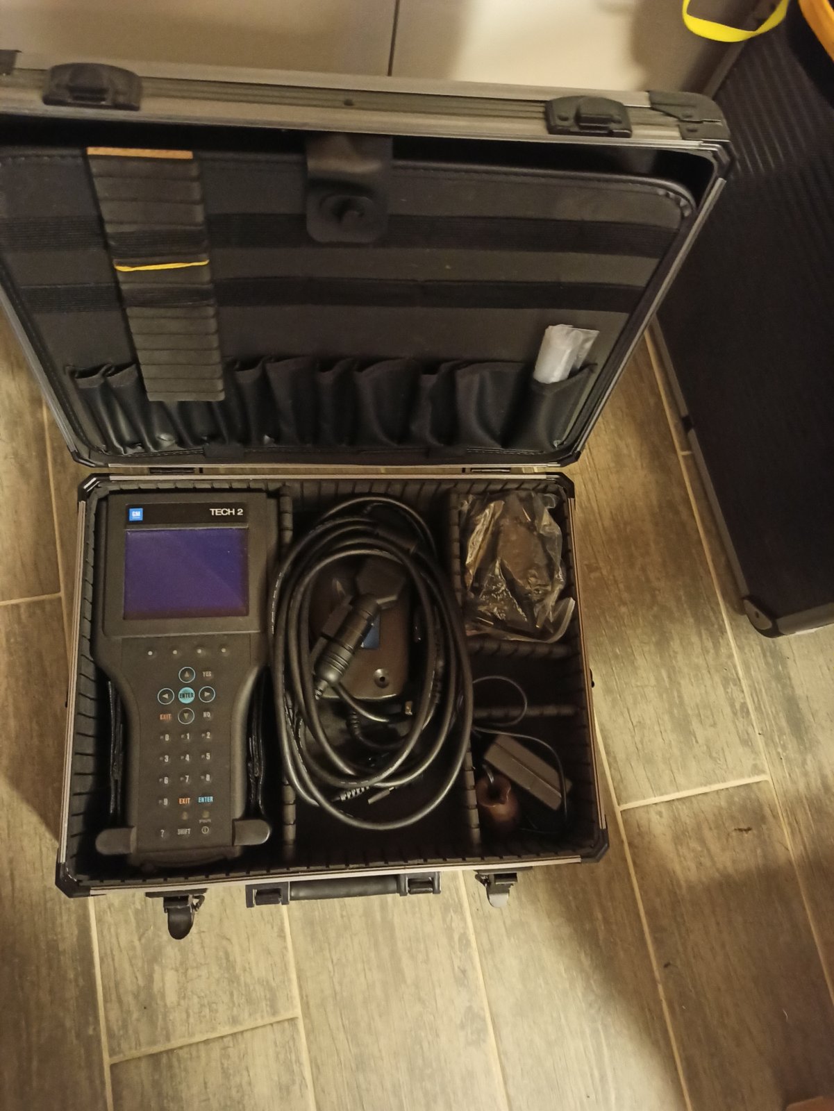

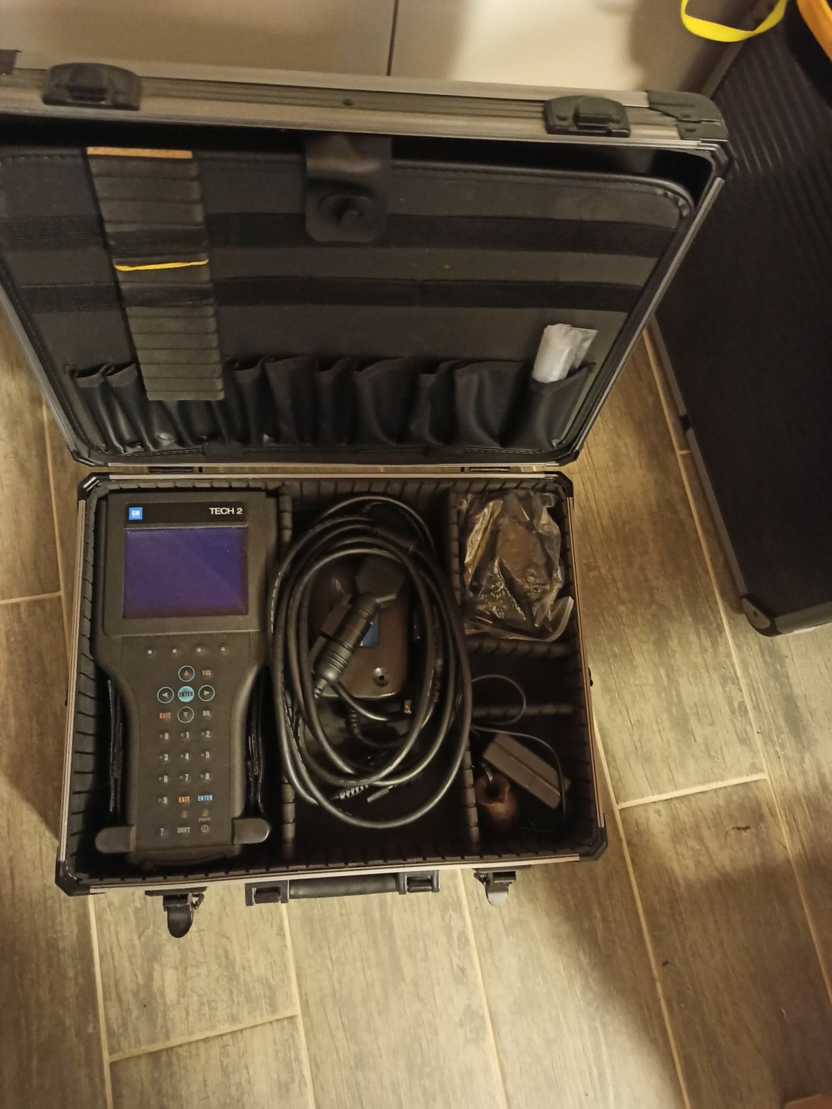

@Bandit-66
Can you give me the measurements to the case, I would like to get me one of those cases.
on weekends, when I'm at home, I can give you the measurements.
I bought the case in Germany on Ebay and measured all the dimensions of the Tech2 and accessories and thought about how it fits best into the case and then ordered
