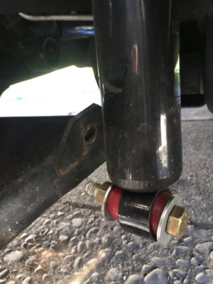

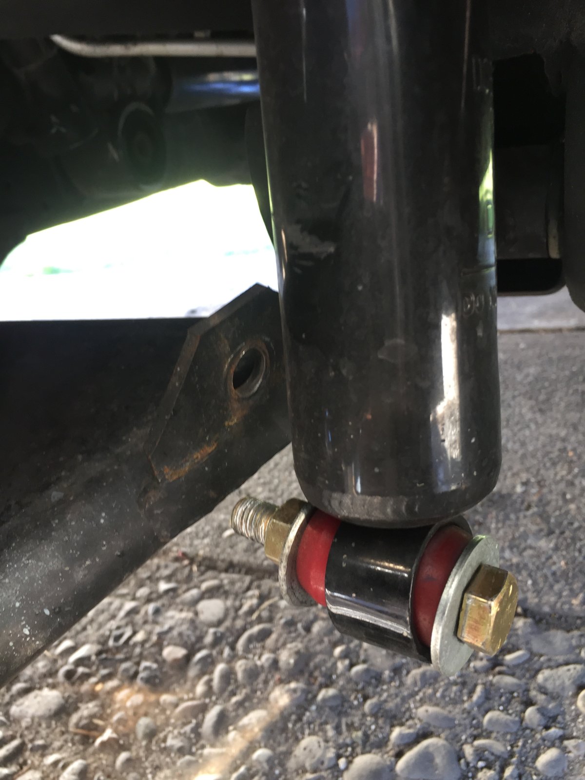

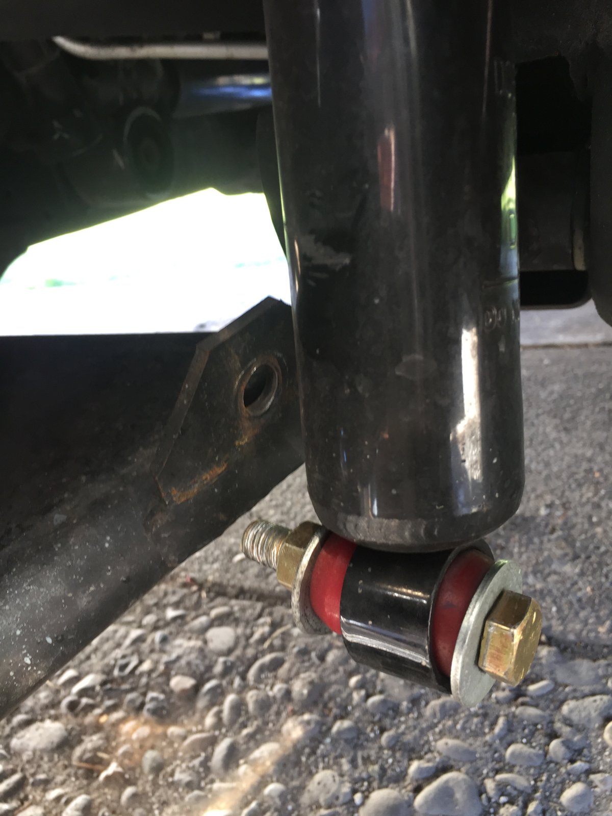

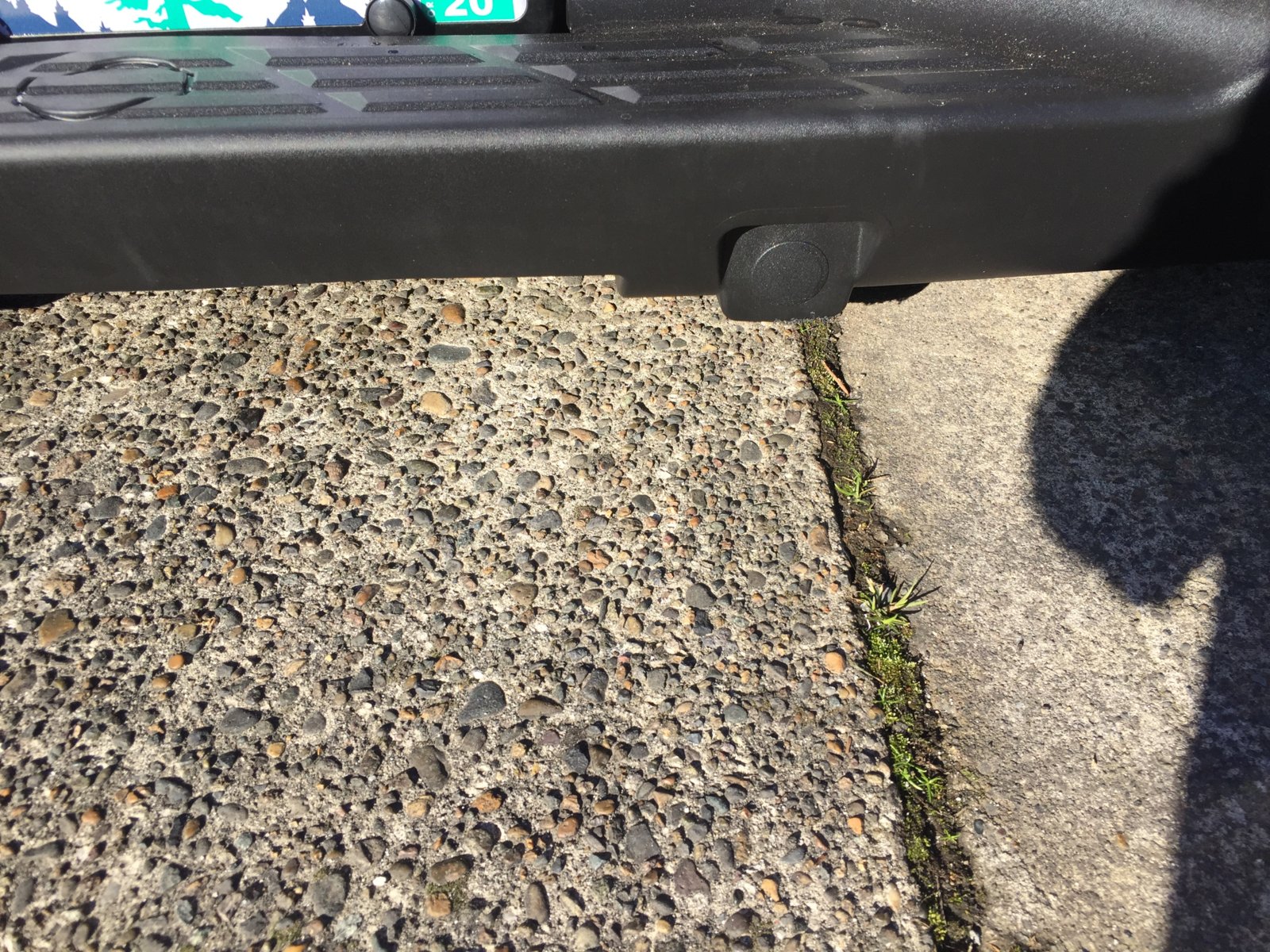

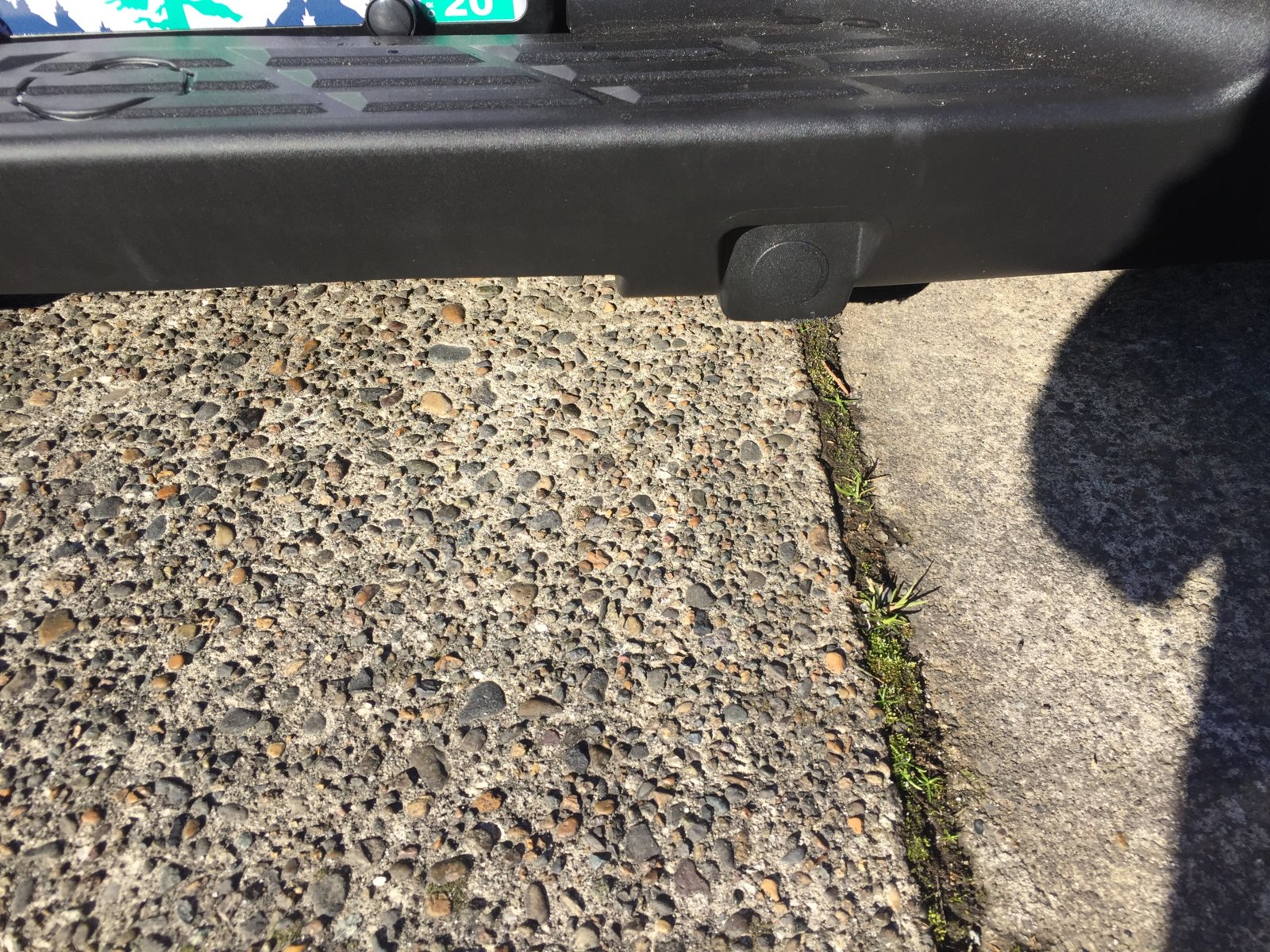

Just doing some minor stuff today; the 1 1/8" plugs came in so I popped a couple in the parking assist sensor holes in the rear bumper so that looks way better. Then I pulled the front wheels to clean the insides of them and found the bottom shock bolt on the passenger side was really loose. I took a look at the driver side and found it had fallen off. The PO had paid a mechanic to replace them a week before I bought the truck and I guess he doesn't believe in tightening things. The truck had a rattle depending on what height it was and the dude had told me he just had the exhaust welded on and it started happening right after that so he thought I just needed to bend the pipe away from the frame. Which never made sense to me because the ride height shouldn't have made a difference. This was the problem.
View attachment 192757 View attachment 192758
Jesus Christ, like one of the most basic pieces in a vehicle to install. How does one **** that up!!!
Luckily no harm was done but I'd still call the shop and give them an ear full

Oh the PO is, believe me. I texted him the pic. He said he's never taking anything there again, and he's gonna call them and *****.
