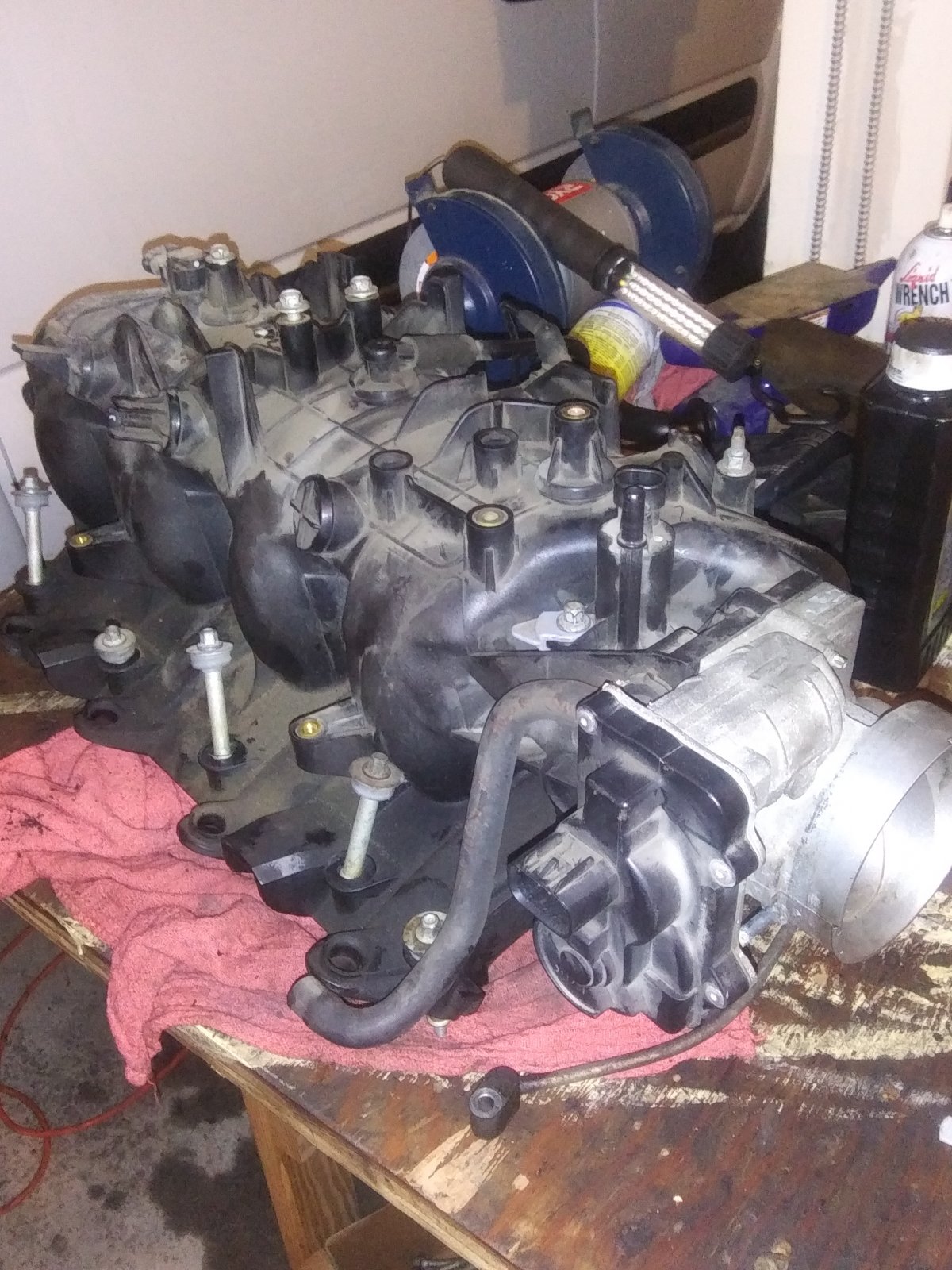

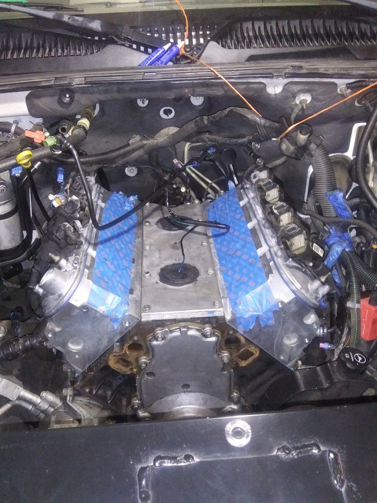

New valve cover gaskets and grommets. Put on coil packs, plugs and wires. Put dipstick back in. Noticed intake gasket had a few leaks, will put on tomorrow with new gaskets. Noticed some oil coming out of intake, needs a cleaning bad. That’s half of it s cleaning the parts before putting back

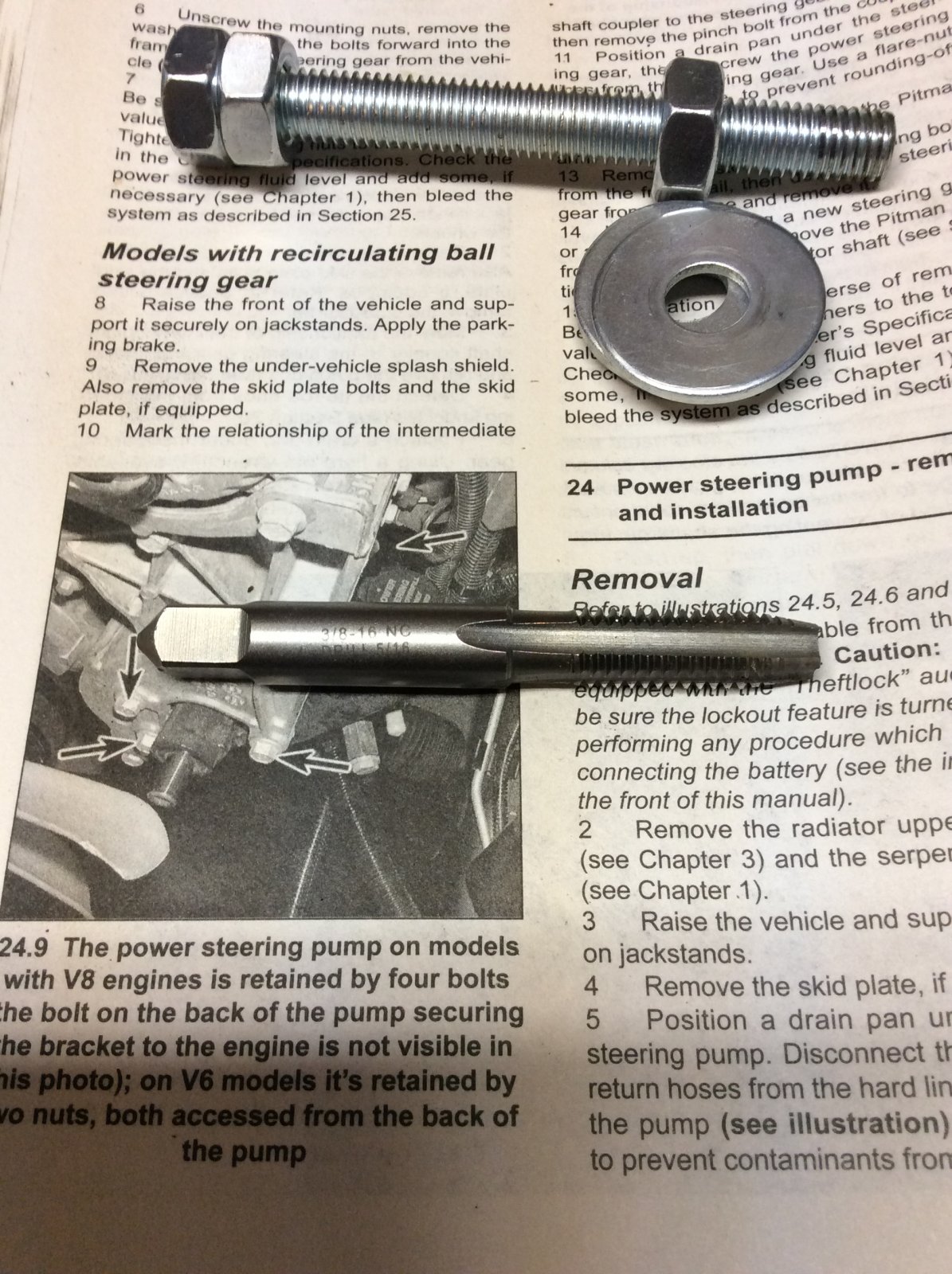

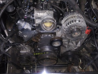

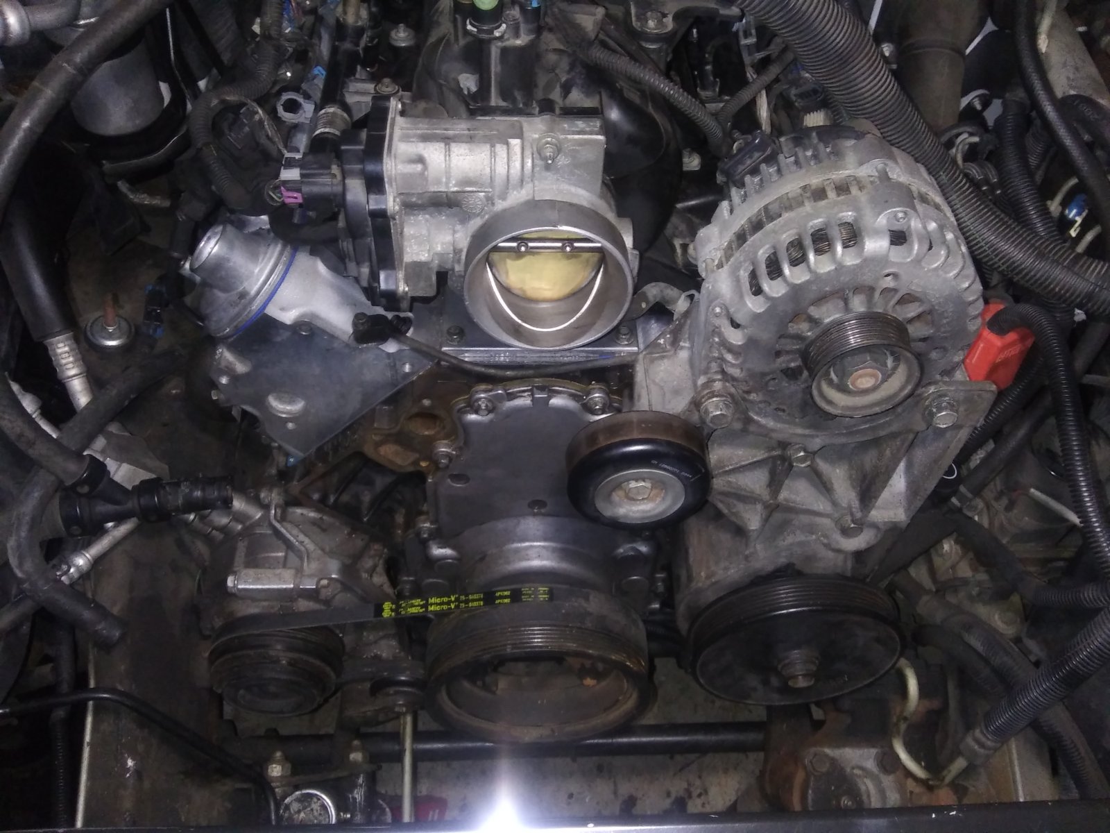

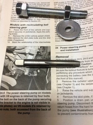

New injector o rings installed. Fuel rail all connections to injectors, etall. Cleaned up intake and installed with mount for steering pump, alternator . Need to rethread shaft for power steering pulley almost have it but threads are messed up. What size tap?
Close to end of cam swap. Yea !!

Nice got advice from folks that confirmed 3/8 for pulley shaft on power steering. Tap it out, put pulley the rest of the way on.

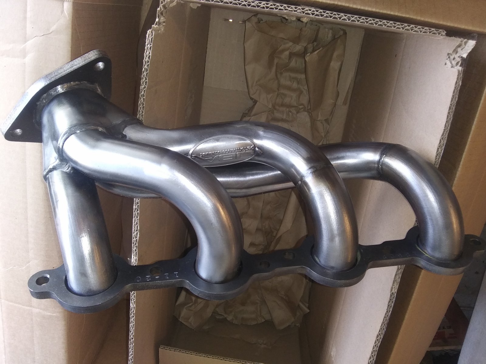

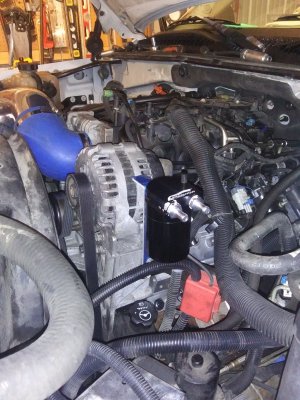

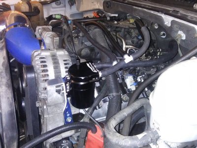

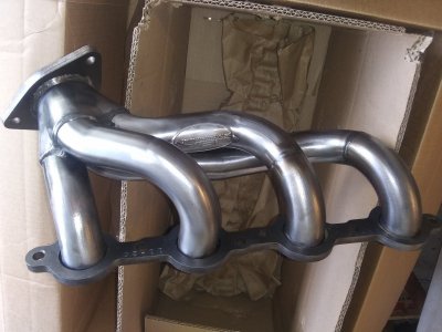

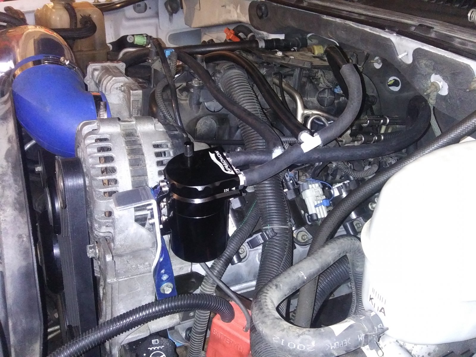

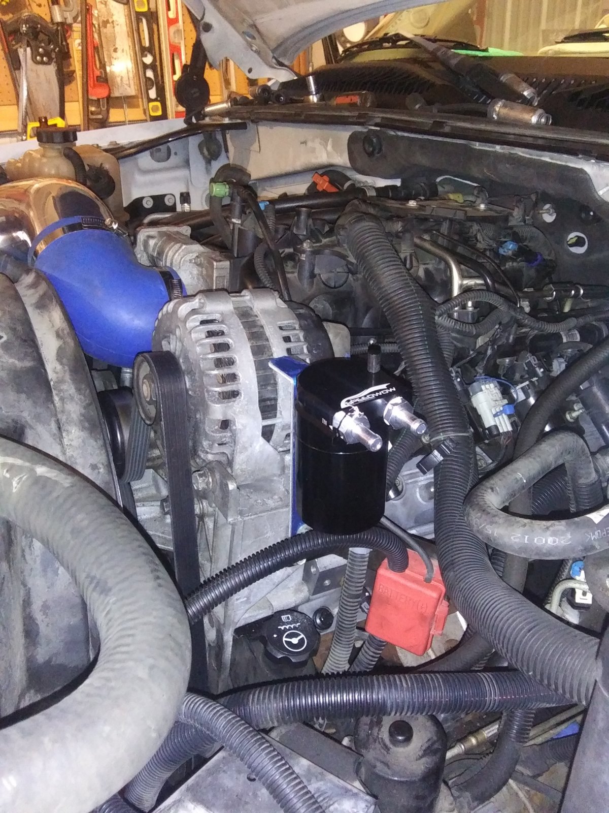

Whoa headers came today. Hurried with catch can and then installed passenger side header. Have to wait for dip stick tube to show Friday. Will install rest of exhaust tomorrow. I'll go back and redo hose for catch can from on top a little wonky.

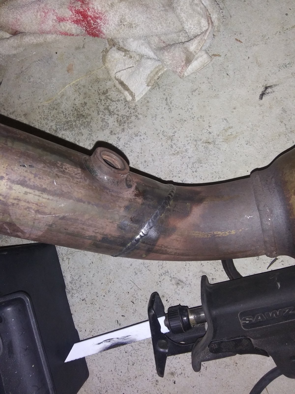

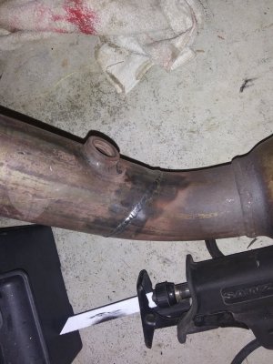

I couldn’t get the nuts off. Even after I removed exhaust manifold and in vise, soaked with pb still had a bear of a time getting the nuts off. So I thought I was not going to use that part (flange) anyway so I sawed em off.
Should have other side (header) done today and y pipe mounted. Dip stick needs to be replaced. I’m going to fire that mother today.
