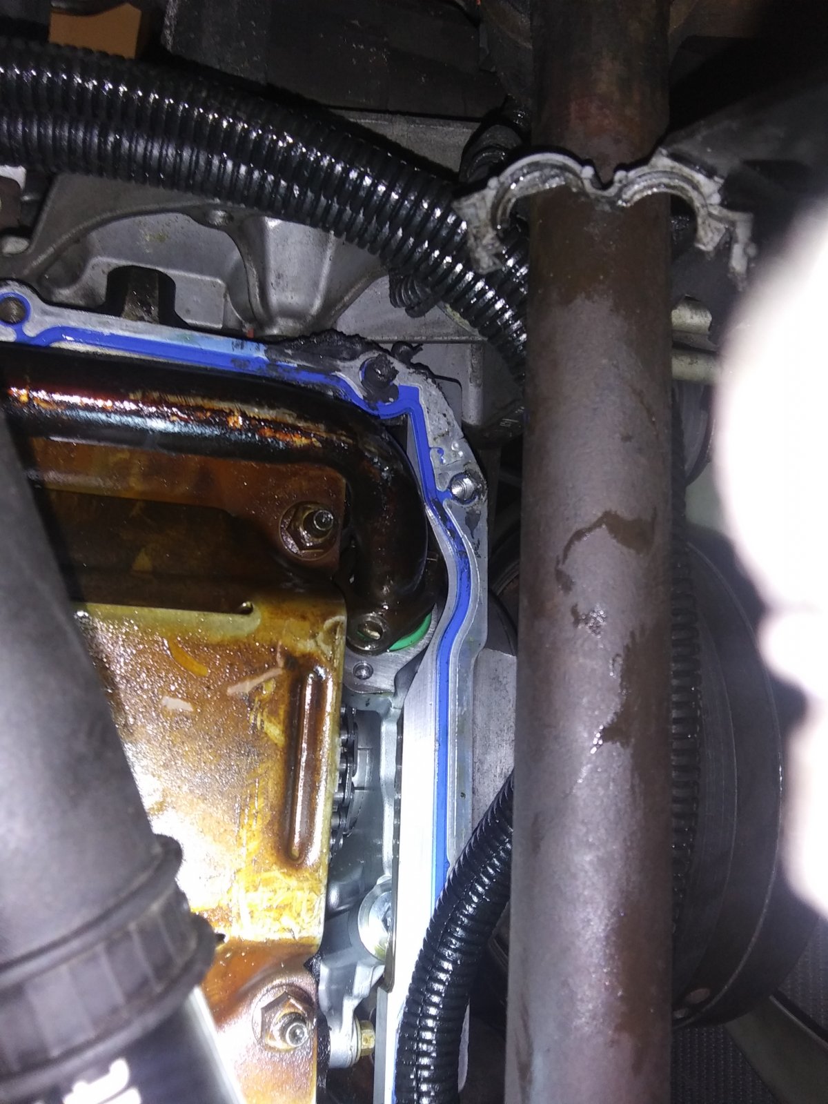

Had local scan guy come over look at oil pressure sensor to see if it was working. Figured oil pickup tube was faulty. Dropped front axle and pan, it was faster this time, and you can see the o ring not sealed. Ordered part from azon should be here sat. Still waiting for order from the 6th.

Why is there only one bolt in that pickup tube? Is it the wrong one or is the oil pump different or what exactly is going on to cause that o-ring to not seat?
Edit: nvm, I looked at the part you ordered. That’s weird because my LQ4 had 2 bolts.
The L33 of mine only has 1 bolt. Crap design in my opinion.

On post 31 you can see the end of the tube. The flange is only one bolt and doesn’t spin around. The l59 motor was leaking at the intake manifold, I had oil leak around Timing cover and was pretty thick under the motor. My overalls are most to the point I can stand em up. I’m glad I’m doing this. New cam, etc is going to be well worth it. The timing chain was sloppy at least 5/8 of play. Just need to shove the tube a little harder into the recep. The tranny will be next. One thing at a time. I started this odyssey in dec of last year, wrong parts, delay in shipping etc. I’m fine.

There are solutions out there to add another bolt clamping in the tube. Here's on example (note, i can't see well in the pic to determine if your's has the flange that they say *isn't* compatible with this product. There are other ones you should be able to find should you want to.) https://www.amazon.com/Billet-Pickup-Girdle-Support-551910/dp/B0784JPH59

Well got the oil tube hold bracket and wrong part. I have bracket on tube, forgot that part. 65 years old and my memory is like a fart in the wind.
So put tube back in and used the two bolts to hold down the tube. Much better. Torque and thread locker on everything, new oil, started the mother up. Still no oil pressure, had the rear end jacked up, but the good thing is I never got the low oil pressure warning on the pic. Will do the code reader today, basic tool just shows code that’s it. Clean up shop and wait till Friday for real code reader that will stop by and help. I think I’m good. He has the threaded pressure gauge and we’ll see. It has new sending unit prob go back to old one or separate gauge altogether. Cheers

Well... after dropping axle , fixing intake for oil and starting it up with no warning on pic about low oil pressure the gauge was not working. Called scan guy he came over today and said I hope I didn’t leave the sensor unplugged.
Yep, unplugged. Oil pressure would go up on throttle and now around forty lbs. . Happy man. Seems to run a little off, won’t idle. But it should relearn at least a little don’t you think? I read it has to be cycled a few times to shake the bugs out, we’ll see. Will take to tuner to finish the job. Sounds pretty good, I need a better air cleaner this one seems a little to open for me. Thanks everyone for advice and encouragement.

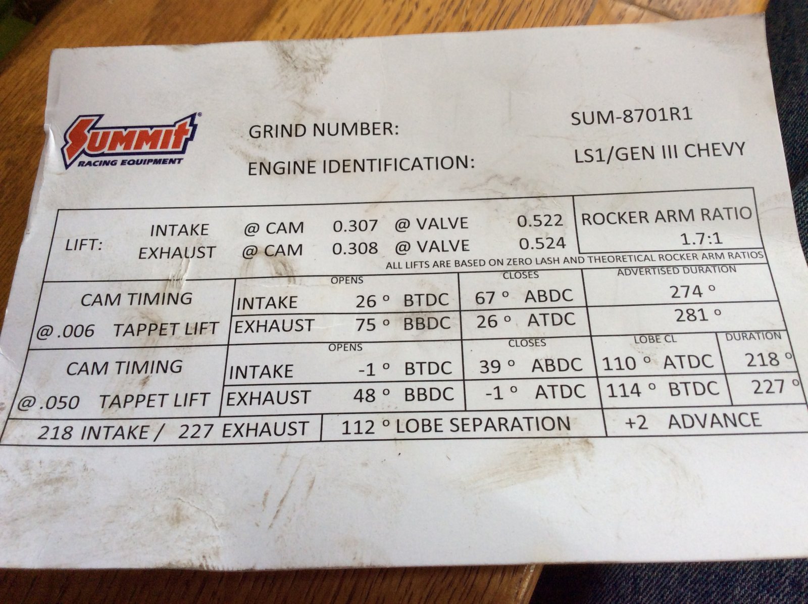

Thought I might post this.

That my friend is a fairly healthy upgrade. You may have to flat out get it tuned to idle and drive. But, you could try just feathering the throttle enough to keep it running till it gets warm. Then it SHOULD go into closed loop and learn a little. But, most likely it will need a tune. On the plus side with that cam and headers it should make significantly more power.

Well Richard Holdener dynoed a 5.3 with the summit 8720 which i will post the specs for, but it is virtually identical to yours valve timing wise at .050 lift. BUT with more lift. He saw about 60 hp increase, so i would wager a guess that you MAY see around 40 to 45 increase since you are still running full exhaust and he just tested with headers.
