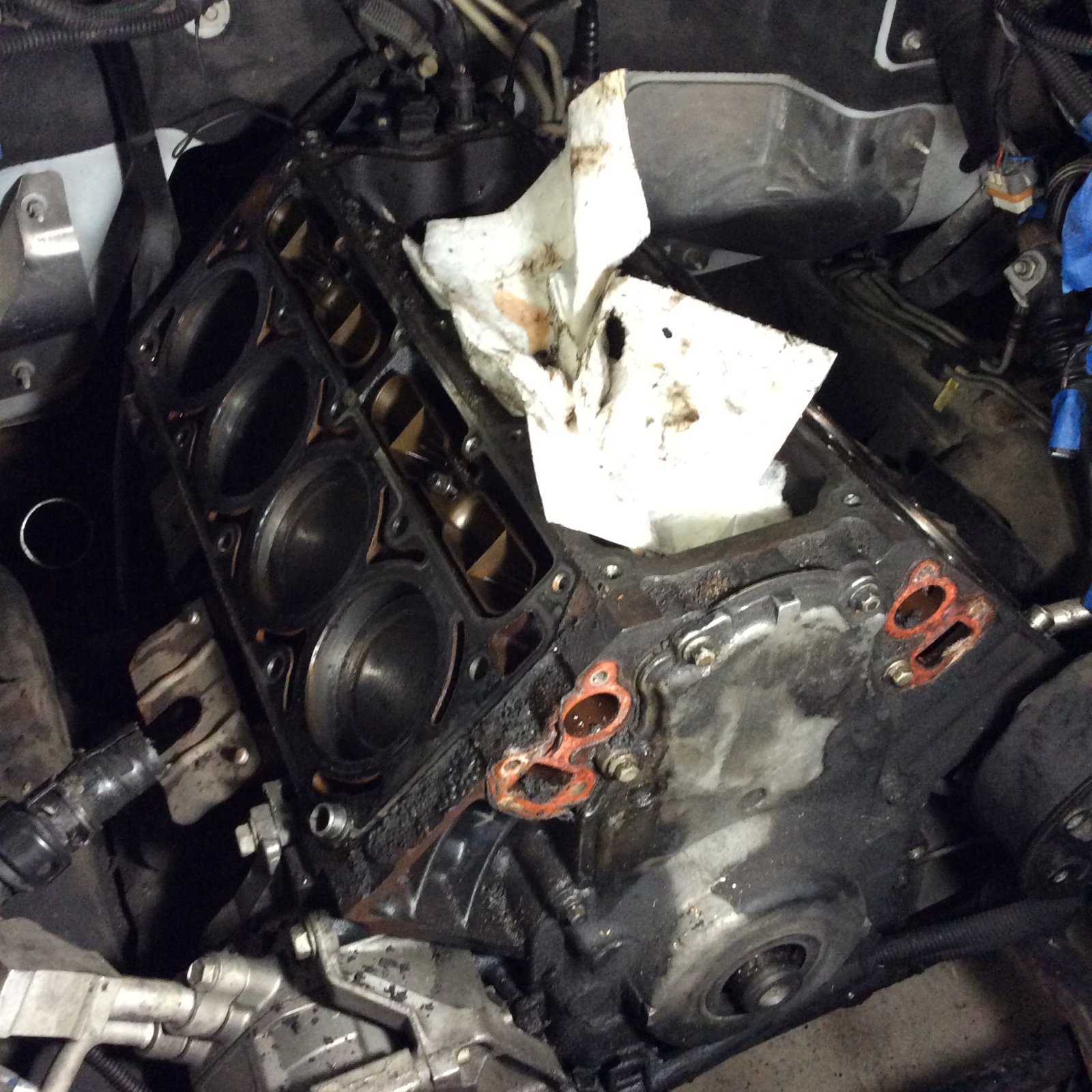

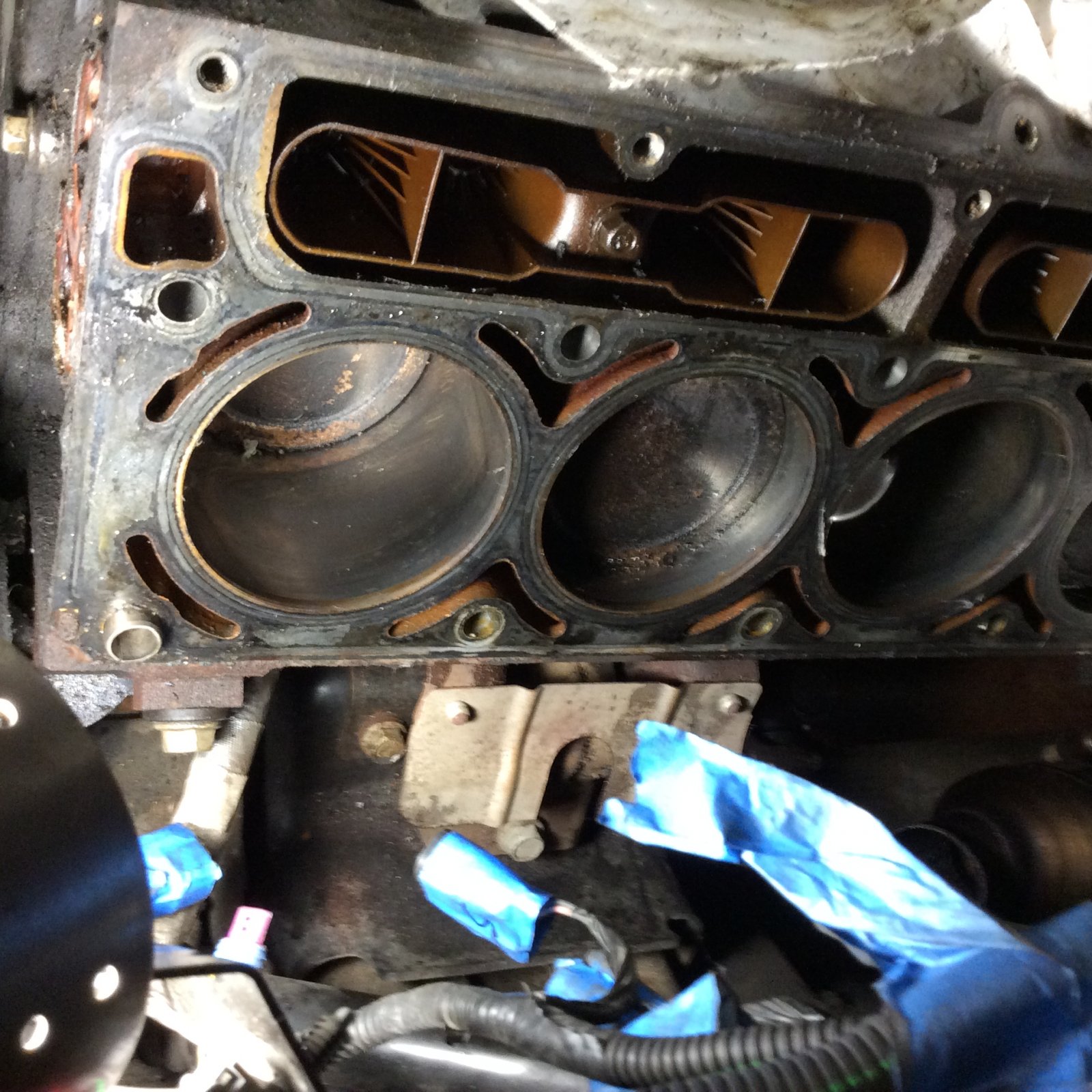

Just a couple of shots. I can still see crosshatch in cylinder. Have just a little bit of cleanup ahead. Just cleaning tomorrow. Maybe pull cam ,lifters timing chain. Dunno

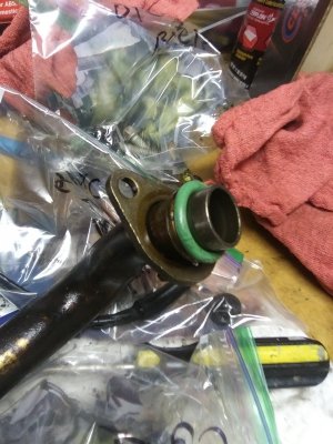

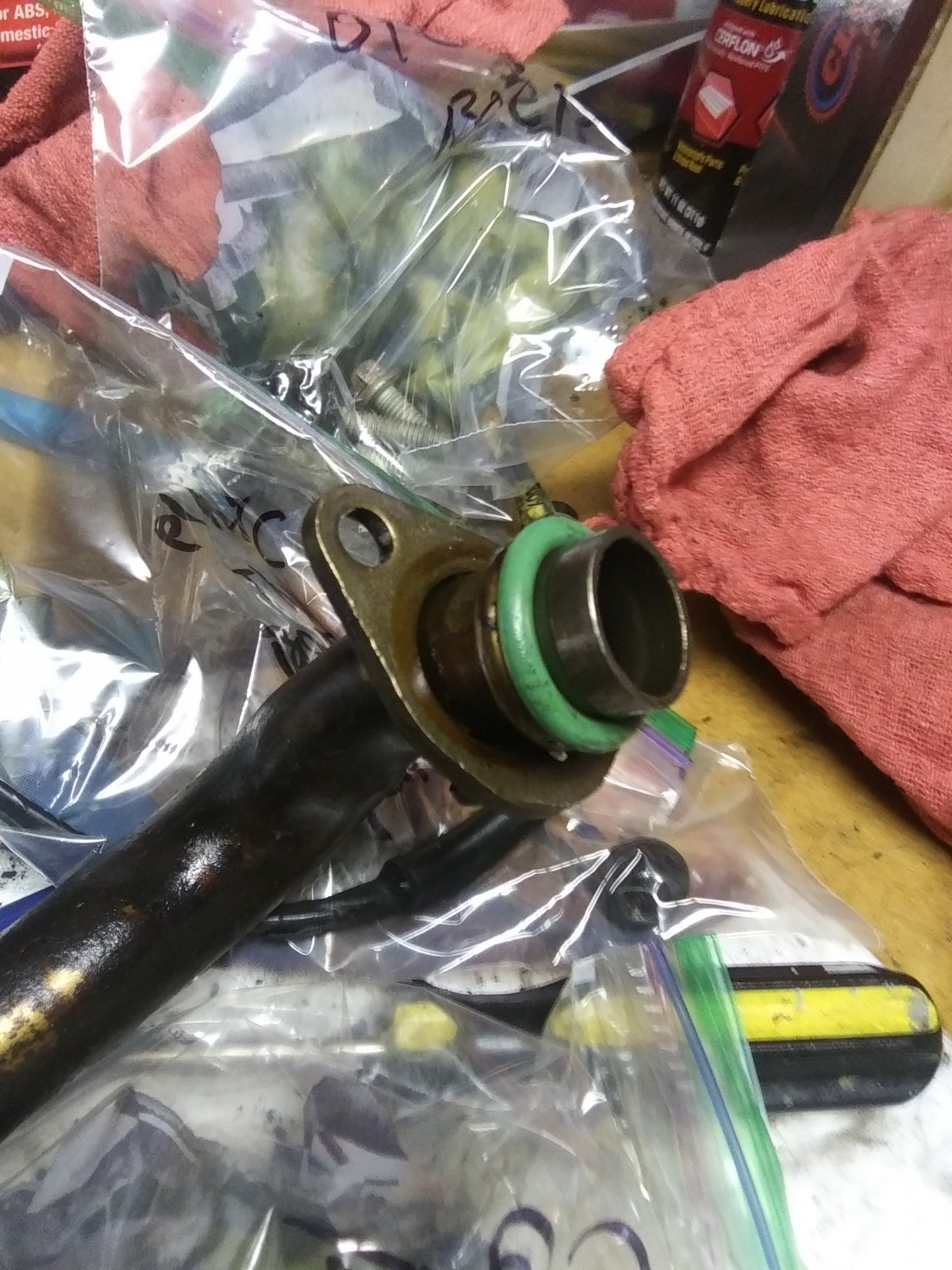

Dropped front axle, and got the pan off. Looks good, no sludge, screen clean. Dropped-pickup tube to replace o-ring.
Yanked lifters, pulled oil pump to get to timing chain for replacement. I think I saw 5/8 of play in chain is to much and replace. Almost to my goal of swapin cam out, for a nice one.
Then oil pump back on ....
Pick up heads tomorrow, had em cleaned. Bottom of the apex and now the new stuff starts going in.

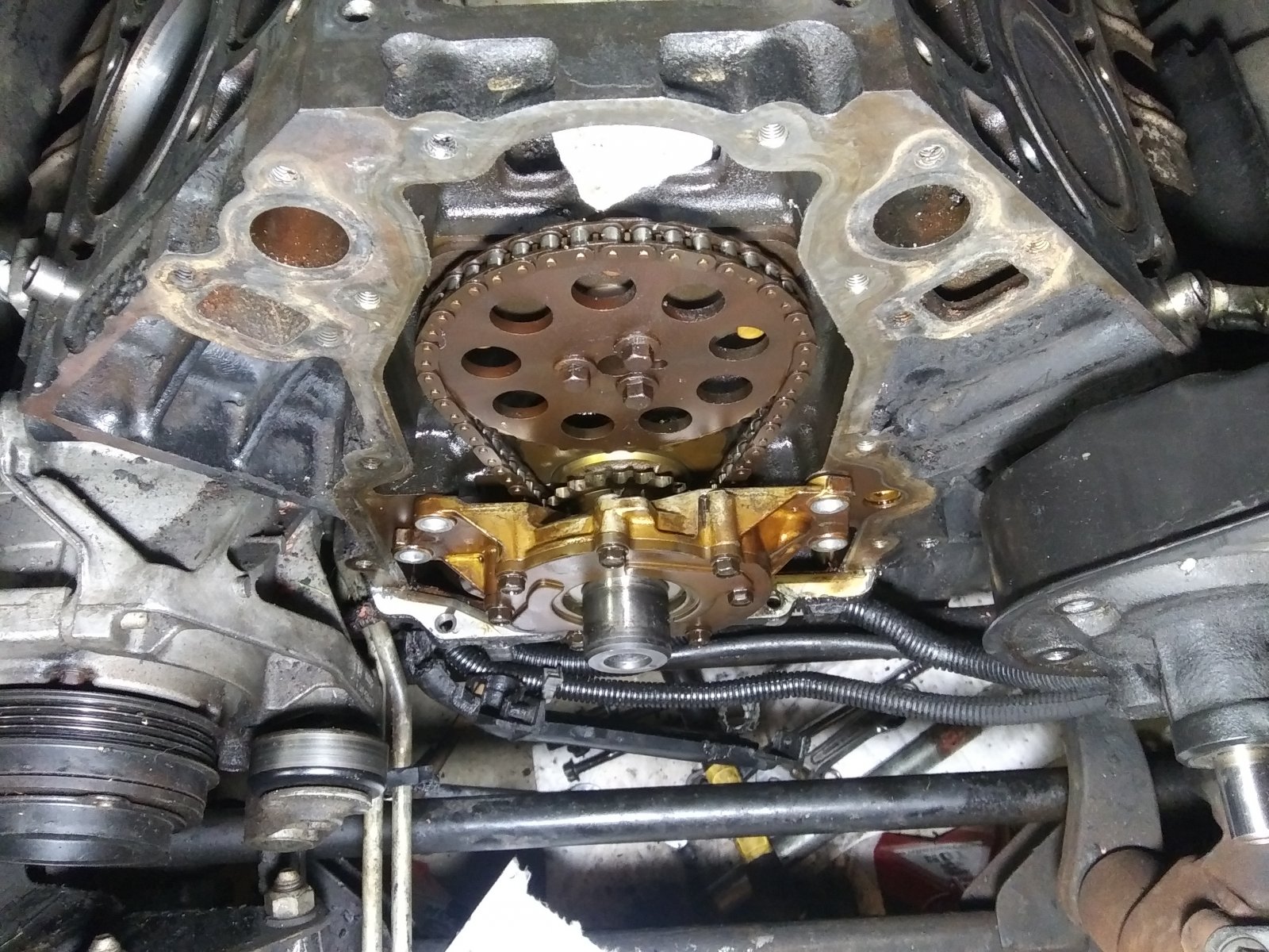

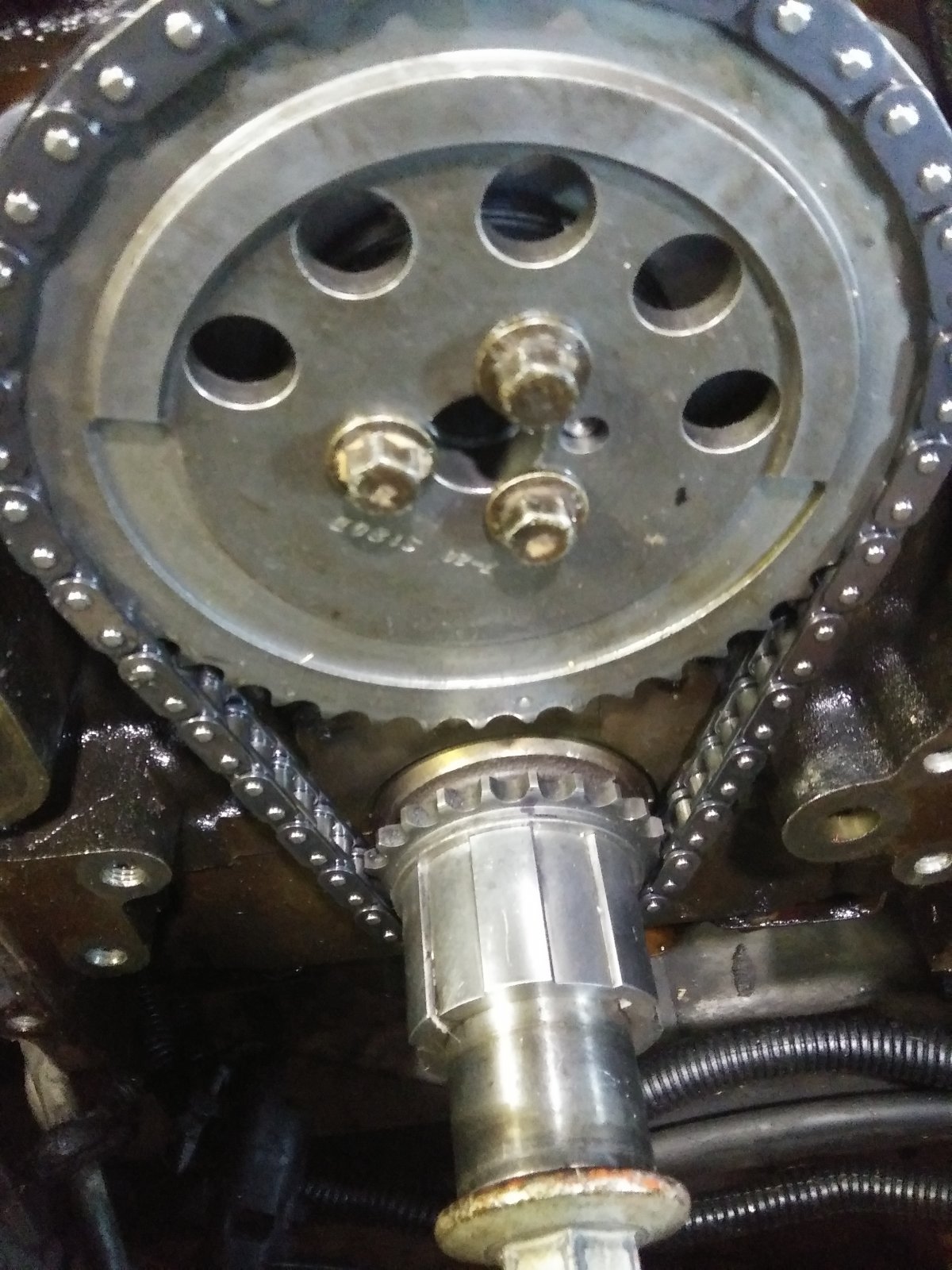

Spent the day removing timing gear on crank. I have 2 pullers one to small and one 2 big. Went to parts store borrowed puller. Too big. Bought smaller puller but bigger than my small one. Scavenged parts off each other to make one. Fits but not enough clearance to set screw to push against. Went to parts store bought flat head 5/16 or bugle head screw. Fit flush with crank shaft where the balancer bolt goes. Pulled gear off while trying to keep the 1 cylinder tdc. Got the new gear on. Geez what a day. Tomorrow put crank back to tdc and yank/ install cam.

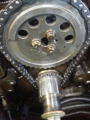

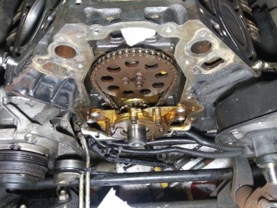

Finally got the cam delivered. Put new cam in, new lock plate , new main cam gear and chain. Old chain had at least 5/8 play, this one pretty tight. Took me a few try’s to line it up but finally got it. Put in new oil pump with new oil seal on pickup tube.
Slid on my belly like a reptile and got the pan back on, all new stuff torqued.
Tomorrow put front axle back up, and move on to timing cover, then I can start topside. There is a light, faint but it is there.
