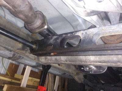

Well now I have to drop support for transfer case. I got the y pipe out. Figure I could get in back in. NOT. Forgot I sawed off the ends which gave me clearance to get it out. No biggie do that tomorrow. Spent most of today just getting the driver side header done. Didn’t have room. Had to remove tire and inner fender well. Boom it’s right there. Still had to futz to get em all in. Had to feed header from below couldn’t drop down from above. It’s in. I had to lay across engine to get at bolts. Got my cardio in today.

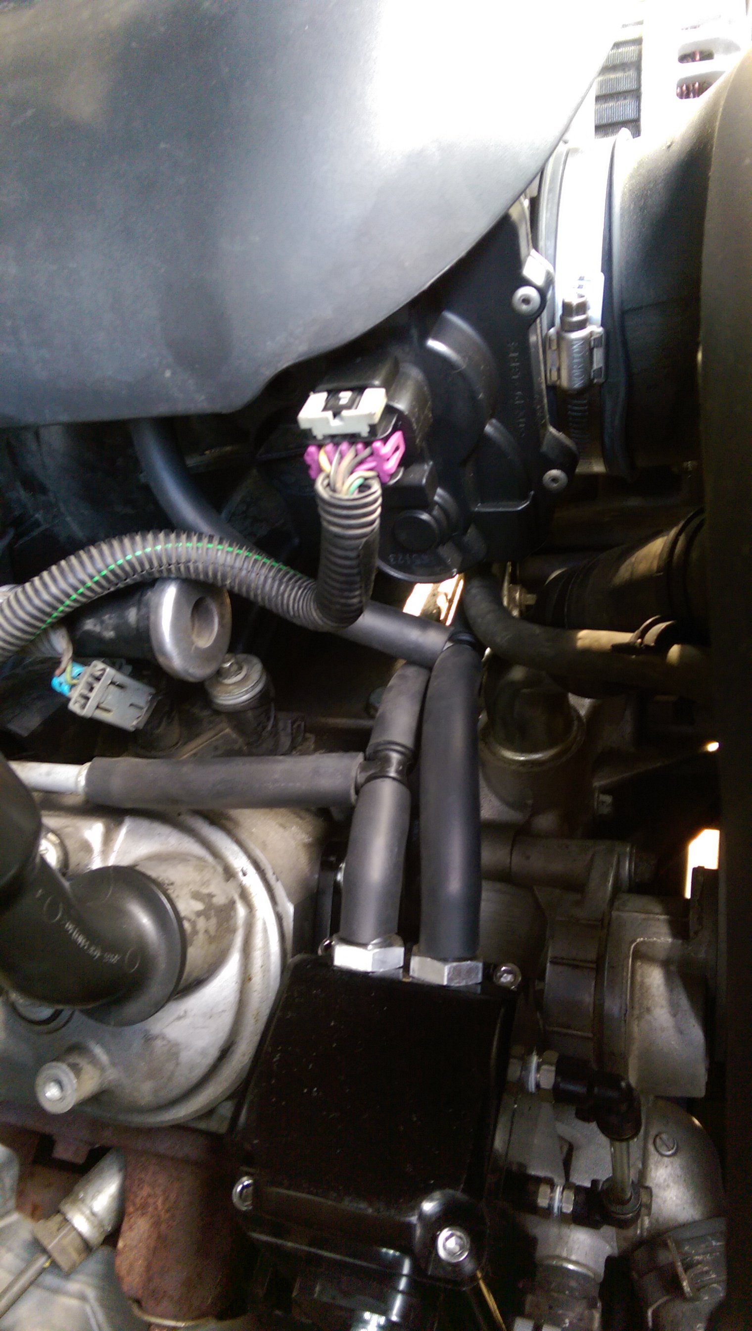

See the link in the original post for pics on Speed Engineering website. The hose plumbing is very simple. Both valve cover vents go to one side of the catch can. I used the IN side closest to the engine. The passenger side vent tube is above the valve cover and pointing toward the front and the driver side is at the rear of the valve cover pointing up.
The OUT side of the catch can goes to two connections on the intake manifold. The passenger side connection is just behind the throttle body and the driver side is top center of the intake.
The passenger side connections are very short. I routed the driver side hoses in the space under the throttle body and above the water pump.
All the above is for a 2005 LQ9 using a 2004 5.3 flex fuel intake manifold. Others may slightly differ.
The catch can does not have IN and OUT marked, so you can do whatever you like. I got the hose & 3/8" fittings at O'Reilly's.
The clear sight tube is included with the kit. There are no instructions included.
Looks like I can splice both sides together. The can I bought has a filter like a water separator in an air line for the intake side, which I reversed . The line would back up. I want free flow in can then on the exit side the mesh filter.

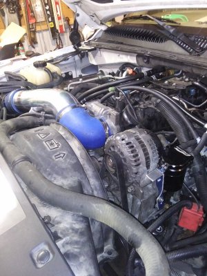

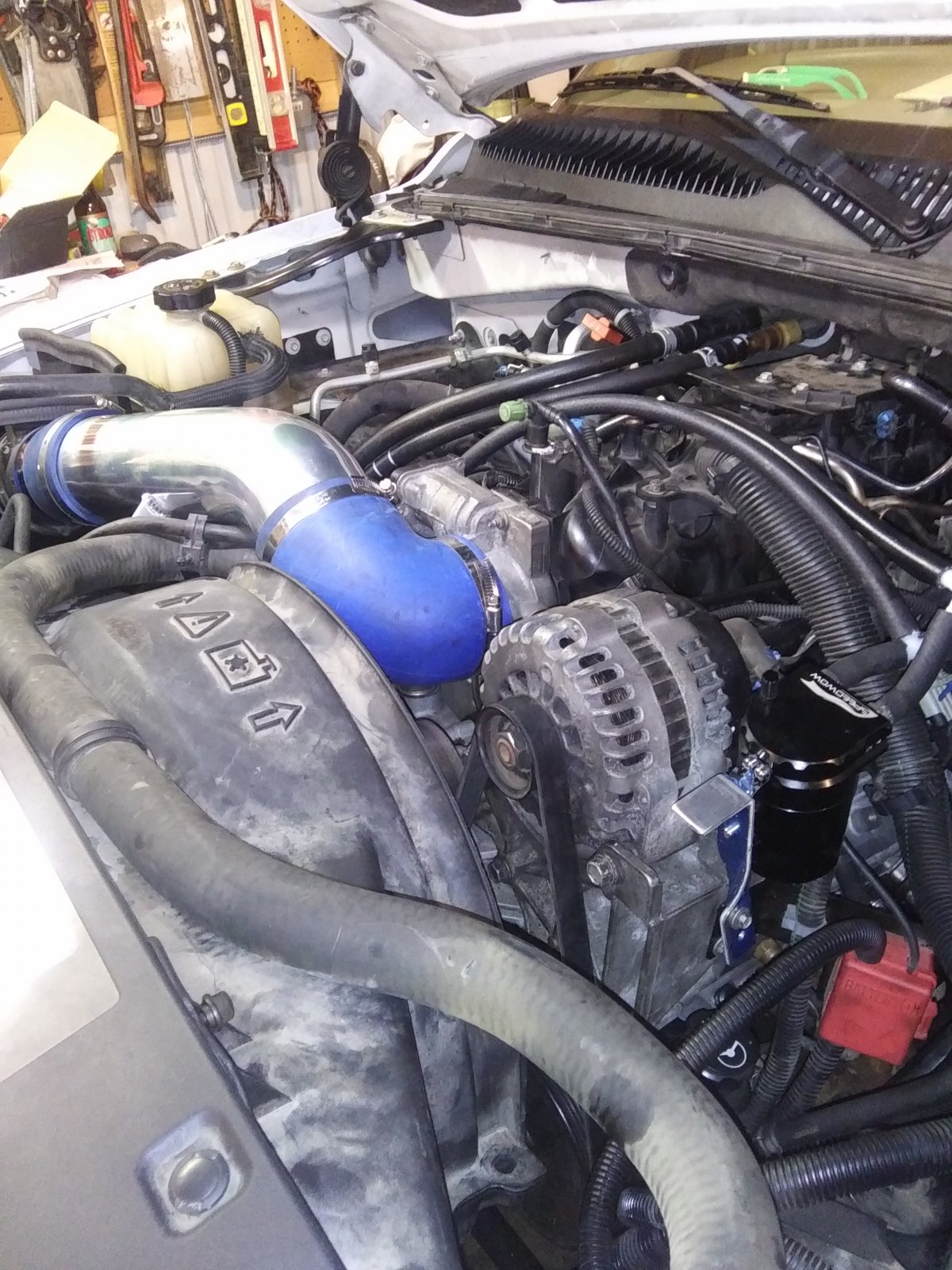

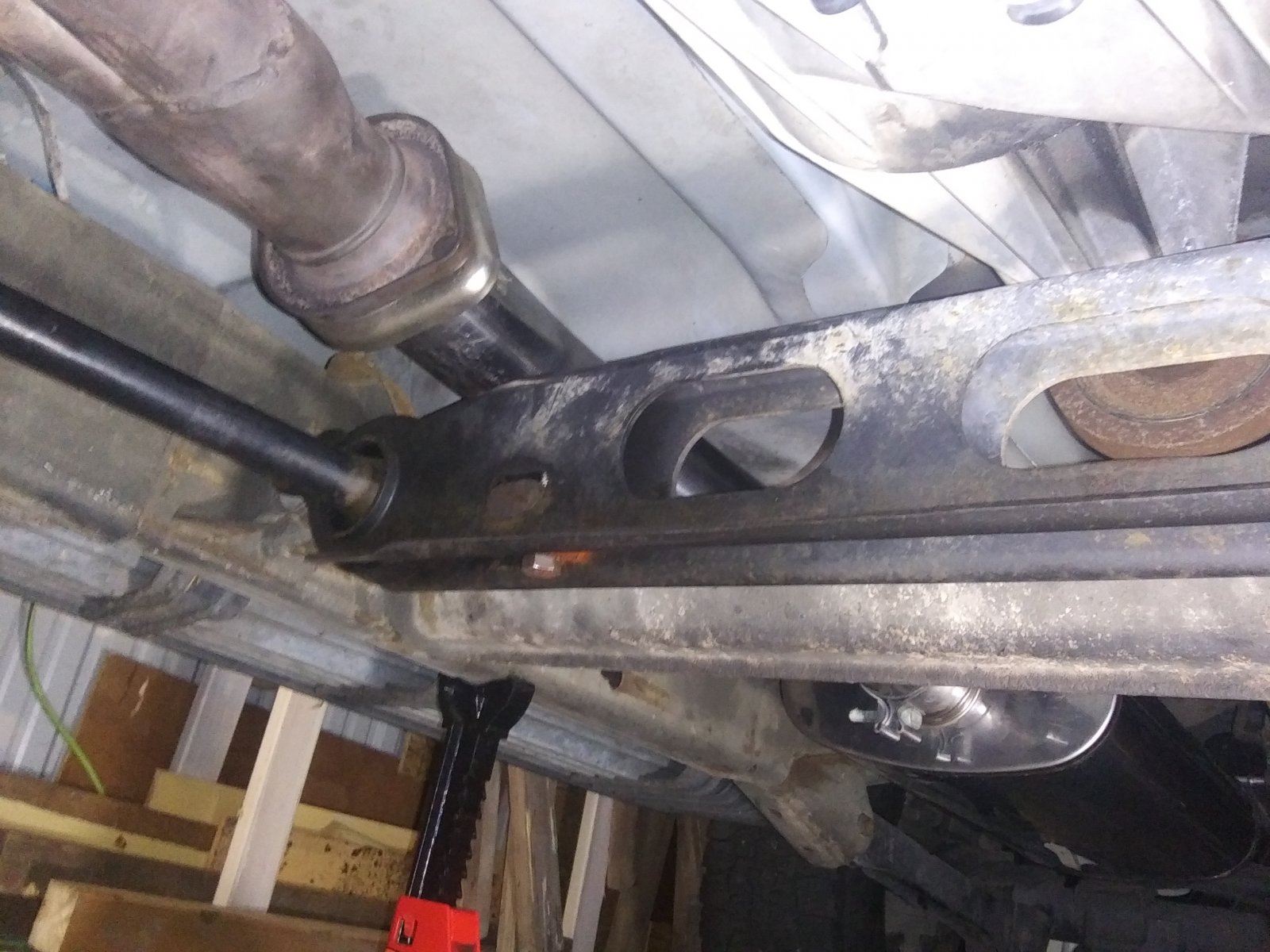

Dropped support for transfer case and got the y pipe back into place. Headers almost bolted up lost lock washer had to go get a couple. Support back up. I'm so ffffin close. Pictures of catch can and headers.

Well finished header install , a lesson in manual dexterity. Hooked up magnaflow cat back.

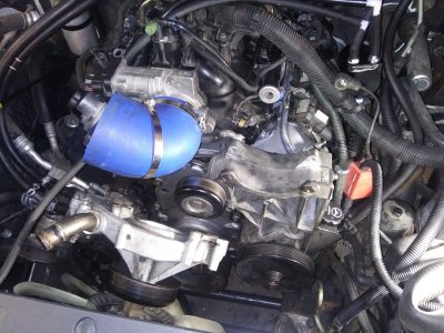

Put everything back together...
Started it up and oil gauge moved this time but no pressure. Looks like on to the sensor. Damn. Took recording of tailpipe sound but file is to large. Mp4. Well back at it tomorrow.
