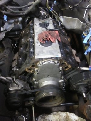

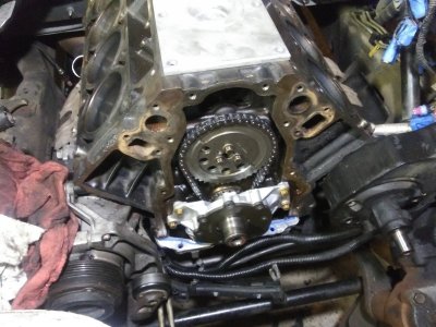

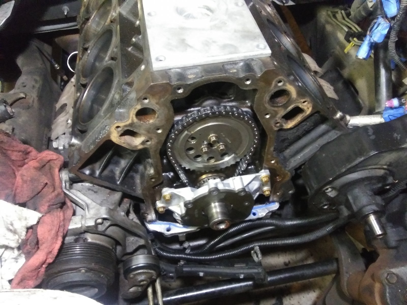

Today I made sure oil filter was on, bolts on pan torqued.
Put on timing cover, harmonic bal, air con belt, lifters and their trays.
Replaced knock sensors and reinstalled valley cover. Heads tomorrow for push rods measure. Before and after pics.

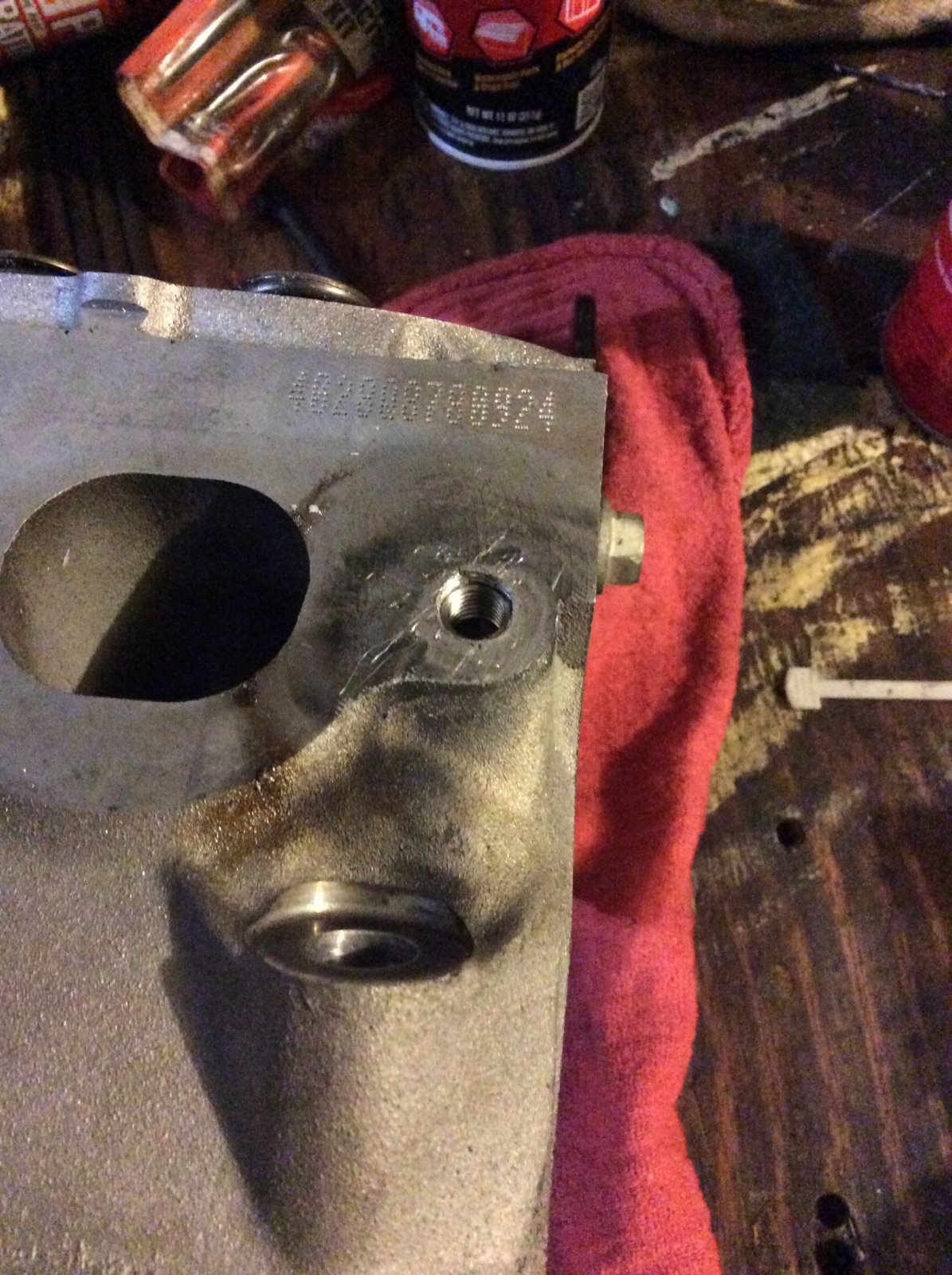

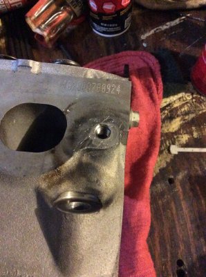

Looks like the cable is the big thing. But will read Pete Sontag stuff, right now I’m dealing with a broken exhaust bolt in the head. Installed one head and measured for pushrods. Moved to broken bolt been soaking with pb ( no iamdub it’s not peanut butter) drilled out for easy out, but you guessed it , it broke off. It’s at machine shop , maybe in the market for a head l59 ,flex 5.3 ls where the head bolts are just two sizes. Geez .

Blew like crazy here. 70 mph. Down trees pull lines down. Running generator between house and well.
But for good news I got head back and all ok. Ordered pushrods, trunnion kit Tuesday , 2 nd day air. For p rods.
