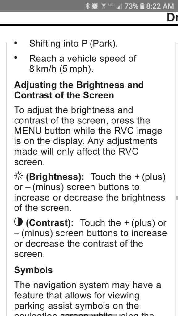

Are you able to adjust the brightness and contrast on the backup camera view?
I'm told, and it says in the manual, that while in reverse you should be able to push the menu button and have those adjustment settings available. I can't get mine to do that?

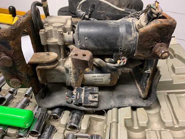

Changed the Air Compressor ad put in the new fuse. What an absolute Bi$ch it was. I had to cut the connector (discontd the batt first) to get the wire harness apart. It was CAKED with dried mud.
see pic of compressor- fully trashed
wjburken
Dec 26, 2017
10,314
29,540
Eastern Iowa
Yep, that’s about what I would expect. The two that I had to swap out looked very similar. After the first one, I learned to put a grinding face mask and stocking cap on to keep from looking like something exploded in my face.
