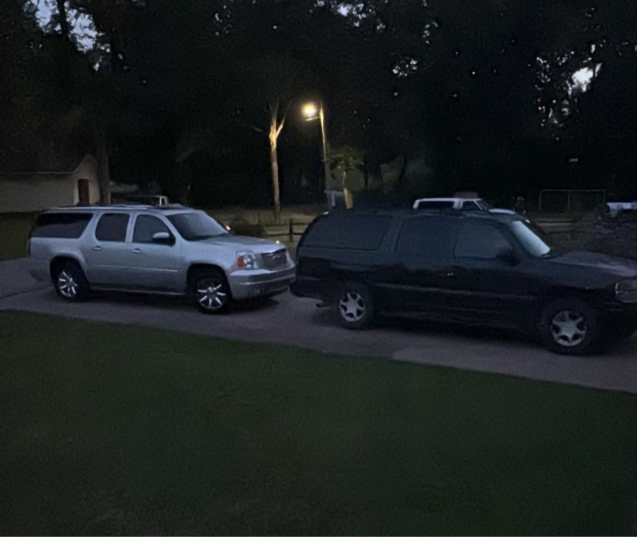

Thanks so much for the welcome. I can tell there’s knowledge, experience, and wisdom here. I appreciate yall walking me through this!
Attached are my two Denali’s. 2003 with 200k+ and my 2013 with 155k.
Nice trucks!
Okay, time to see what you're made of...which platform do you like more?
Not counting your current frustration, but also weighing in the fact you are having a problem.

Thanks! I appreciate the design and features of the new one but the old one has been absolute champ. We’ve had it since 2014 and haven’t put more than $2k into it.
This 2013 we’ve had since March of 2024 and put a new engine in it plus about $4k on top of that.

Aw man, sounds like a point for @OR VietVet!
Sounds like my story on my 97 vs my 2012. I think the 2010-14s are at the age where they start to develop big problems but will be happy for another decade if fixed up.
