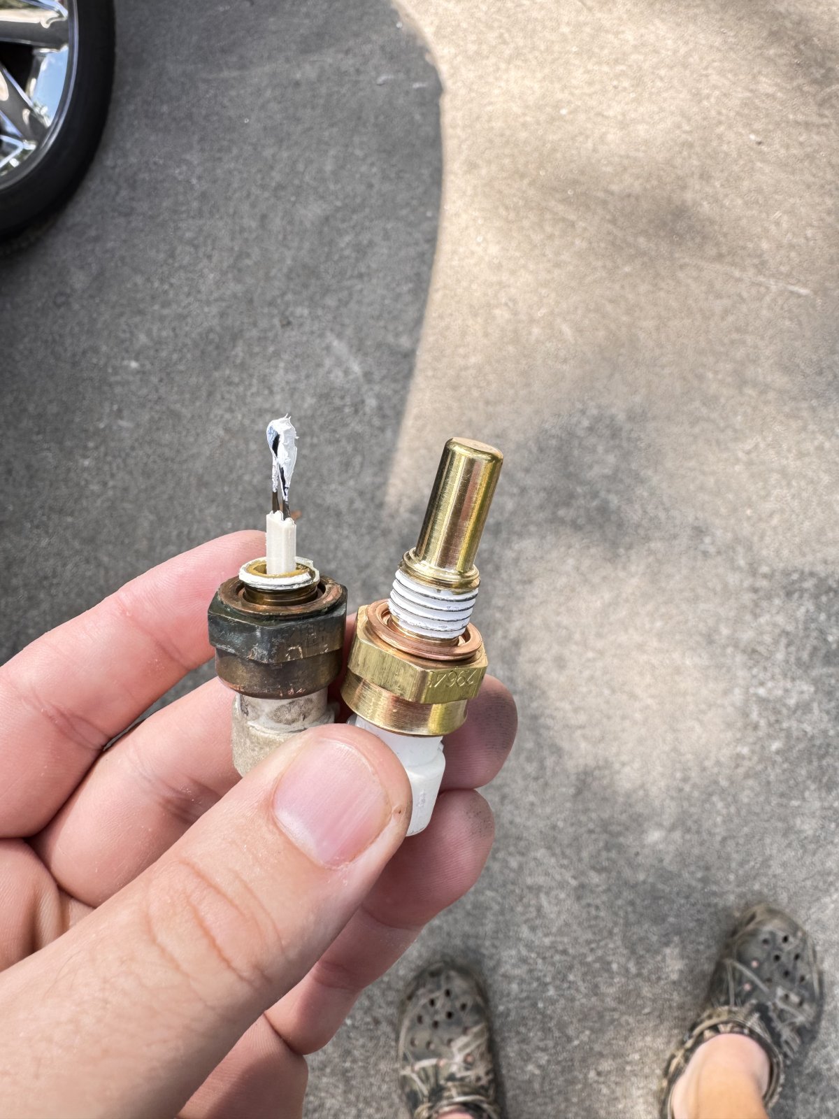

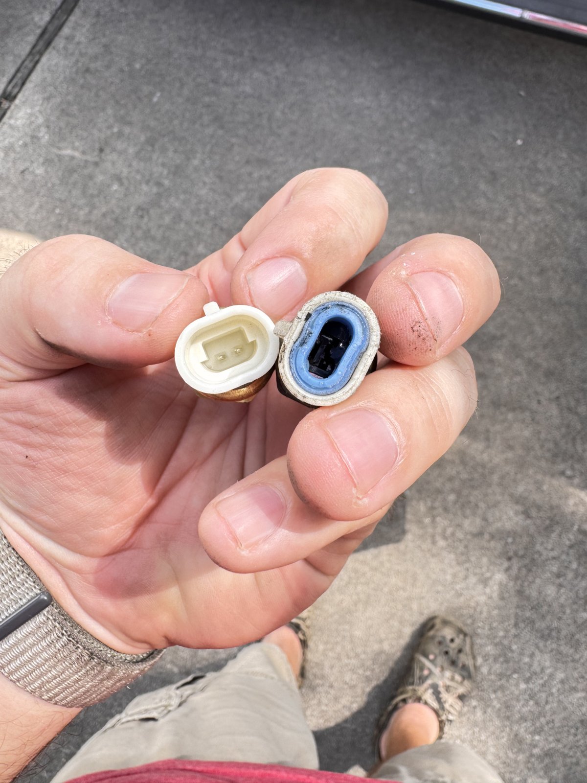

Alright good news!! ECT sensor was replaced. However what should have been a 10 minute job turned into a whole ordeal. The original sensor was cracked at the threads and when I went to remove it, broke off. The probe and half the threads were stuck in the engine block. Had to use an easy out to back it out. Also the electrical connector broke off inside the original sensor.
Thankfully it all came together. She runs quieter and the AC runs colder. We’ll see how things work out the next few weeks.

This was most likely the problem with the starting and AC/Fan operation.
I assume you will know within a few days if the problems have been correctly by replaced the Coolant Temperature sensor.
Hope this solves your problems. Easy fix except for the fact the sensor broke off in the engine.

I’m fairly certain that this broke off before me even touching it! In fact, I think that’s the whole cause of my issues, I think the part was over tightened when the mechanic installed the new motor back in March.
Sorry, I did not read far enough back to see anything about a new motor in March. Sounds like it was overtightened.
