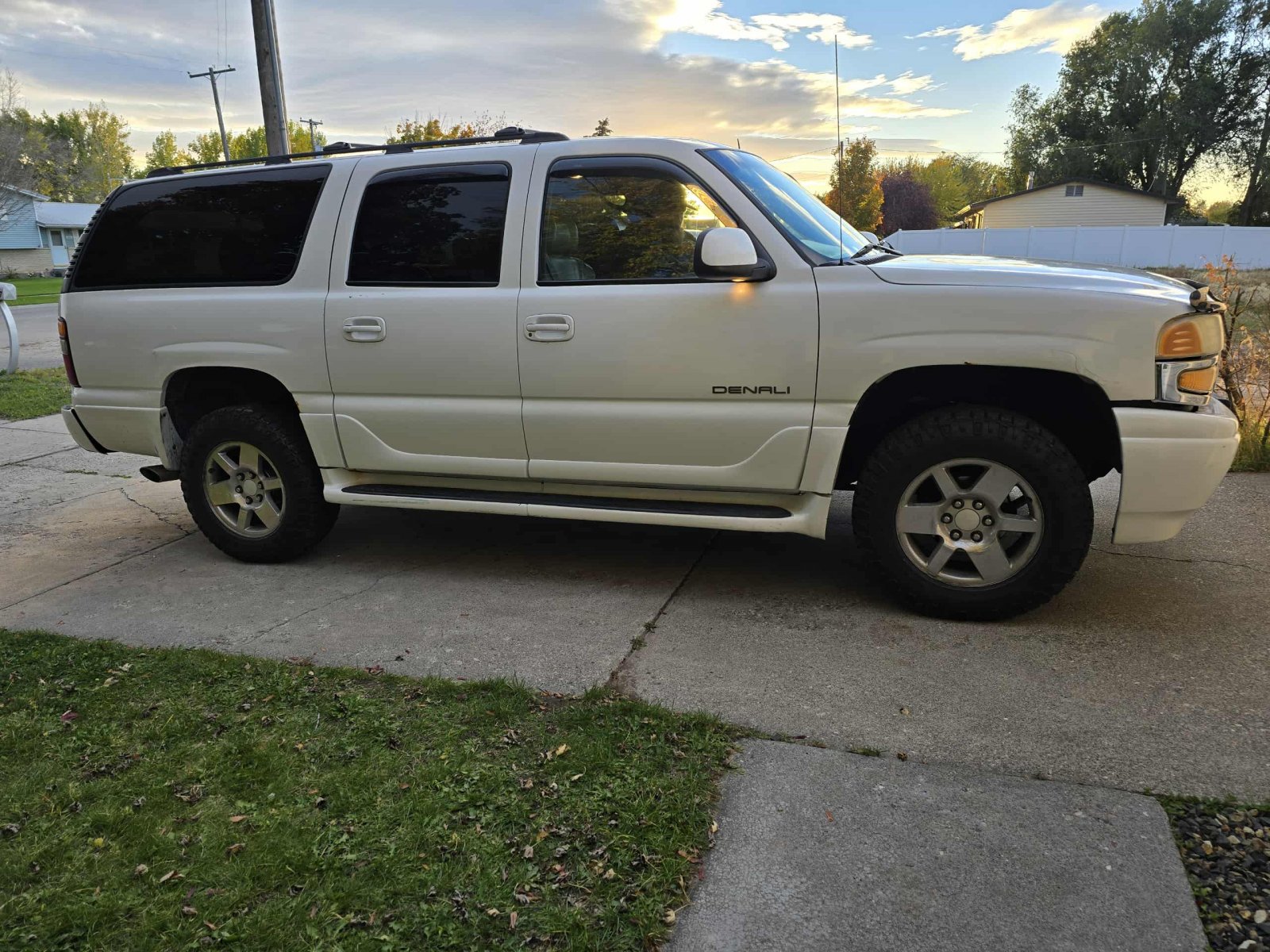

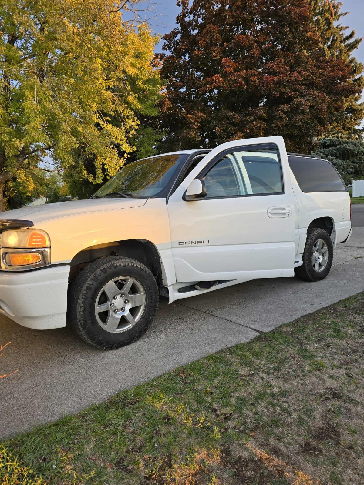

That makes sense, the squeezing for that extra pint. I'll see if I can get underneath it this weekend and give it a look and a blow.
Posted some pics of the rig below. Not too bad of shape for +200k miles.
