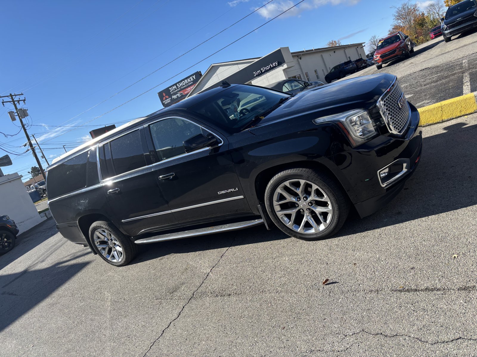

Pics of the truck, please.

I appreciate all the advice! Here is a picture of my Yukon
