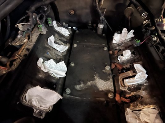

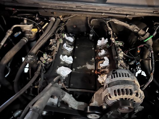

Replacing valley cover, pressure sensor and valve cover gaskets today-tomorrow, waiting for final parts today.
3 bolts on valley cover were finger-loose, didnt have to put any effort to unscrewing them, they just moved completely freely.
Got the idea to check them thanks to this great forum some time ago:)

Good deal! I had a similar experience when I did mine. Once the o-rings give up the ghost, no more tension. Keep us posted to the results.

@m1dn That valley looks very wet man, there is something happening in there that shouldn't be.
Yep, 3 bolts on it were completely loose, others not tight either, so oil was spitting out under pressure.
When i mean completely loose i mean like completely, take one finger and unscrew it

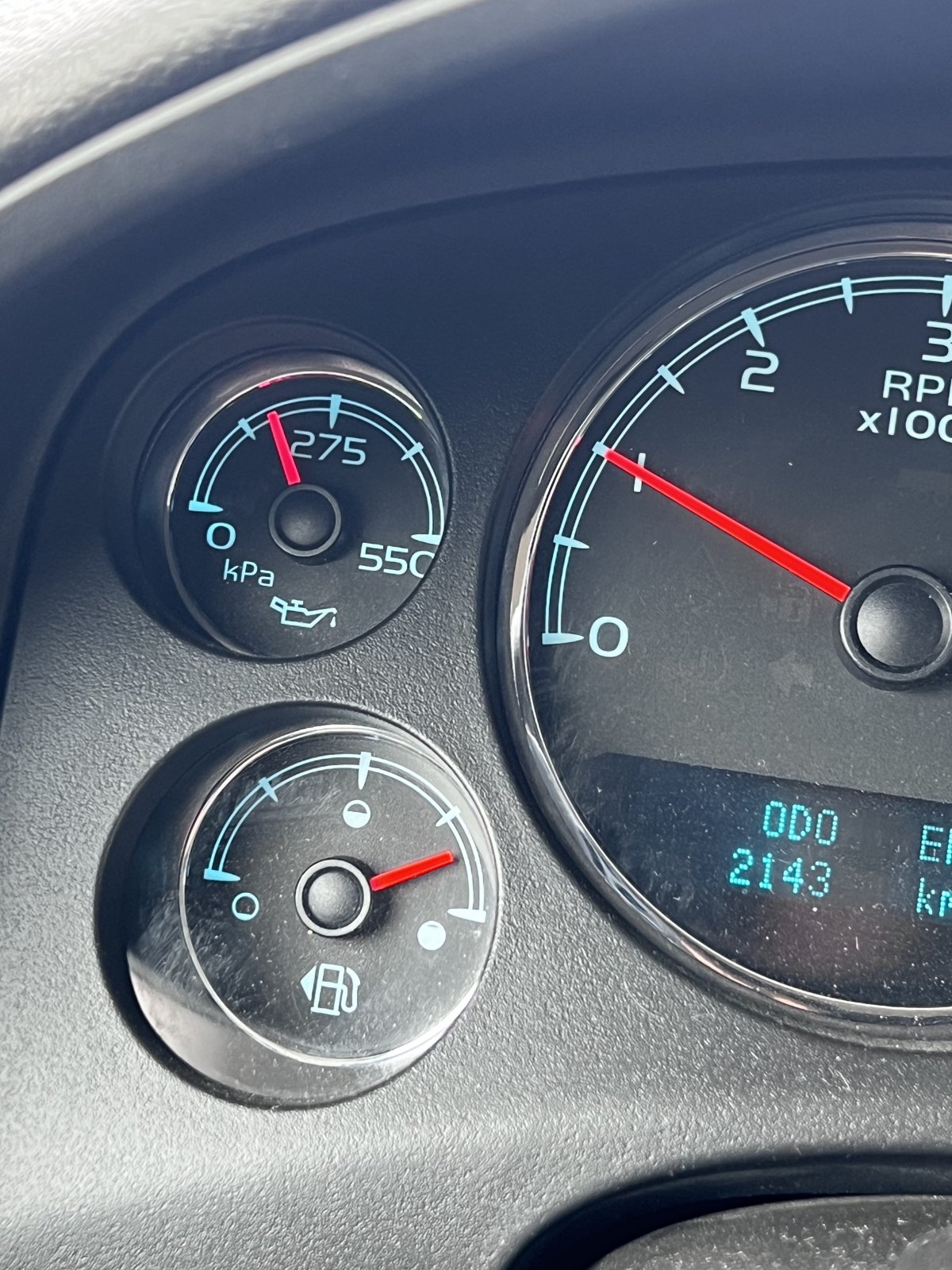

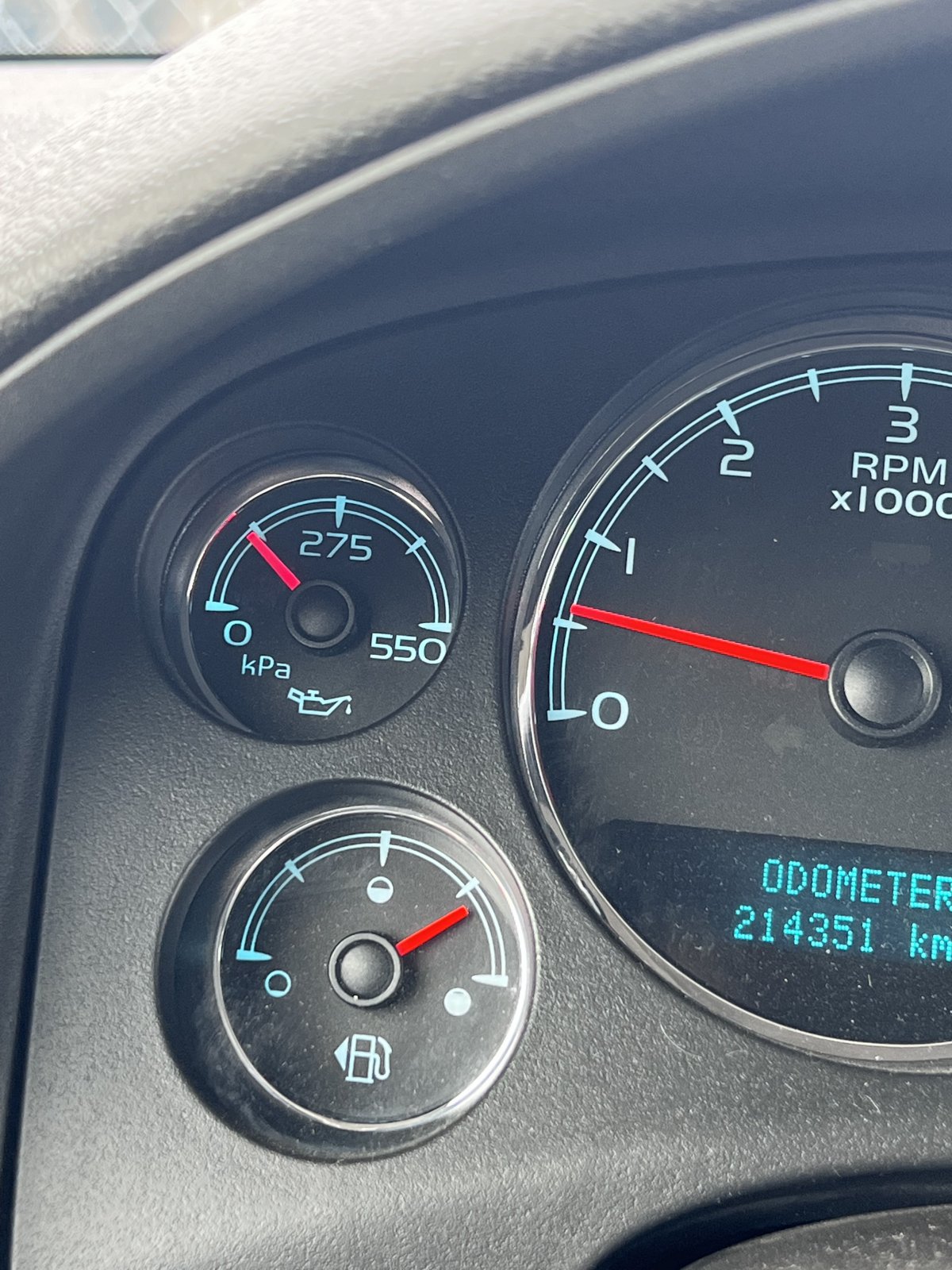

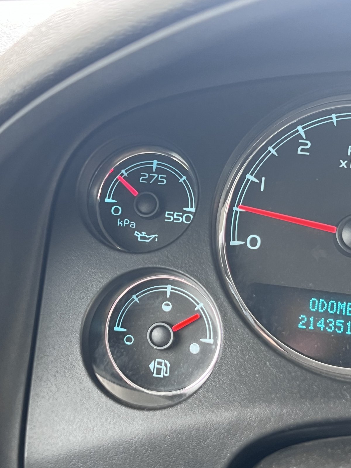

1st pic - idle in gear
2nd pic - idle in parking
3rd pic - cruising at 1000rpm

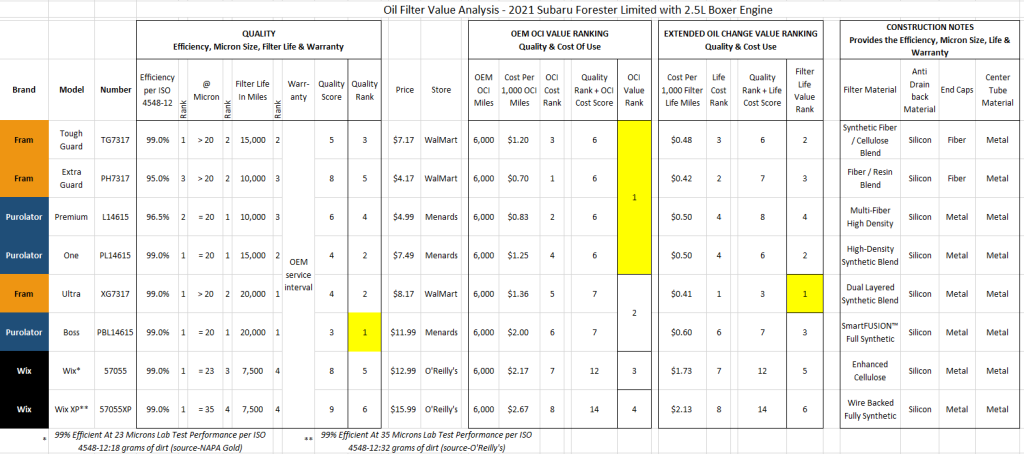

Fram TG filters are 99% efficient @20 microns. Not many filters can say that.
91RS
Nov 15, 2009
2,849
2,299
GA
It doesn't matter, the quality is TRASH. If I offered you a 1000hp car that broke every week vs. a 500hp car that broke twice a year, which would you pick?
donjetman
Oct 22, 2018
1,987
3,642
My vehicles for many yrs have gotten nothing but Fram Ultra and/or Titanium filters. Both are arguably the best filters made. I do used oil analysis. I post the results here. I cut open the filters and post here. Never an issue.
