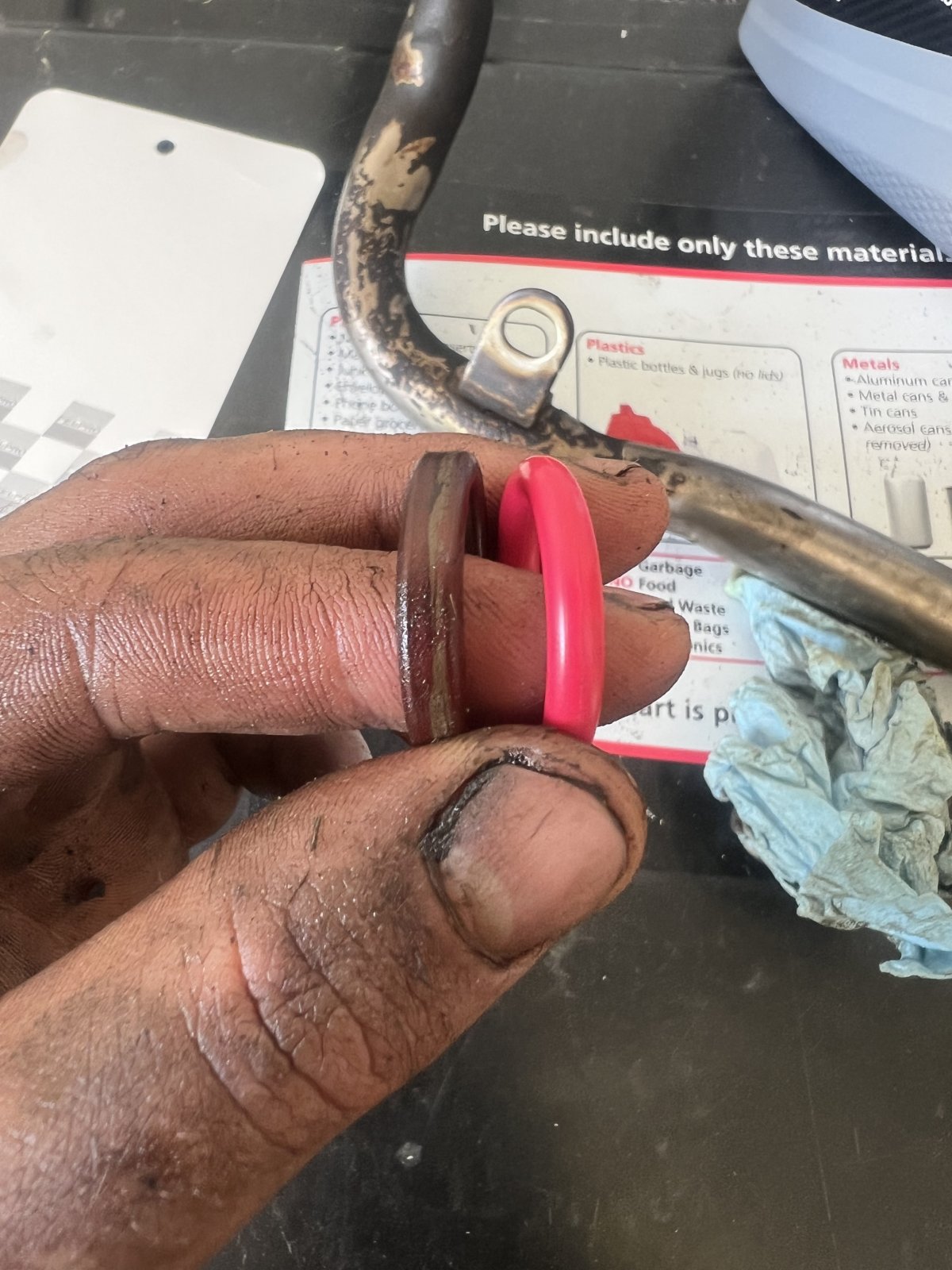

A cheap test many talk about here for the o-ring is parking on a steep incline or jacking up the rear of the truck and putting an extra 2-3 quarts in the crankcase then starting it. This will cover the o-ring/pickup tube. If you do this and it fixes your cold start psi (assuming it’s not oil weight related) then it’s most likely your o-ring. After the test you need to drain the extra out of the crankcase before you drive it again.
Chances are, if the o-ring hasn’t been changed ever, it’s flat, and possibly dried out/cracked and leaking air. This was my o-ring at 200k
You can do the job without dropping the diff. You disconnect the passenger side CV axle and drop the diff and support it with a floor jack. It allows you to get the pan off without taking the diff fully off
