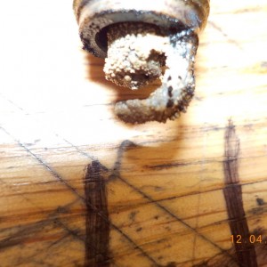

You must be burning it.
In the fall of 2018 our new to us Yukon was leaking and burning 2oz of oil every 100 miles. Here is what all 8 of the spark plugs looked like at 130k miles.

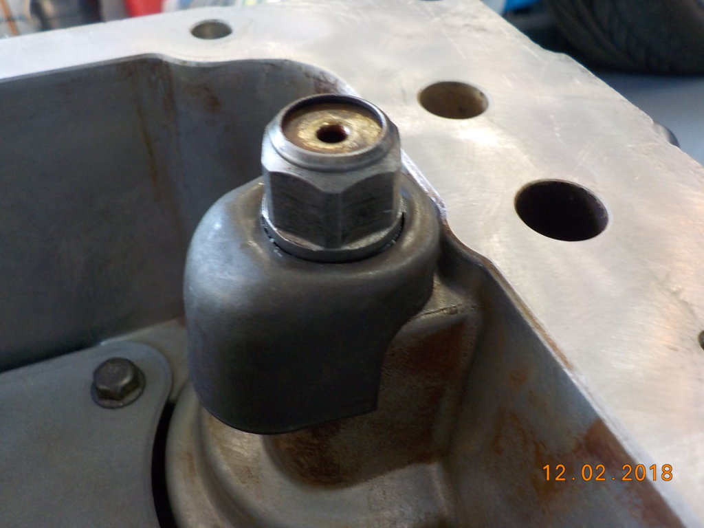

I fixed it. I found out about GM technical service bulletin TSB 10-06-01-008M - So, I installed the new improved valve cover, did a piston/combustion chamber soak (although differently than the way the TSB says to do it) installed deflector on pressure relief valve. It immediately stopped burning and leaking oil.
Now it has 187k miles and is still not consuming any oil.
