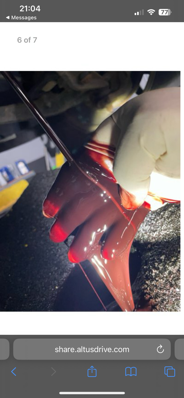

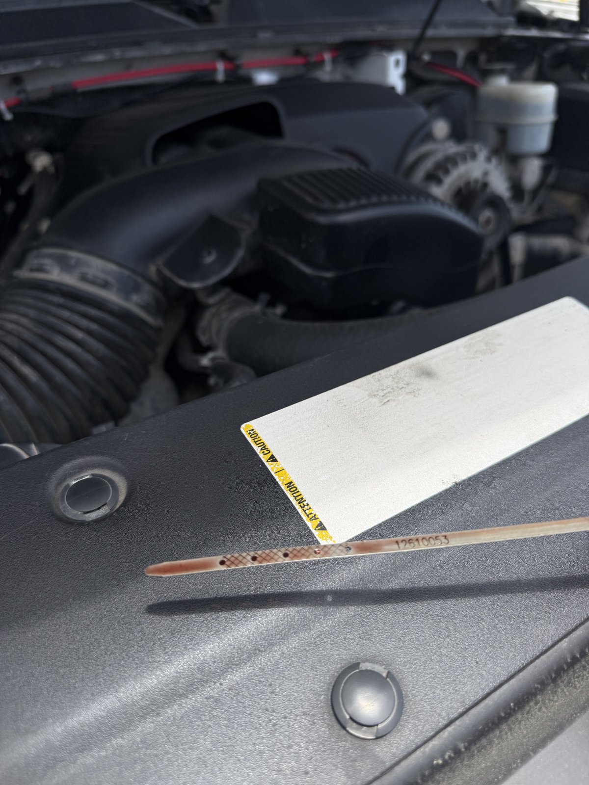

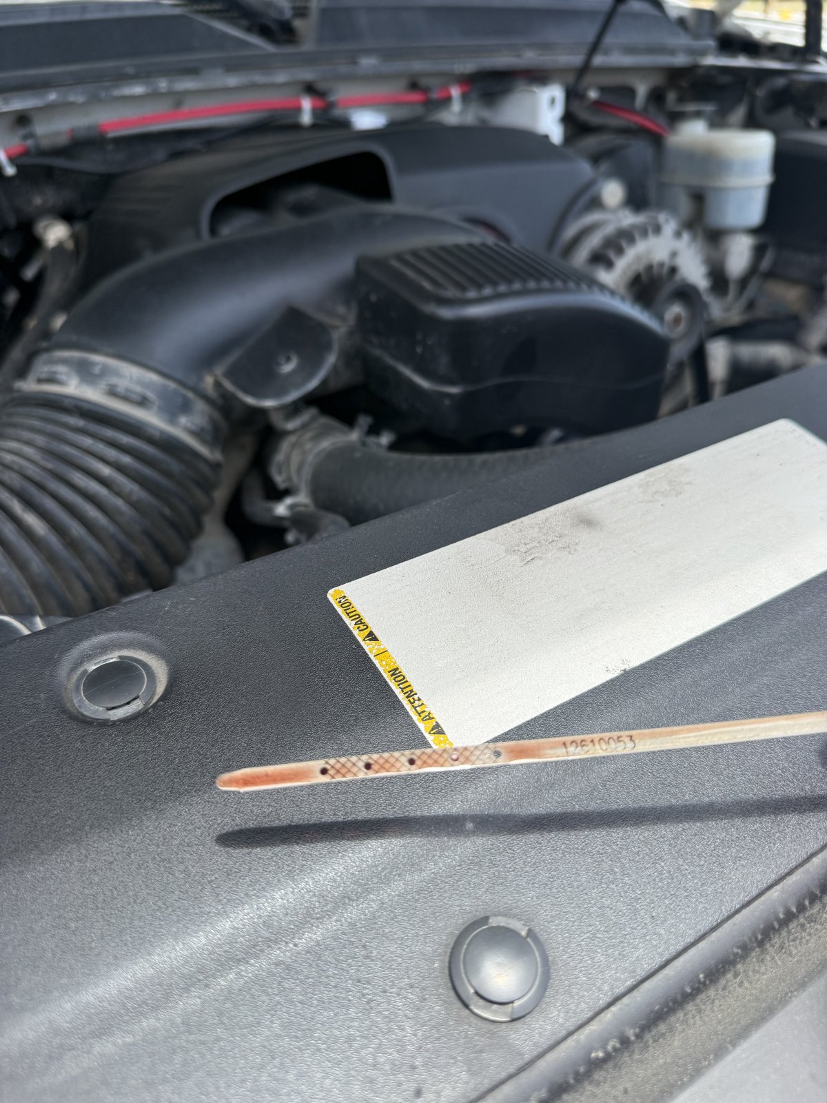

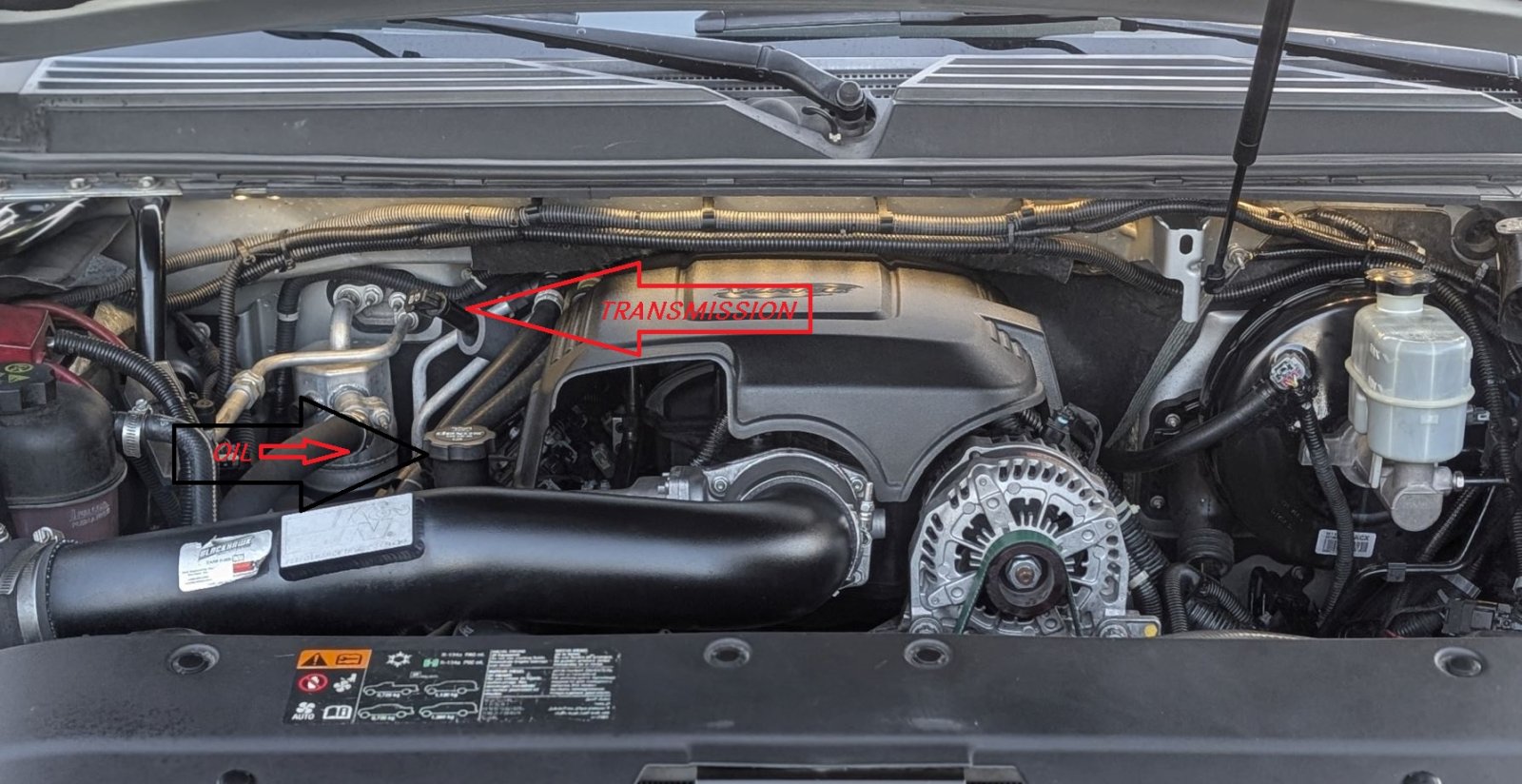

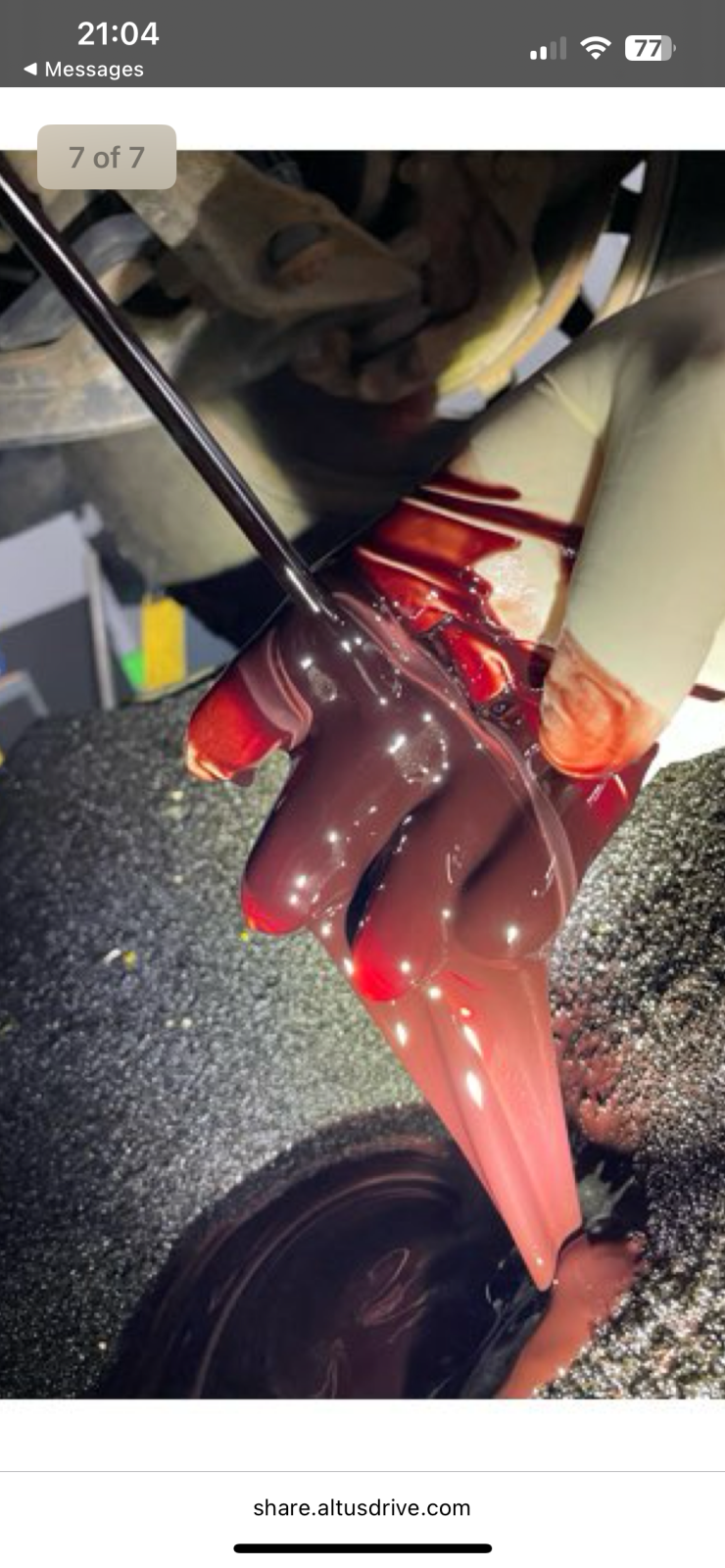

Hello Yukon XL owners,
I have a 2008 GMC Yukon XL 5.3L V8 with 227k miles. About 3,000 miles ago I was at a red light and my dash said to turn off the vehicle immediately because oil pressure was dangerously low. I pulled over and checked oil level which was fine but it he oil dipstick had red fluid on it(presumably ATF). I got it towed to the shop. They said someone had mistakenly added transmission fluid in the oil spout on the engine block(which I did not do). They did an oil change and said come back if you have any further issues. I kept checking the oil every time I filled gas and never saw any red tint on the oil dipstick (just would do drives around town to work etc.) until… Sure enough about 2,000 miles into my oil change I went on a 200 mile road trip and checked the oil dipstick to find red oil. I added 1 quart of oil to the oil spout and 1/4 of a quart of transmission fluid to the Transmission fluid spout. The car drove fine all 200 miles home and back to the shop. Once the shop took another look, they insisted again that I had mistakenly put transmission fluid in the oil spout. Again I did not. Any ideas what could be causing this mix of ATF and Oil and how to fix? I am thinking to replace the Auxiliary Oil/transmission fluid cooler. Open to other ideas. Photos are from the oil change at the shop and the oil dipstick halfway into my road trip.

There's nowhere for them to mix. Other than pouring it directly in the engine.
Oil cooler and transmission cooler are at opposite ends of the radiator. Even if both were leaking inside you have both your engine and transmission with coolant in them.

there is no physical connection of the transmission fluid and engine oil
there is a possibility of coolant mixing with the oil, but that generally makes a milk shake, smoke out the tail pipe. there would be telltale signs under the oil fill cap, looking like nose snot, overheating.
eventually the spark plugs wires would melt and you would look like puff the magic dragon driving down the road.

I have been reading some people saying that sometimes Mobil 1 Extended Life oil can turn red after a couple thousand miles of use. Maybe it is that?
Maybe you get a Used Oil Analysis, then there are no 'maybes' left to wonder & fret over.
Plus the rest of us would all appreciate the DATA as opposed to ... less-than-data.
