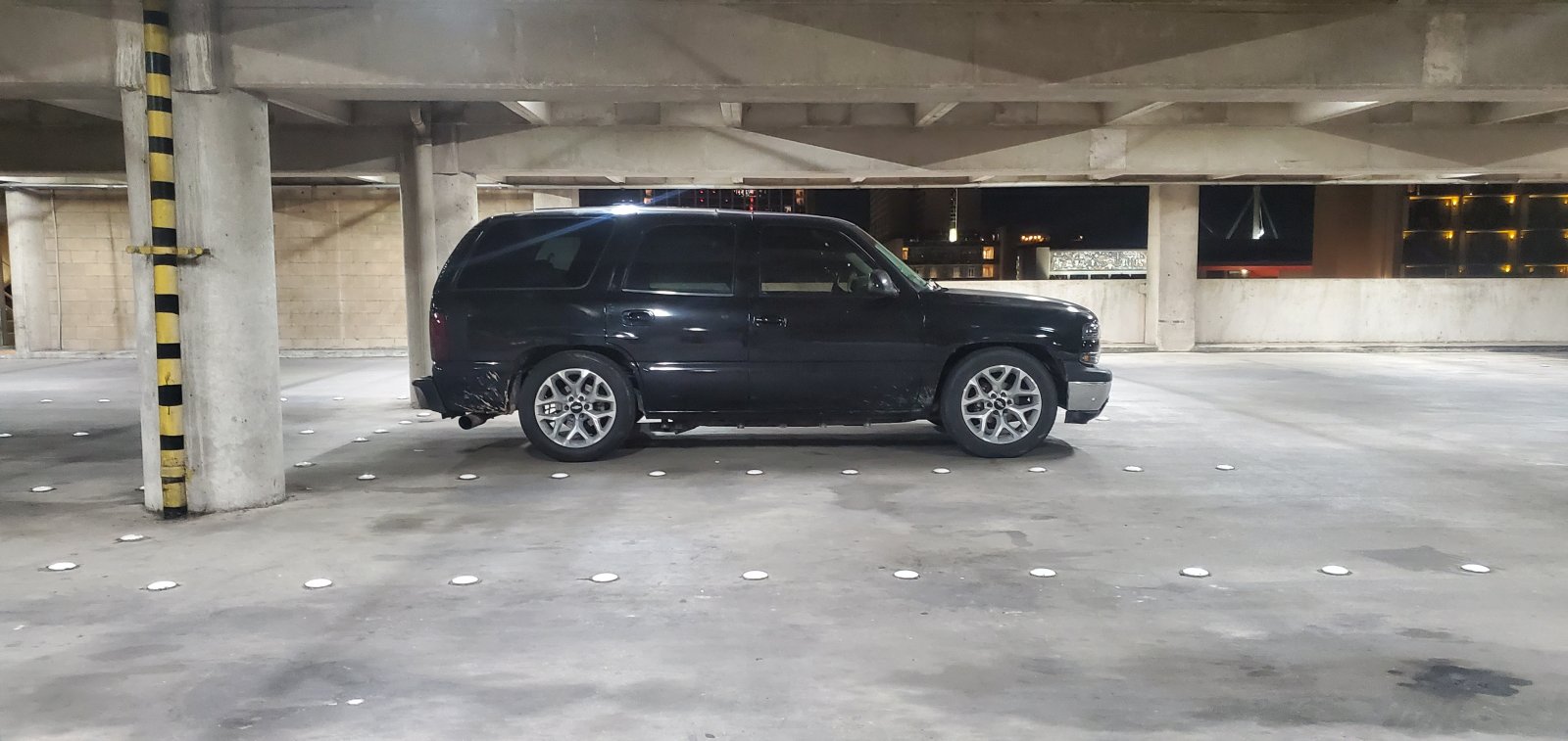

@ridin_low07 that looks great! Judging by your fender to tire clearance (and seeing you have the same size tire) you should be around 30" ground to fender. I "believe" that puts our vehicles at a 3" drop (I can't find reliable stock fender measurements).
Considering you're going lower, I would also recommend the DJM sway bar end links, belltech shock relocation kit, and a Spohn panhard bar. You should also be good on alignment. I did the belltech spindles with stock keys set to 30" from ground to fender and my alignment guy had no problems getting everything in spec.

@BlackedOutHoe i edited my post. Front is at 31.75" and rear is at 33.5". I still need to.do the free travel mod and figure out what jounce stops to run up front. I will look into those tear upgrades tho. Thank you for the advice

Whew you low bro!!! I pulled my front and am running nothing, but I'm also not as low as you are. Free travel mod is a life saver!

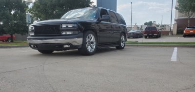

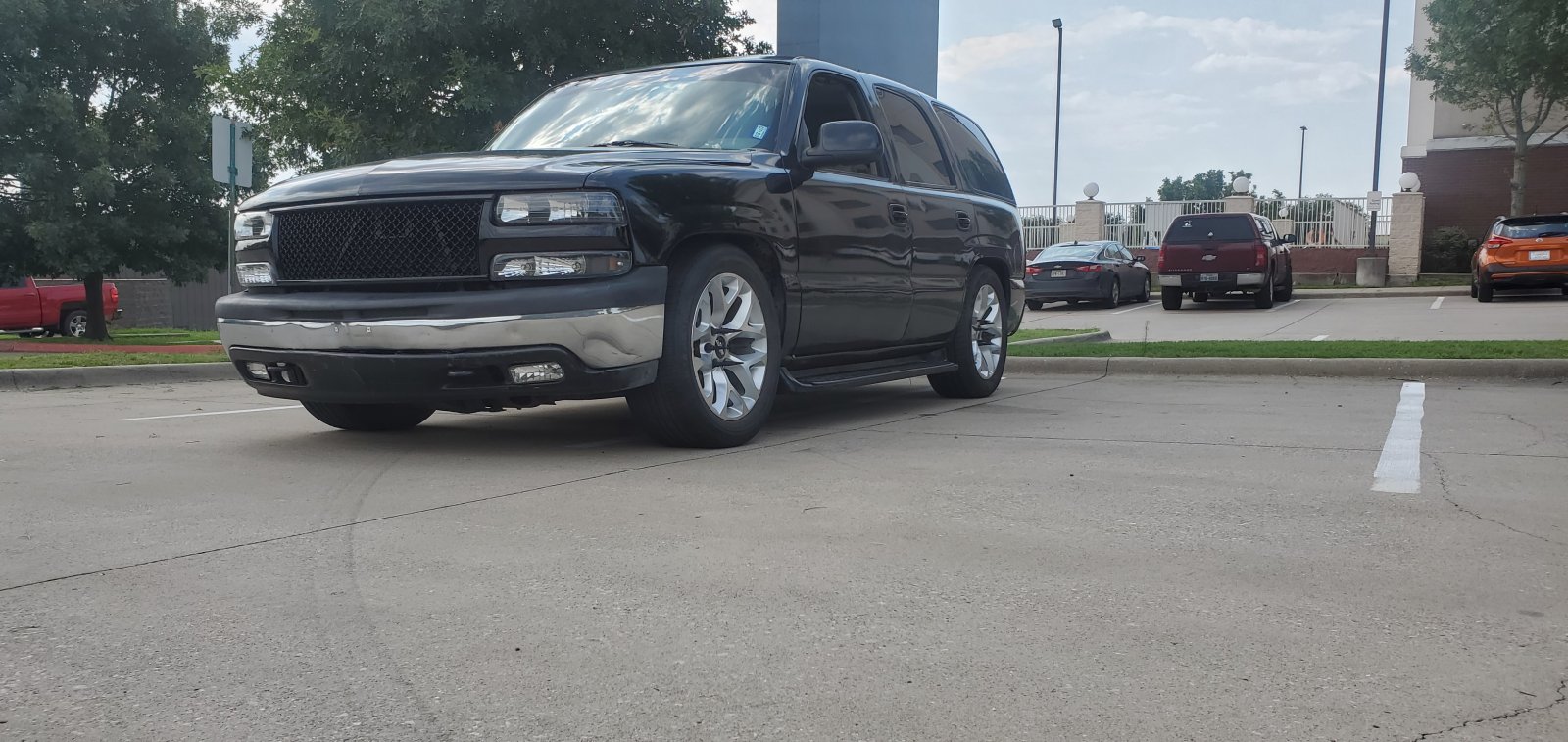

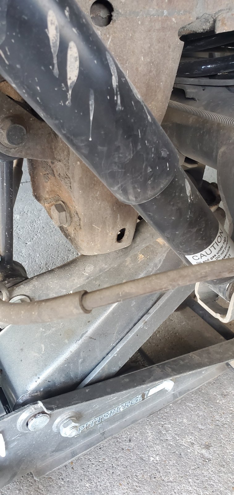

Model/Year/2x/4x/AWD:
- 2001 Tahoe 2wd
Advertised drop:
- 2/4
Fender height front/rear:
-31.75/33
Front:
- LCA's : Stock
- UCA's : Stock
- Spindles : McCaughey
- Sway Bar : Stock
- Tie Rods : Stock
- T-bars : Stock
- T-bar keys : 3/4 Ton Purple Keys
- Shocks : Stock Replacement
- Steering : Stock
Rear:
- UTA : Stock
- LTA : Stock
- Springs : Belltech
- Panhard : Stock
- Sway Bar : Stock
- Shocks : Nitro Drop Shocks
- Air Assist : None
Wheels & Tires:
- Wheels : 20" Snowflakes
- Tires : Cheap 285/55r20
Considered upgrades:
-Need to downsize the tire size a little due to rubbing on big dips and sharper turns. Also need to find an alternative to the front Jounce Bumper bracket as the previous owner cut them off. Also need to find a different rear sway bar end link as its hitting on the passenger side.
Brief impressions of setup:
Not a bad ride overall. A bit shaky as I need to replace my tie rod ends. Otherwise rides pretty well.

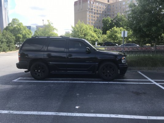

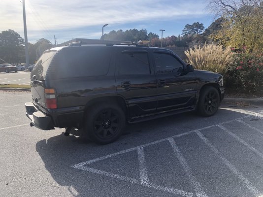

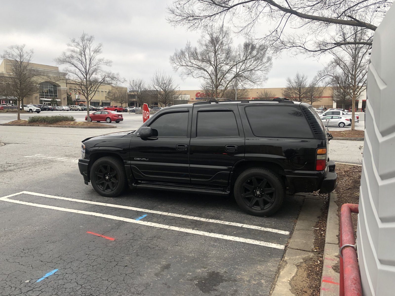

I have an `06 Denali, bought it in May of last year, it has the stock size 275/55R20's on it mounted on some Dick Cepek rims,( I could take or leave them) in fact I just replaced the no name all terrains with Michelin XT's. Ride is amazing now. I think the previous owner turned down the torsion bars in front. I like the front height, but would like it a couple inches lower in back. I do have auto ride. I will eventually, maybe, go to 22's, but for now I like the ride I have. I do plan to add HD sway bars front and rear as well.
Any suggestions as to lower the rear a bit without spending thousands?
I know I will need some airbags to tow anything over about 1500 lbs.

It may have settled a little bit since, still a touch higher in the back. Once I wear out these expensive Michelins, I'll drop it proper and do some 22's.

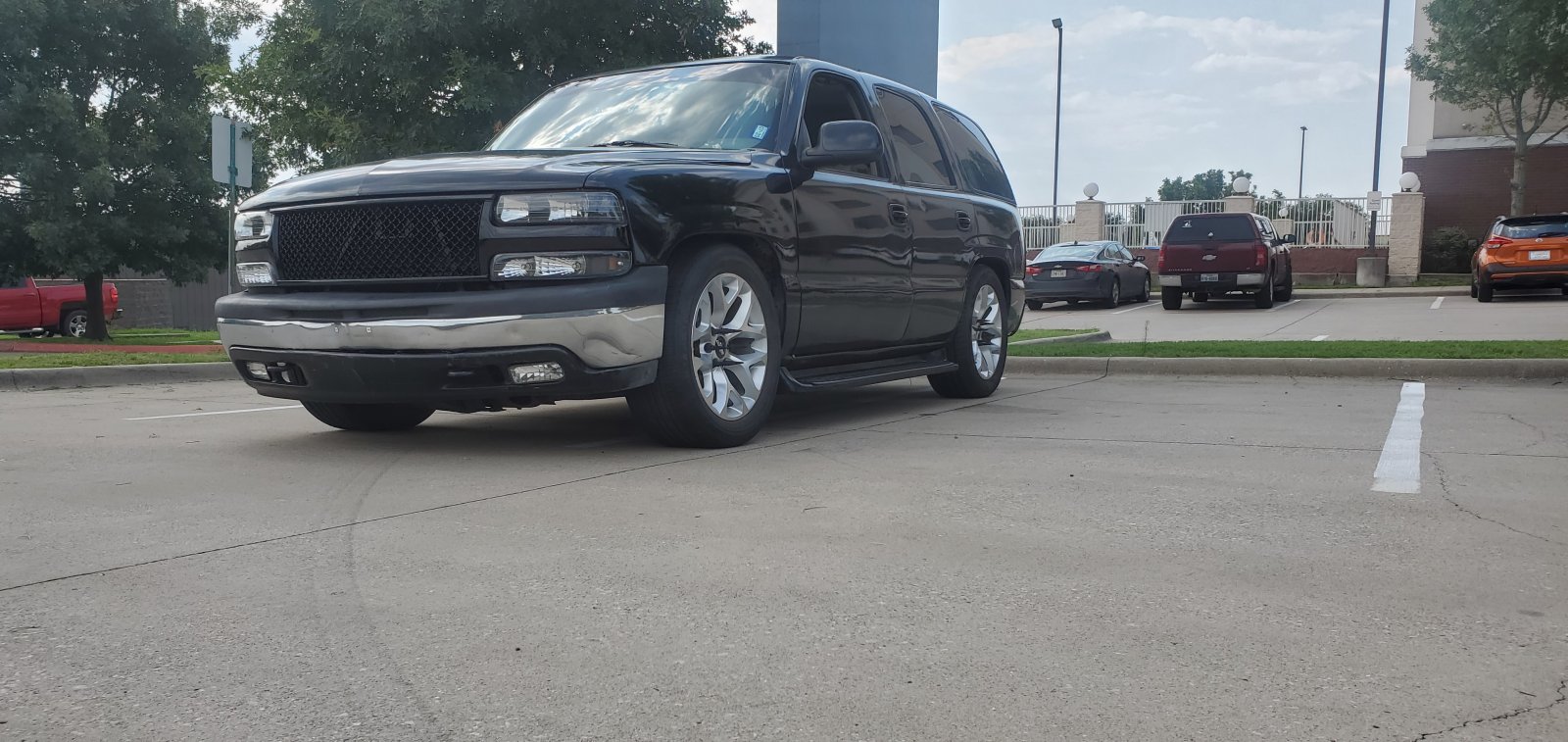

- 2001 Tahoe 2wd
Advertised drop:
- 2/4
-31.75/33
Front:
- LCA's : Stock
- UCA's : Stock
- Sway Bar : Stock
- Tie Rods : Stock
- T-bars : Stock
- Steering : Stock
Rear:
- UTA : Stock
- LTA : Stock
- Panhard : Stock
- Sway Bar : Stock
- Air Assist : None
Wheels & Tires:
View attachment 254696 View attachment 254697 View attachment 254698 View attachment 254699 View attachment 254700
How much did you turn your front keys down? Or were they a preset amount?

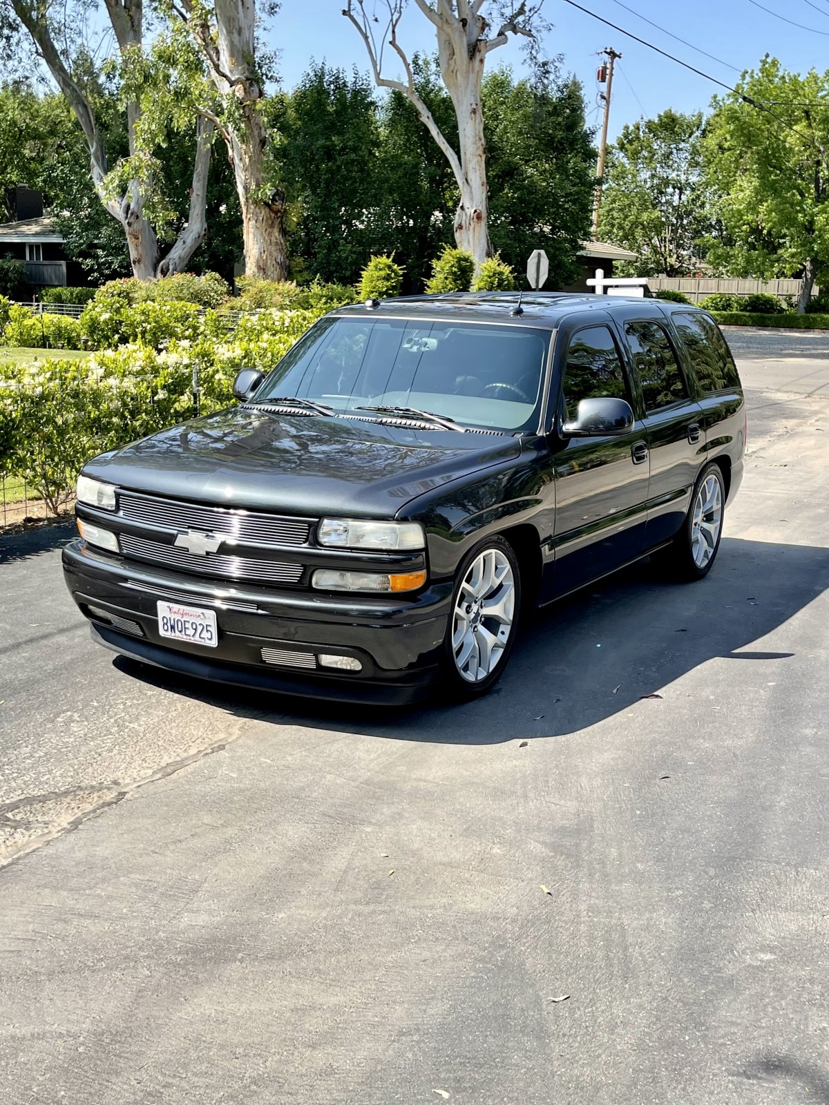

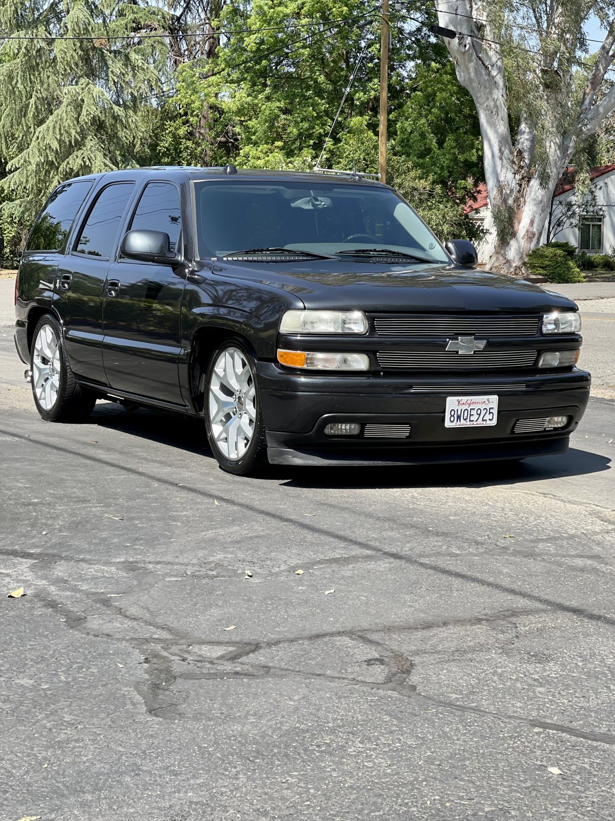

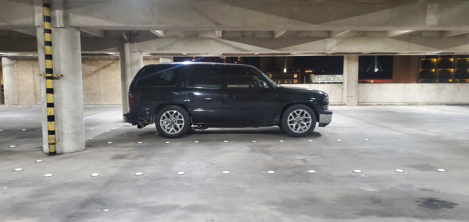

Figured I’d post. I never do and have been on here for like 11 years or something. I posted a couple weeks ago in exterior looking for help with headlights. Didn’t get much of a response. Long story short. The town I’m from has a bunch of aftermarket companies and I’ve gone to school and or have grown up with just about all (Whipple, McGaughy, Belltech, Speed Engineering, Full Throttle, Stone Fab, Western Chassis) to name a few. So me and my boys have been doing SEMA and show trucks since the 90’s. This Tahoe was bought new by me with the intention to make it a SEMA project. We ended up going a different direction and did a different new truck. So this Tahoe just sat for years. I let my buddies grandma drive it. It now has around just under 50k miles. I saw it sitting out at my shop and decided to start messing with it.

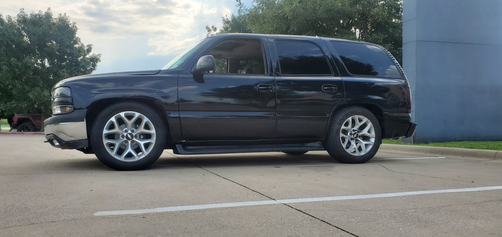

- 2005 Tahoe LT
Advertised drop:
- low / Tony’s 6” springs
- have never measured
Front:
- LCA's : Custom tubular Stone Fab Coilover Kit
- UCA's : Custom tubular Stone Fab Coilover Kit
- Spindles : Stock
- Sway Bar : Belltech
- Tie Rods : Custom hiem joint Stone Fab Coilover Kit
- T-bars : None
- T-bar keys : None
- Shocks : QA1 double adjustable Coilover
- Steering : New center section, HD hooked to Hiems
Rear:
- UTA : Spohn Adjustable with Del-Sphere
- LTA : Spohn Adjustable with Del-Sphere
- Springs : NorCal 6”
- Panhard : Spohn Adjustable with Del-Sphere
- Sway Bar : Belltech along with the offset dog bones
- Shocks : QA1 dual adjustable
- Air Assist : None
Wheels & Tires:
- Wheels : 22" Snowflakes
- Tires : Nitto 275/40R22
- Nope. I have billets floating everywhere in my shop. I’ve put so many sets on and for some reason keep going back to the wheels on it. Did a bunch of motor / performance. Building (2) 2 door 2wd right now so prob just mess with those and some of my other trucks.
Great kit rides great. Never had any bumpsteer. Handles like on rails (for a brick).
I need to update the pics. Rear appliqué are SS smooth painted, the hatch is the other type with no handle or plastic on top and it has SS painted smooth wiper cowl. Still need help with headlights.
