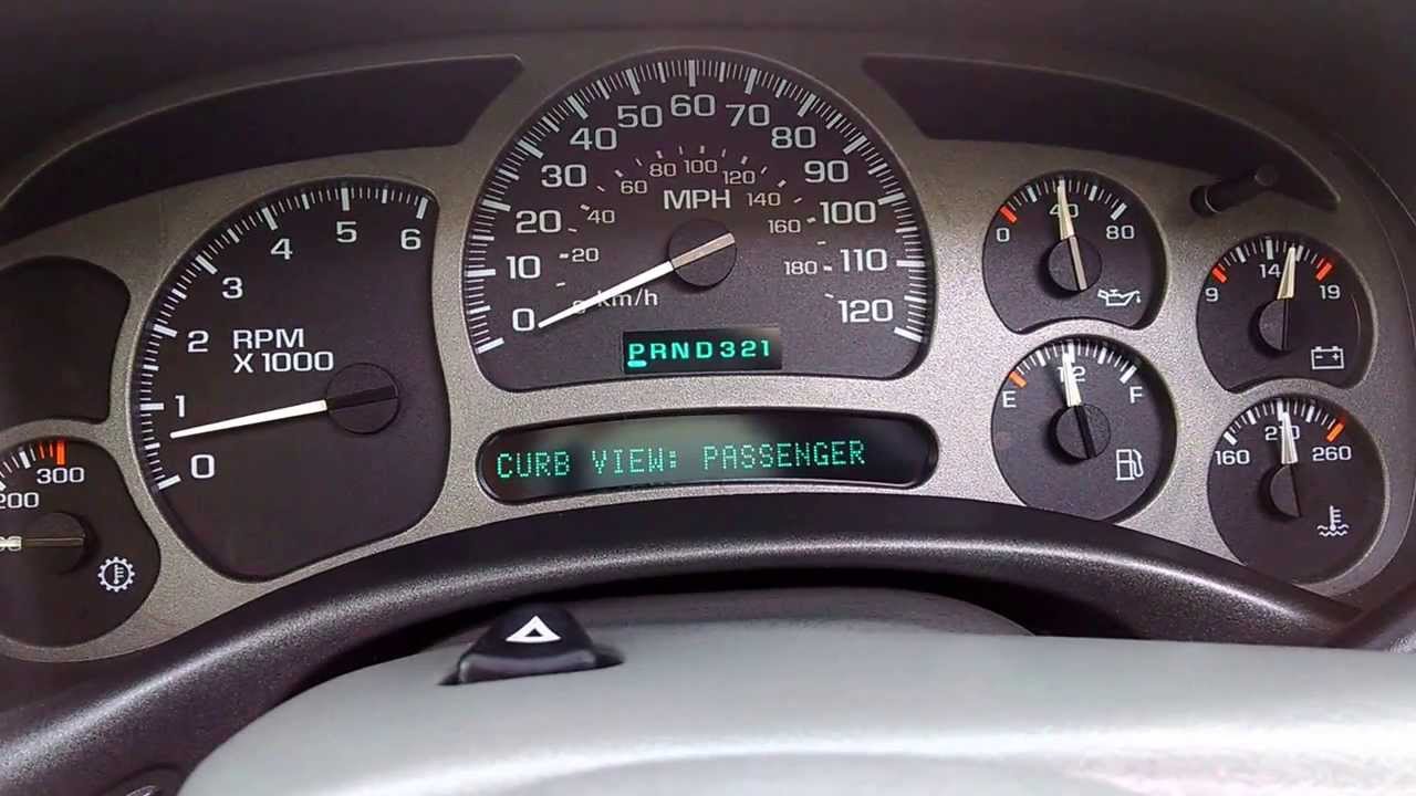

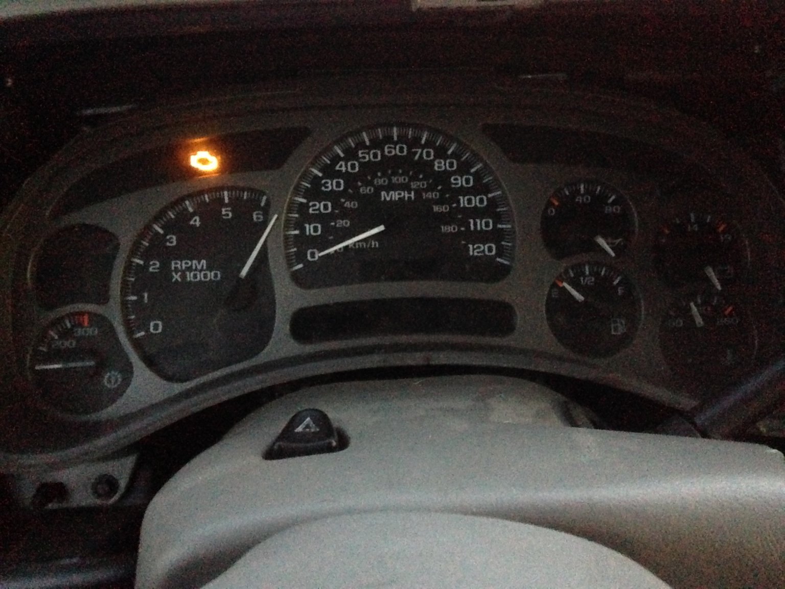

I just repaired my 2004 Denali cluster! It's the same as yours... my cluster had 2 of 7 working gauges and 3 of 12 working backlight bulbs. I'm only a college student and car enthusiast and I tackled it this weekend. I'm confident anybody could do it! I used this kit off of eBay with the latest "GM approved" steppers and more....
http://www.ebay.com/itm/like/171410...7290-0%26rvr_id%3D1164579530115&ul_noapp=true
Pulling the cluster out is very simple and the kit comes with everything you need including very simple instructions! Cost me under $30 and an hour or two. My parents and I were impressed hahaha. Let me know if you need any help!
Project Denali
Nov 30, 2016
148
150
Went from this:
To this:
