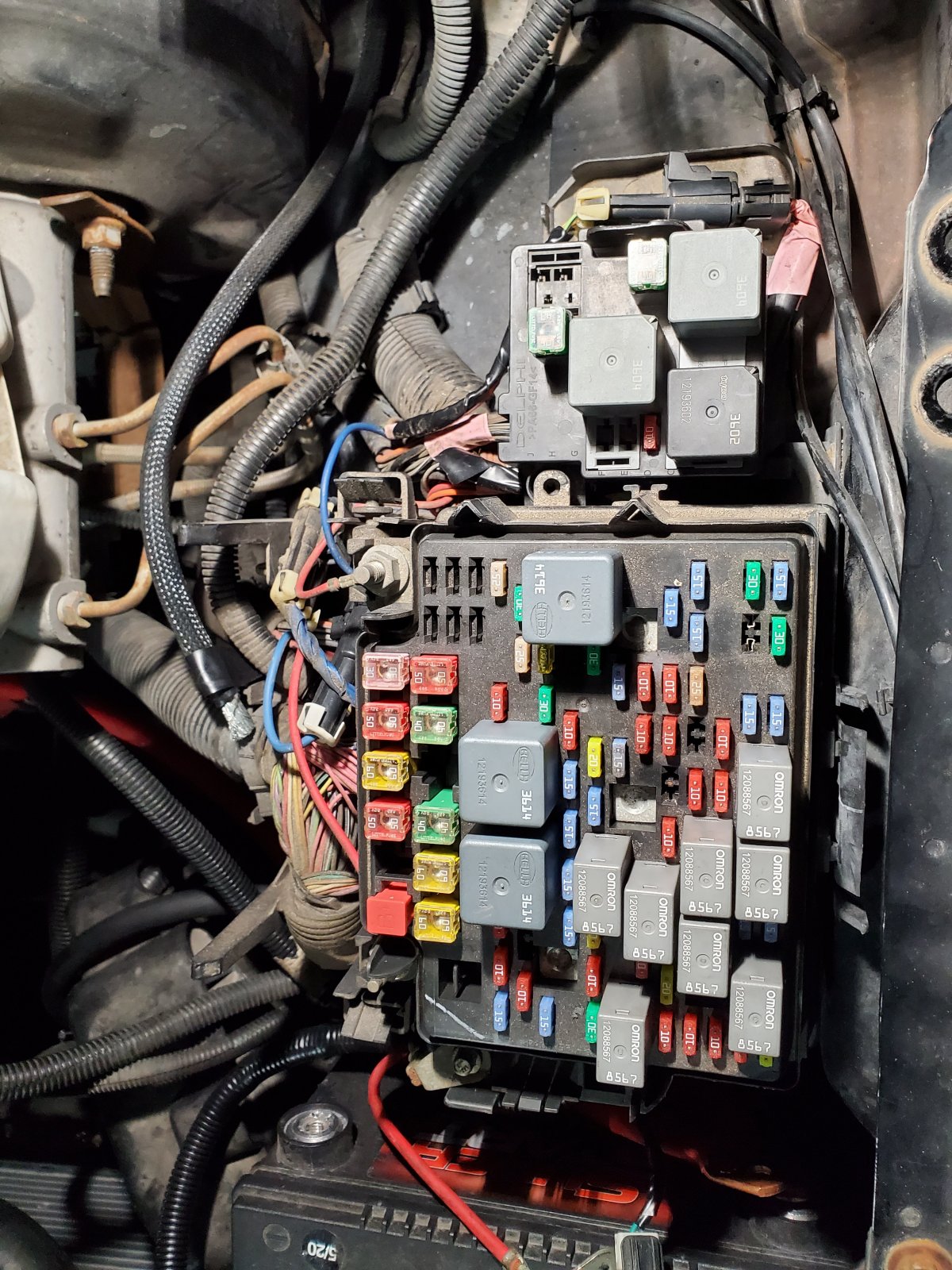

When replacing the headlights with LEDs did you consider also adding a headlight full light module so that all lights are on with the high beams? Amazon has them.
A lot of replacement parts over the years for sure. I haven't kept track except for the big ticket items. I'd say over 14 years I have easily spent over 20k.
I actually recently saw that all lights on relay panel and will be picking one up soon.

That’s the exact one I installed on my Tahoe. It works flawlessly.
