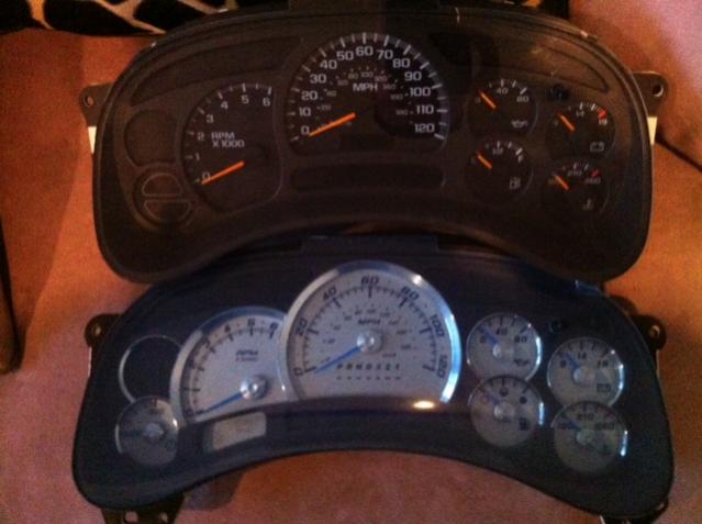

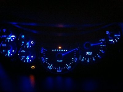

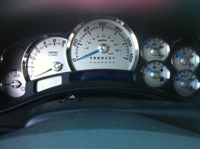

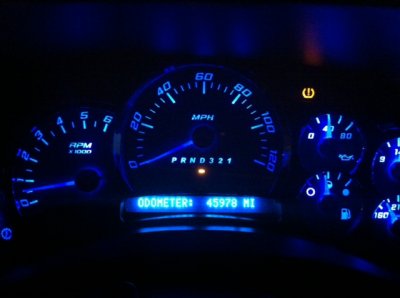

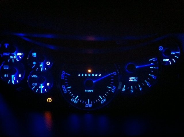

Hey DenaliAK, I just bought a new Escalade cluster (silver face w/blue led's) for my '04 Yukon off Ebay (probably the guy you're talking about) about 2 months ago. I am 100% satisfied. Paid $400, but worth every penny. I had to pay the deposit, but I sent them back my old cluster right away so it was refunded within 3 days.
Install was 10 min, plug and play. It upgrades the whole look of the interior. One of my fav. mods by far. I'll try and take some photos and post in the morning.

Ok, here are some photos.
