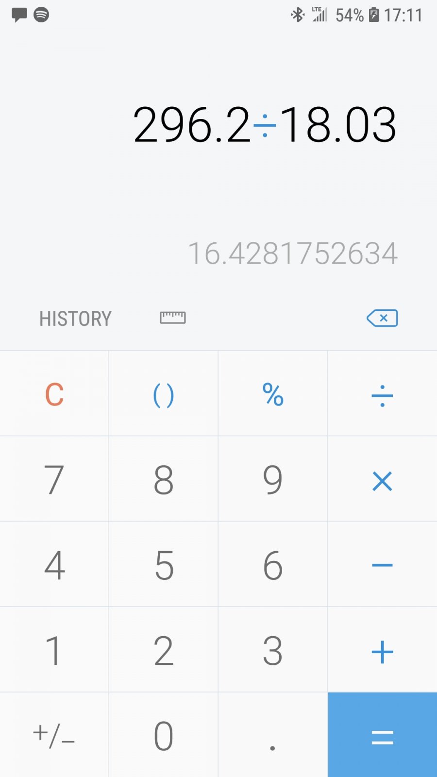

Managed to get a good long highway run without a trailer to give you an estimate on MPG. Went to Cleetus and Cars in Bradenton and held 70-75 the entire time, with minimal to no traffic and 93oct which is all it ever gets. I used to be able to manage 18+ on the highway with the smaller cam do that's definitely something to consider.

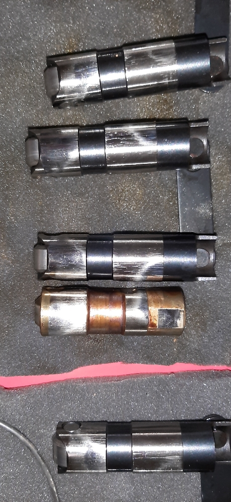

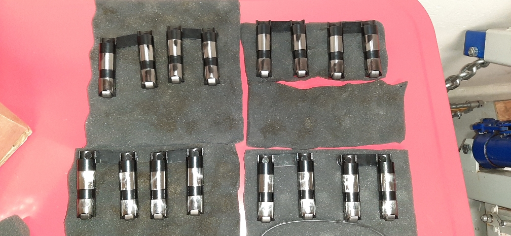

Lifters are in. These make the factory ones look a bit chinsey. They are the 2116LSR johnsons. I opted for a link bar instead of the plastic trays and LS7 design. They made a cheaper non linkbar verson of these but I found a deal on these. they are lightly used so wish me luck :|
