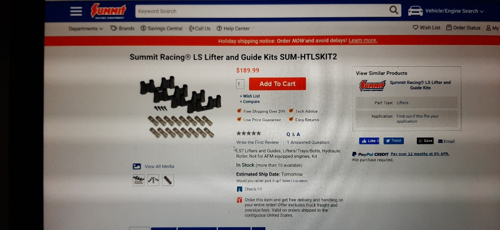

speaking of being cheap. summit has cheapest LS7 style lifters in house brand. Not sure who makes these... it maybe they are a name brand just private labeled. or if I steer clear.

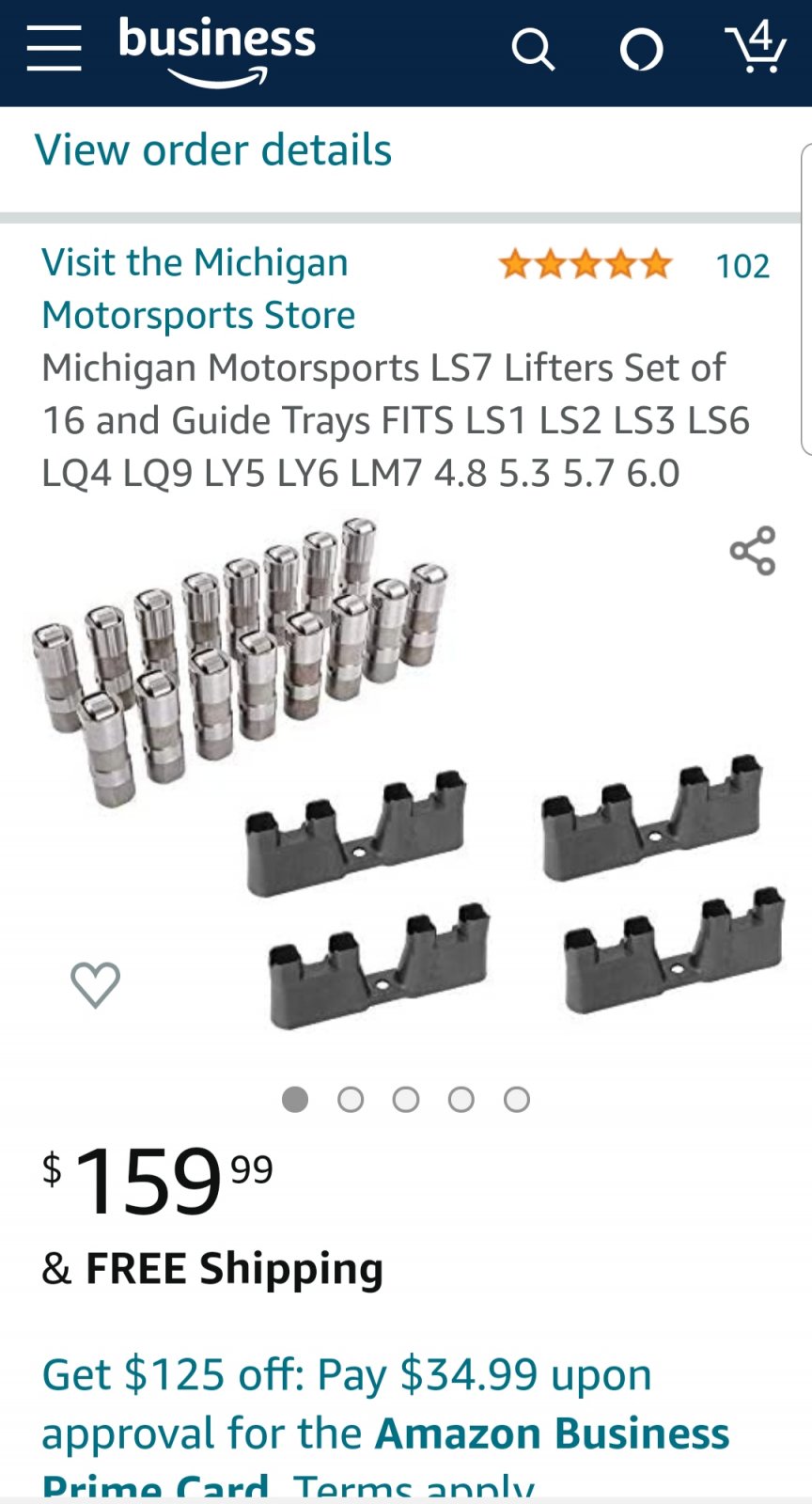

Okay now I am probablybbn overthinking this haha... so I studied theblifter failures.
First the plastic guides are required to keep the lifter from spinning. I don't recall how my LT1 managed that...
I have found several examples on Youtube of ppl who had a lifter spin, it spun because guides broke. I would think this is the main cause of failure?
I wonder how long those lifters last with the link between them? I imagine very luttle oil gets on those linkages... Maybe plastic holds up longer?
Sent from my SM-A505U using Tapatalk

These seem to be the top shelf lifters haha Johnson 2110 Drop in lifters. They have larger roller, tighter manufacturing tolerances, and less susceptible to lifter knock, but are $$$$. HERE
No I remember on my LT1 they had a metal guide that went over the top of the lifter instead of the plastic trays that go in LS. Kind of spooky with a plastic part in the motor ?

I thought the plastic lifter trays were an awful idea when I first saw them but I've disassembled a few high mile LSs now and haven't seen any issues with the trays in any of them. Although I do change them every time in case me messing with them has caused the old likely brittle plastic to have micro cracks.
