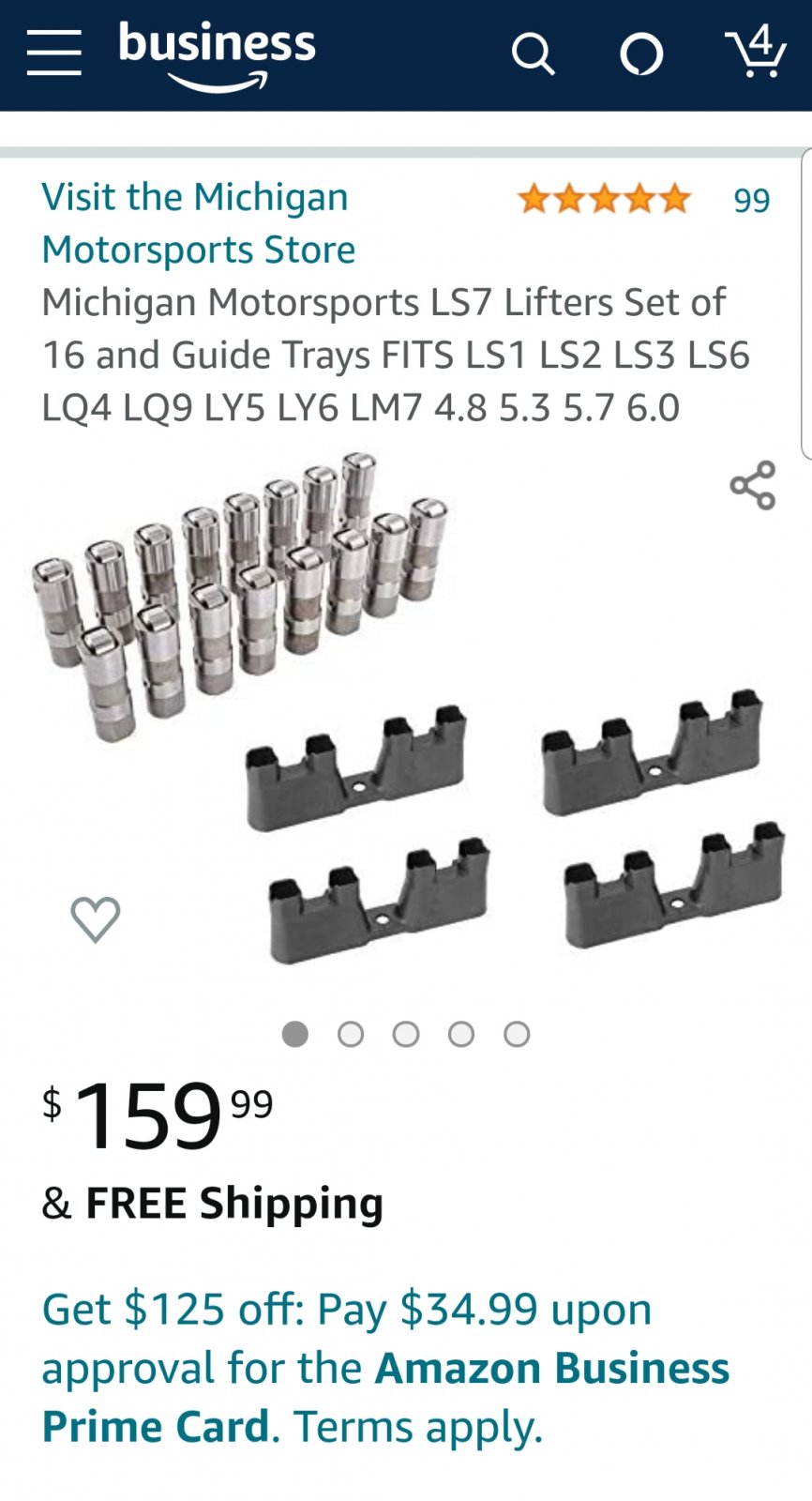

I am building the motor. Bought the block from an engine builder. He recommended a lifter but unsure which one it was. Do you know what lifters you used?

I bought Michigan Motorsport
https://www.amazon.com/dp/B07G8M28BG/ref=cm_sw_r_cp_apa_i_WamSFbV8VTADJ?_encoding=UTF8&psc=1

I used Morel 6504 drop-in lifters when I replaced my Castech heads this summer. Mainly because they were the only ones I could source at the time and had good reviews. The LS7's were back ordered everywhere.
Morel seems to be the talk of much discussion on the various forums. I just pulled the trigger and ordered a set of Morel LS7 style lifters. They weren't cheap, $300 w/ taxes :| Still cheaper than the Johnson lifters that were like easily that for a couple lifters haha. But I suppose if I'm going to build it I better build it right the first time ;) THanks!
I'd have LOVED to get those linked lifters but then I suppose they wouldn't have worked with the LS trays :/
Also spoke with my buddy who used to build these trucks for GM. He said the Delphi lifters are complete crap. To avoid them at all costs.

Ah $hit! Stupid eBay. I thankfully looked this up but appears they have already shipped the lifters out. The seller of the Morel's never put any specs on the lifter other than LS7. This seems really ridiculous however, the manufacturer's spec says a max cam lift of 0.360" for this lifter. I ordered the Morel 6504. The LQ4 cam has over 0.4" lift alone :/
https://img1.wsimg.com/blobby/go/7b0d6703-02c7-4d7c-834a-da872ff630ae/downloads/1d2gcttrg_741047.pdf
I also see when I google this part number now, they can be had for $200 :(

Surely that can't be correct? They're advertised as drop-ins and every stock LS cam I've just looked up is more than .360". Most "low lift" cams are .500"+. I've got them in my L59 and have a thousand miles on them. They're said to be very close to stock size so as to not have to mess with preload. I used my stock pushrods.
I paid $249 in June because it was the only place I could find them and I wanted the truck back together....turns out, I could have waited because one of the refurb heads developed a crack in less than 500 miles.
