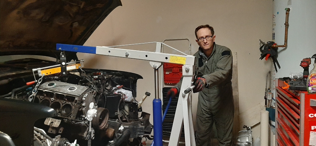

I huffed, and I puffed, and this came out...
Now I might have got ahead of myself. I need to get the harmonic balancer bolt out [emoji51] As much as I hate to admit, I pulled out the impact and no dice. Those are really on tight.

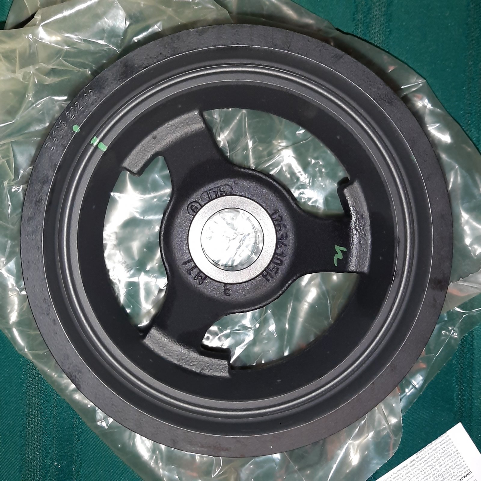

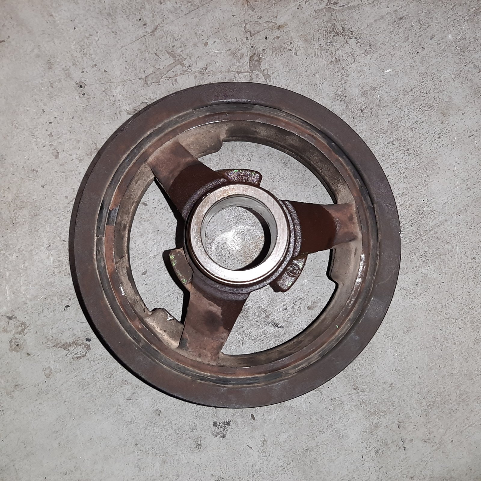

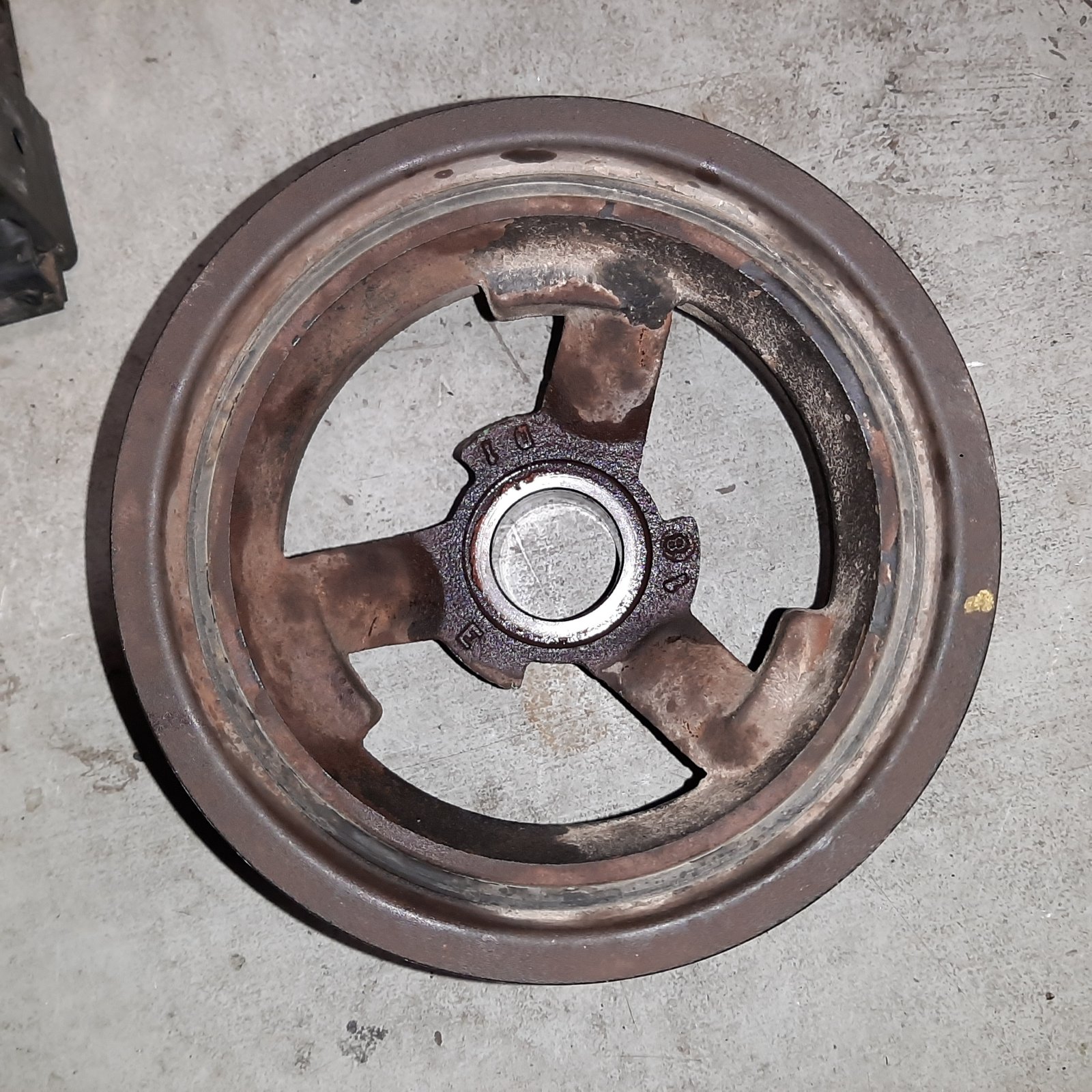

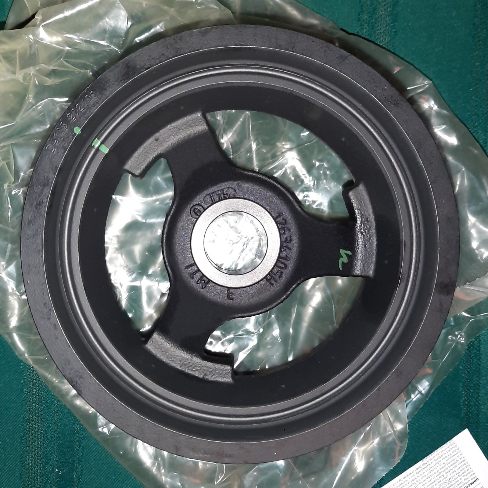

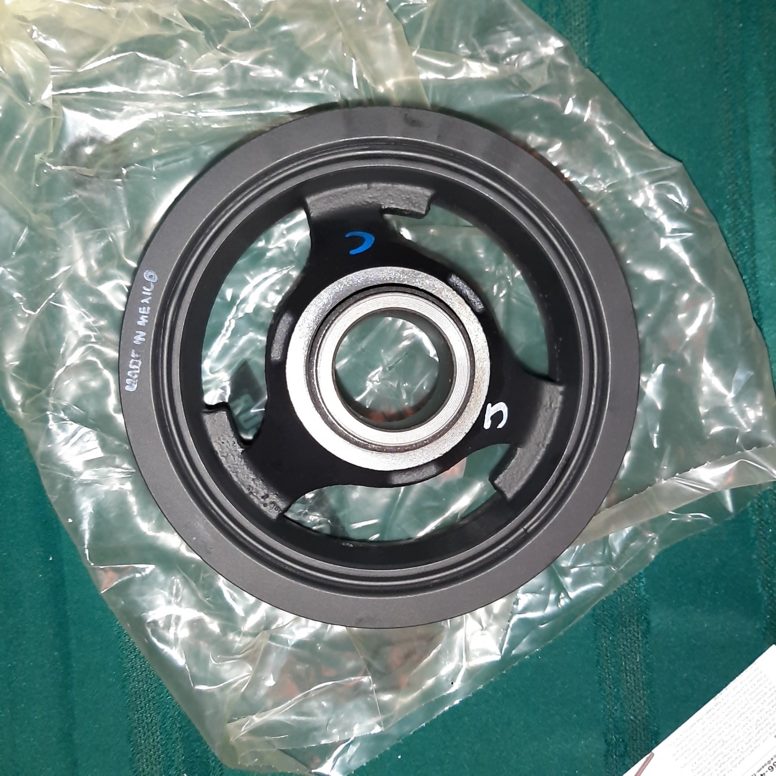

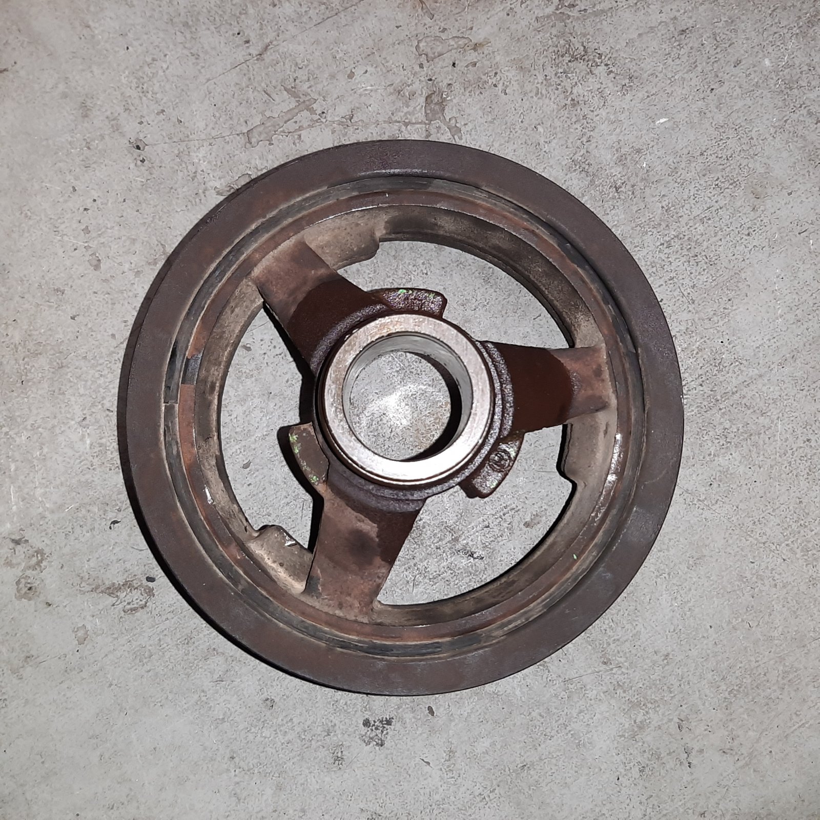

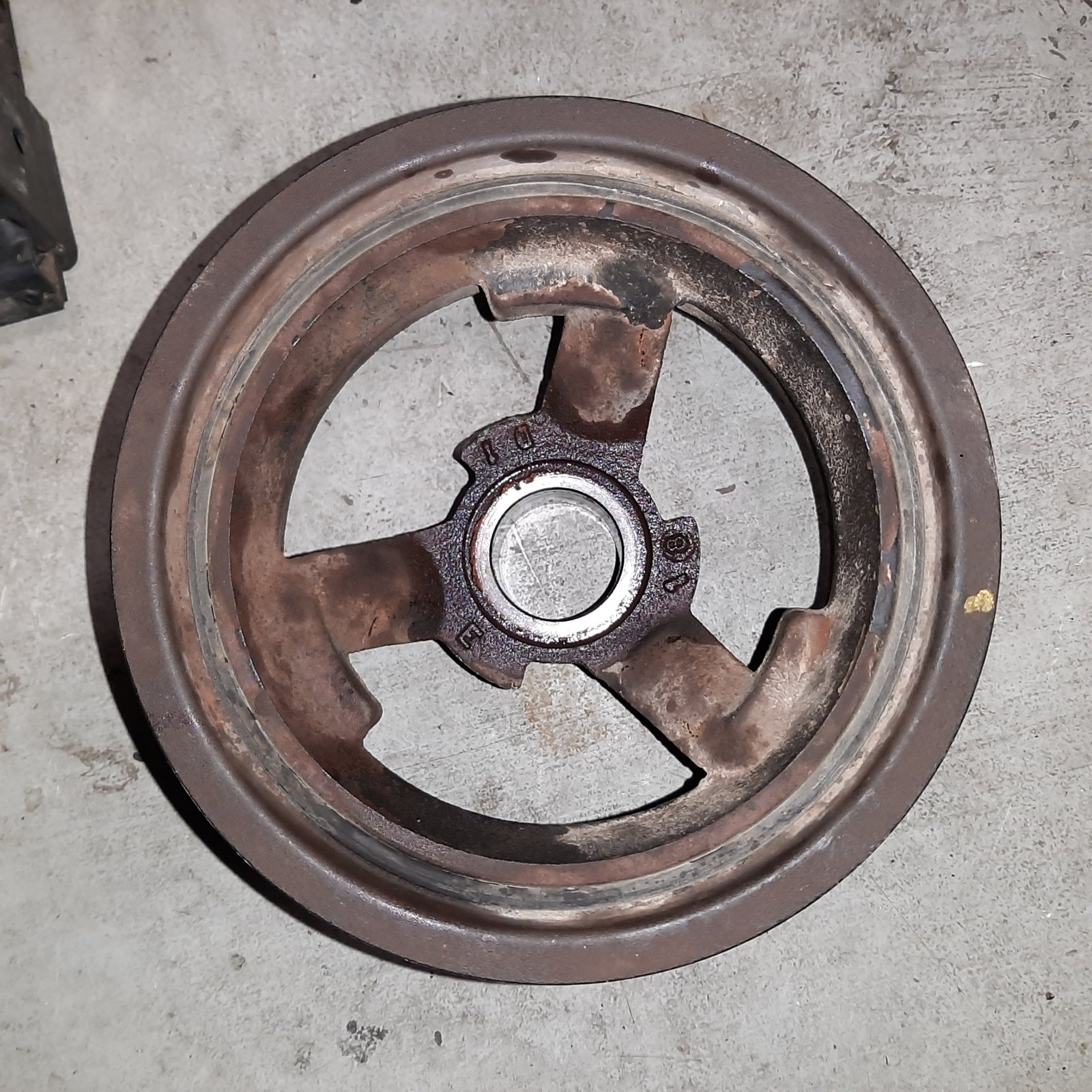

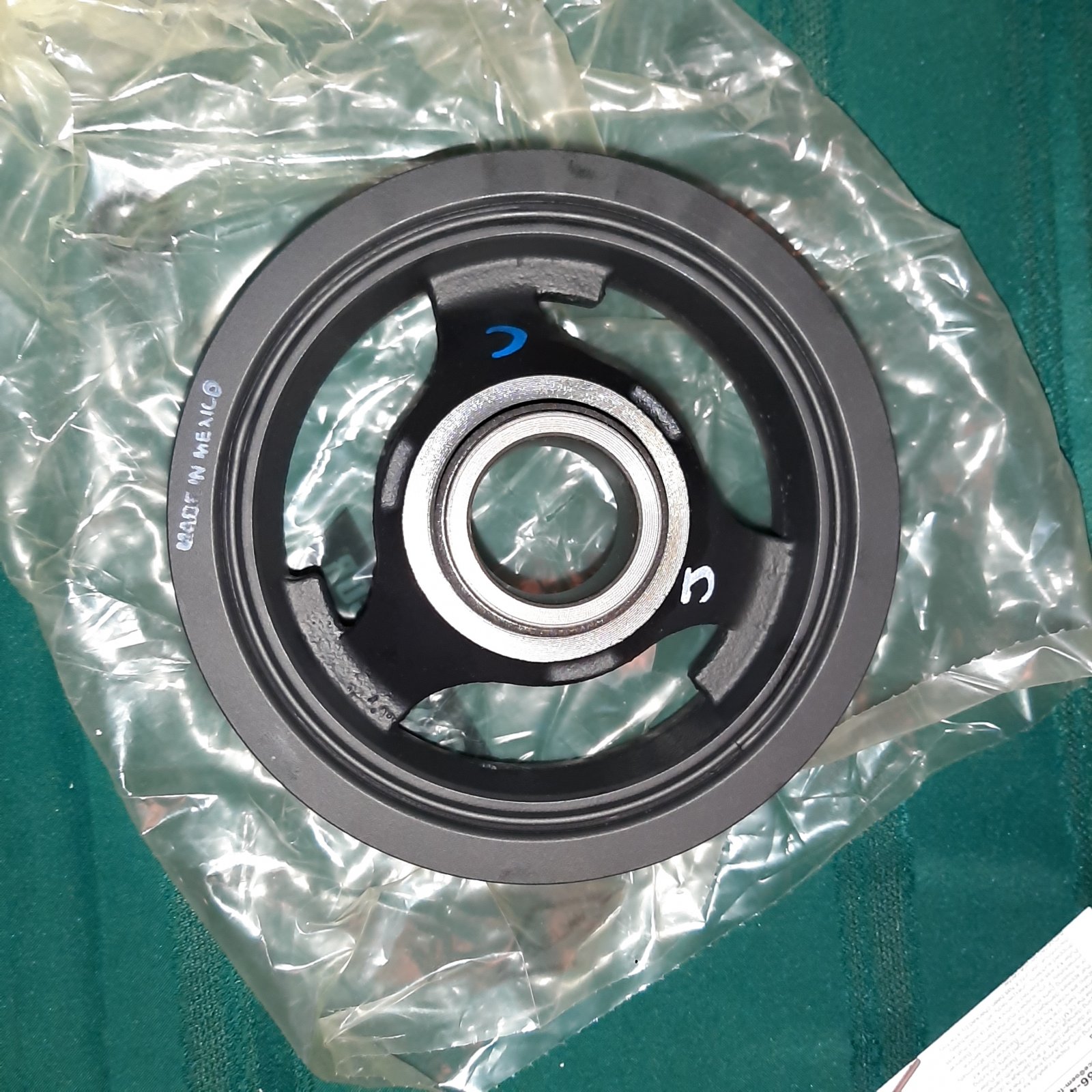

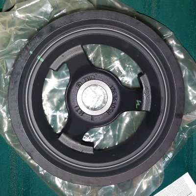

Minor annoyance here. I got the harmonic balancer off the old motor. Got a new one from Amazon returns. I think the new one will work, however...
Box and part I ordered say one part number, 19300488 HERE
They sent me another part number but seems to cross reference, 12634105 HERE, cross referenced HERE
UPDATE: Seems this gets even more complicated. The 19300488 doesn't reference back on GM Parts Direct before 2003. There doesn't seem to be a part number for the damper for the year 2001 there. However, I found this damper on Amazon that does mate up with my crank but nothing in a 6.0 build HERE So I took and compared the part number 1930048 (really 12634105 I think is Dorman's version). It appears to have exact same outside dimensions and weight just is a bit different casting. Geese, appears GM stopped making the older casting / harmonic balancers but hasn't updated older parts catalogs?
UPDATE 2: I'm searching the 12634105, seems GM changed the casting # on the puller HERE. Older version is the 12634105 which I'm finding in some parts catalogs references back to 1999 trucks. So I'm keeping what they sent me.

What impact do you have? My M18 Milwaukee 1/2 extra torque model zipped 2 crank bolts right out so far. My porter cable failed though.

I hope you got this out of your system now! Going forward, just know that GM changes their part numbers ALL the time. I'm sure it's just as often due to something as simple as a part coming from a different supplier as it is a change in design. In this case, it's a crank pulley- if the functional dimensions match your old one, run it.
"...What's in a part number? That which we call a 12634105, by any other number would spin as sweet?"
