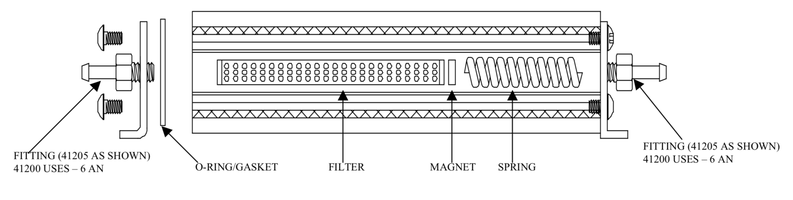

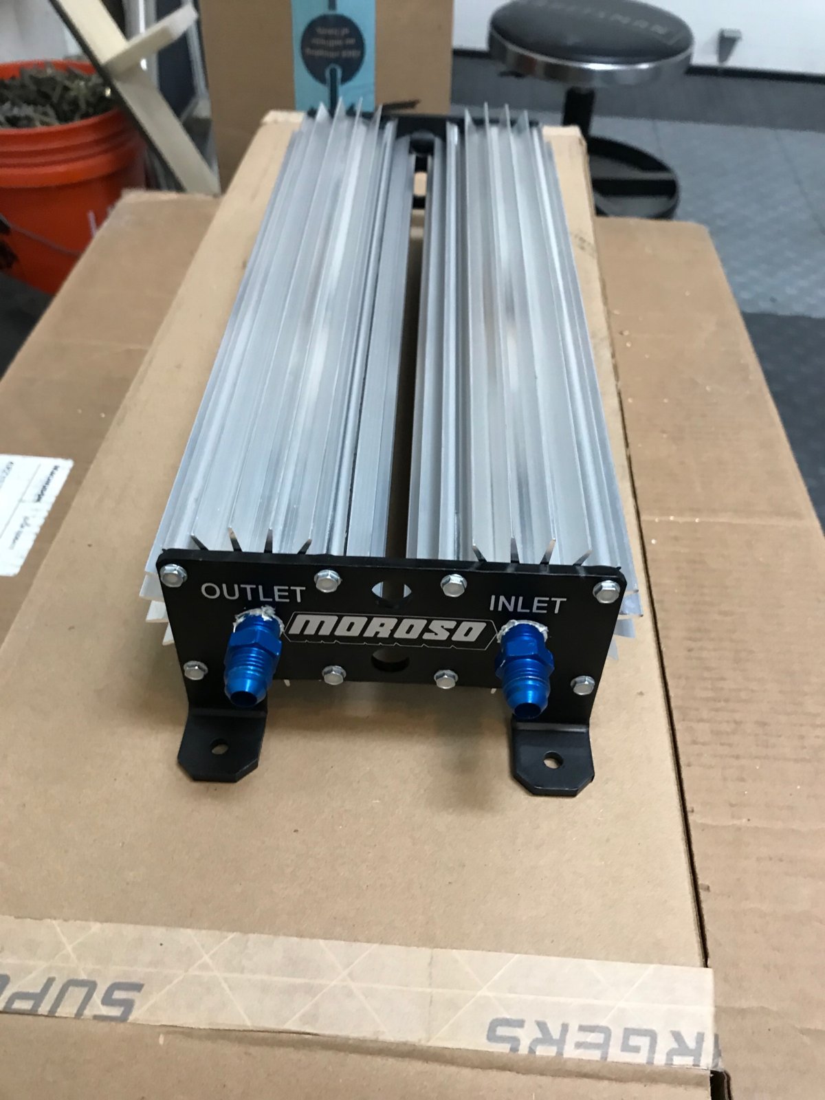

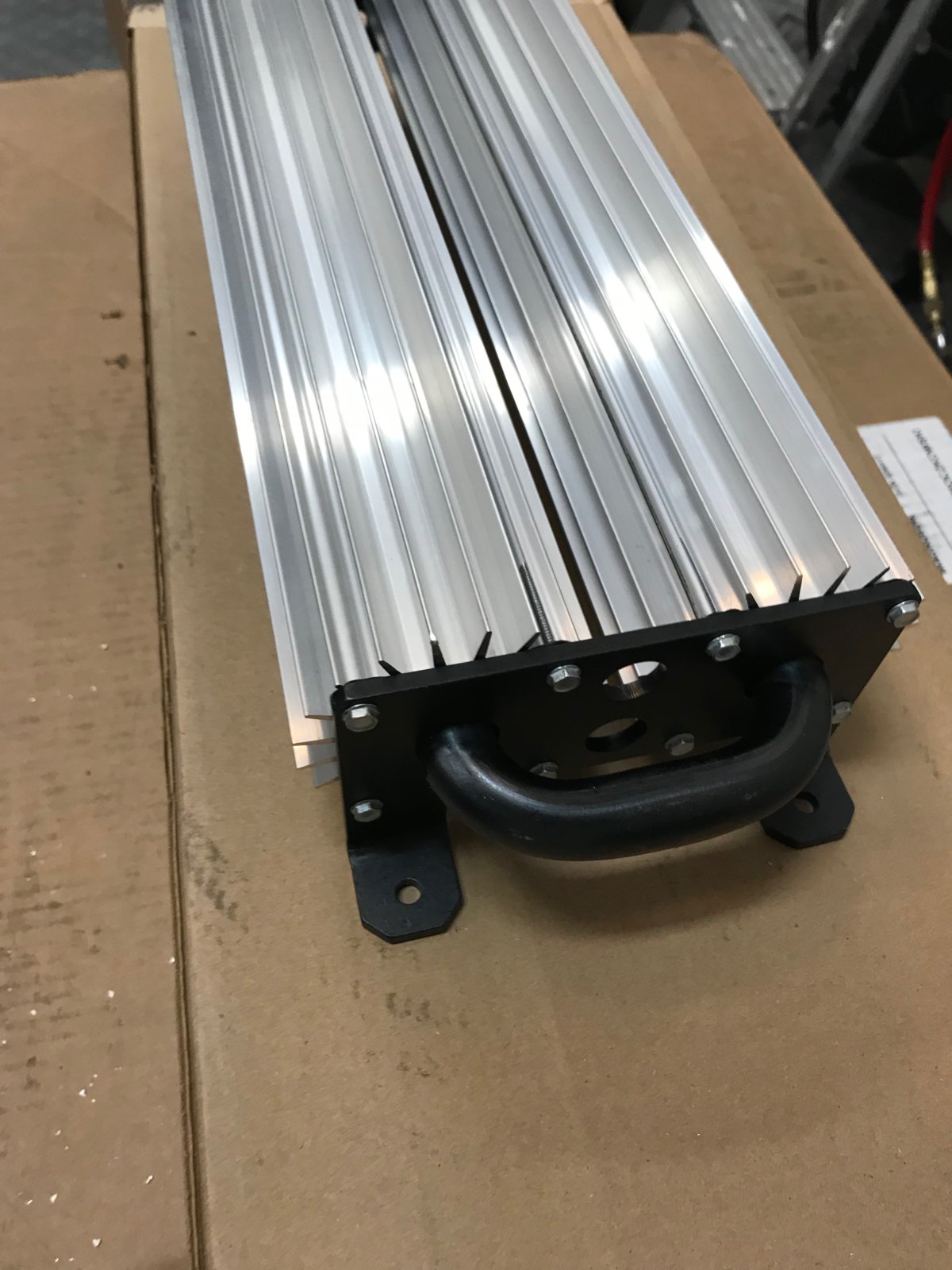

Moroso 41205 Heavy Duty Transmission Cooler/Filter

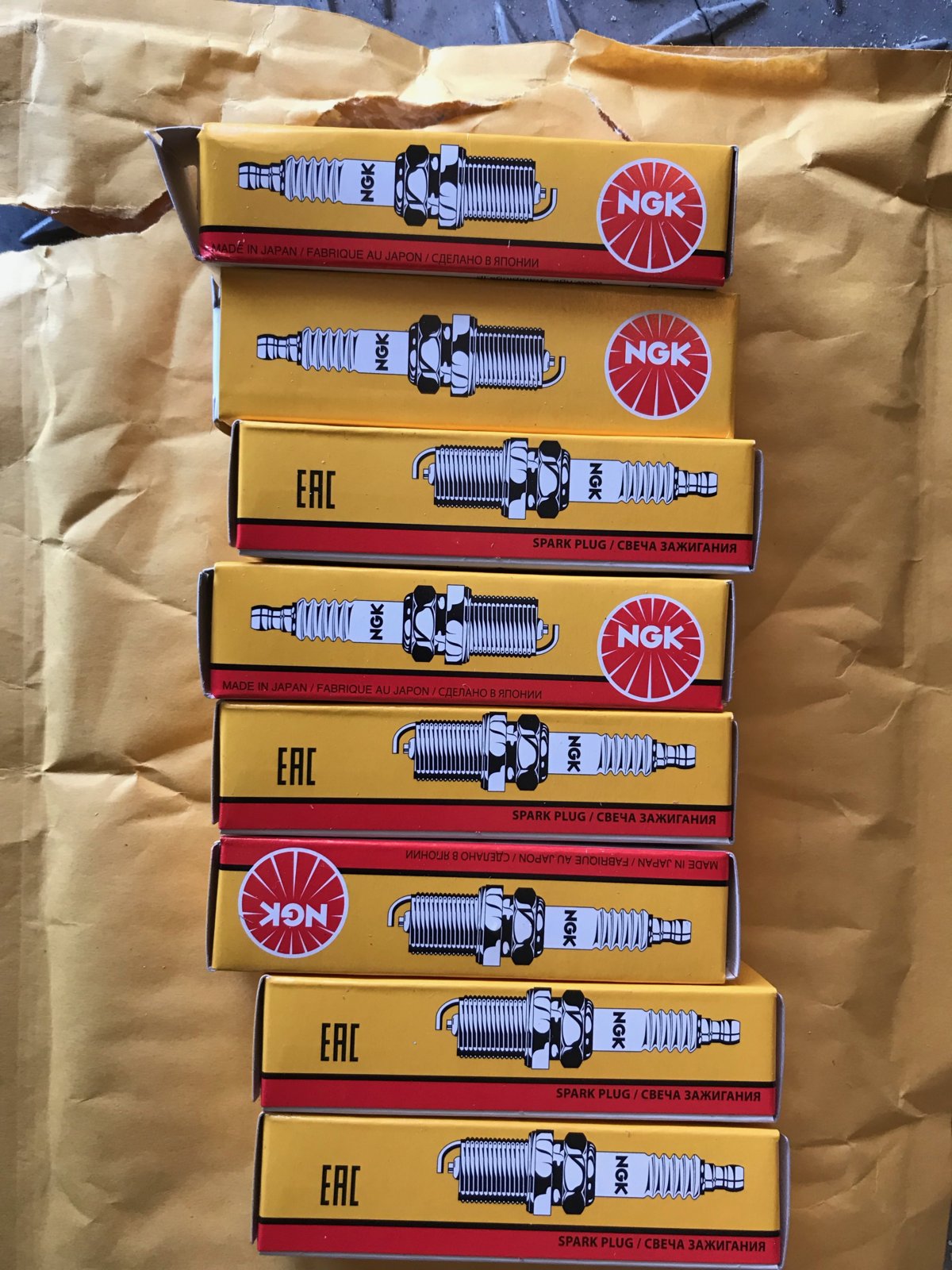

NGK Spark Plugs BP7EFS/3526 - NGK Standard Series Spark Plugs

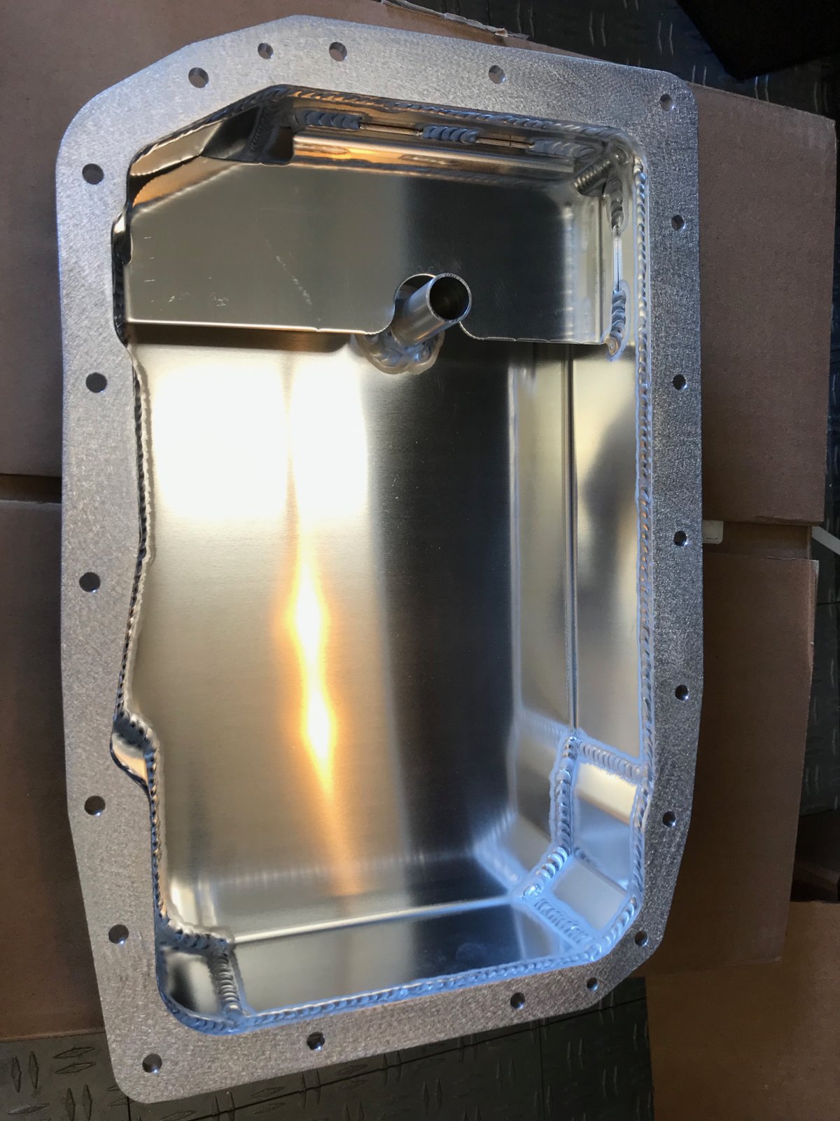

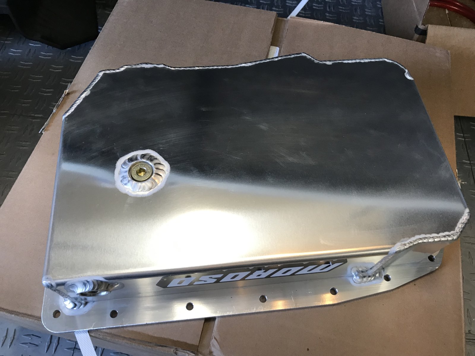

whats up with the hole/tube in the bottom - is that to fill it? i think some 6l80 cars dont have a fill tube

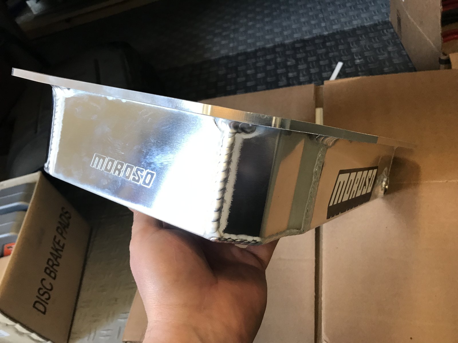

looks real nice
Isn’t that where the filter mounts?

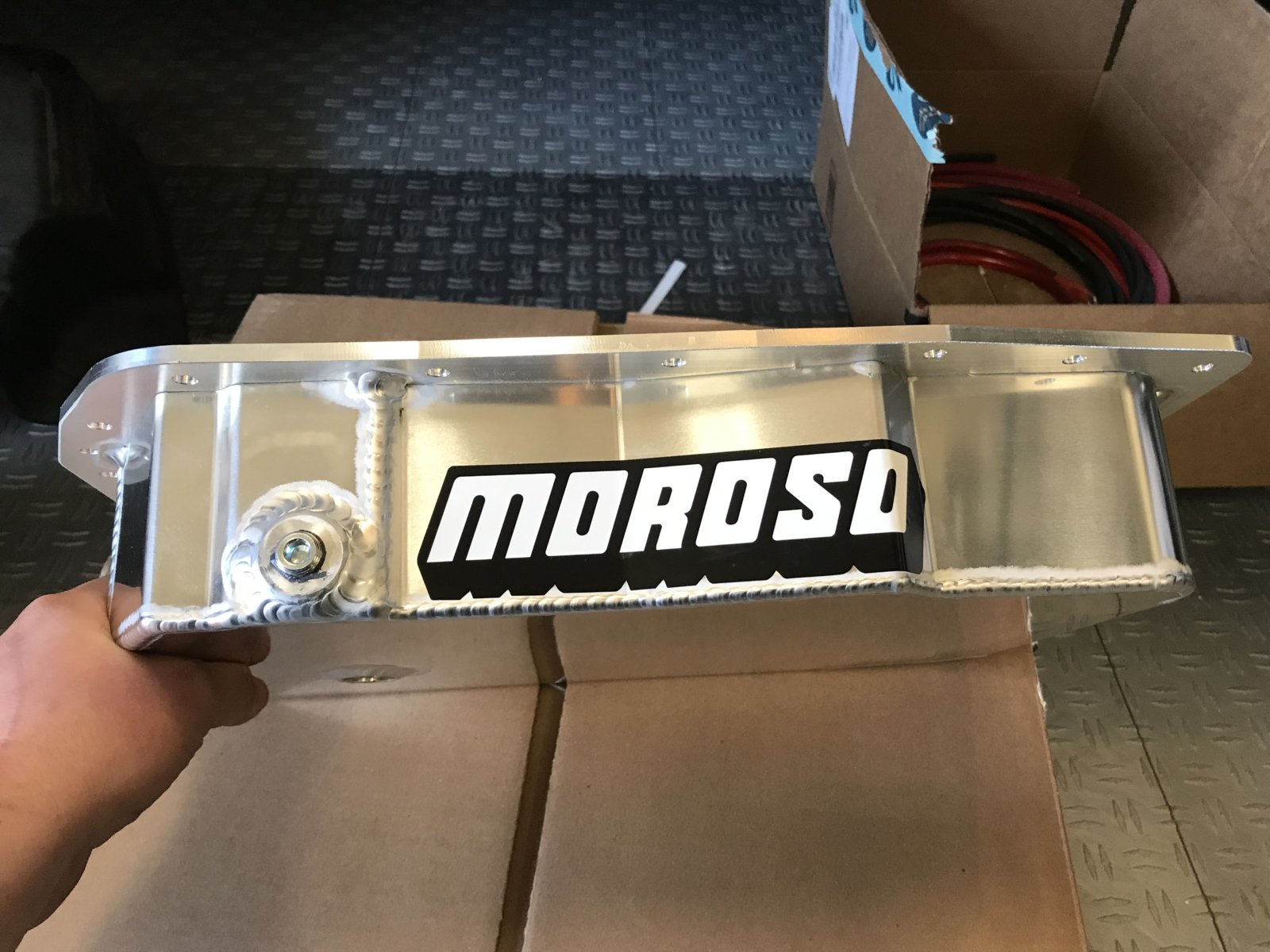

Now the plugs on the side of a pan, do you guys think i could plug my moroso trans cooler to that? So I don’t have to tap in to the stock one?

No... your cooler has to be on a pressurized line... the pan isn't under pressure. If you hooked your cooler to the pan there would be no pressure and therefore no flow of fluid through the cooler.

I am looking forward to the pan install on fitment , I have been looking for something like this . I don't need the extra 3 quarts like most other brands.
