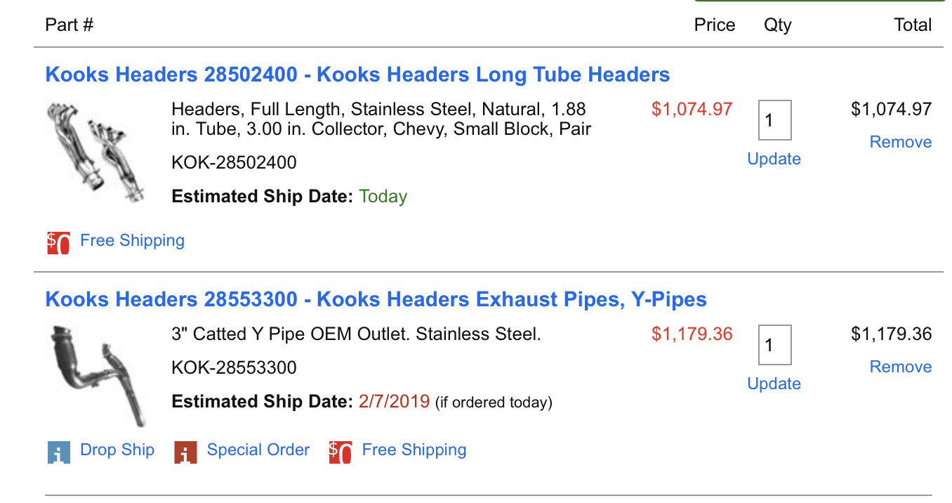

1. Magnacharger TVS1900
2. BlackBear Tune
3. Airaid 202-270 AIRAID MXP Series Cold Air Dam Intake System
4. Kooks Y-Pipe 28553200
5. Kooks Longtube Headers 28502400, *ceramic coating
* Magnaflow exhaust already installed

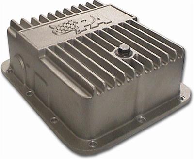

22. PATC Transmission Pan, GM 6L80 / 6L80E, Deep As-Cast

@67RS427 I know you have GMC but similar exhaust do you think that pan will clear the Y pipe?
