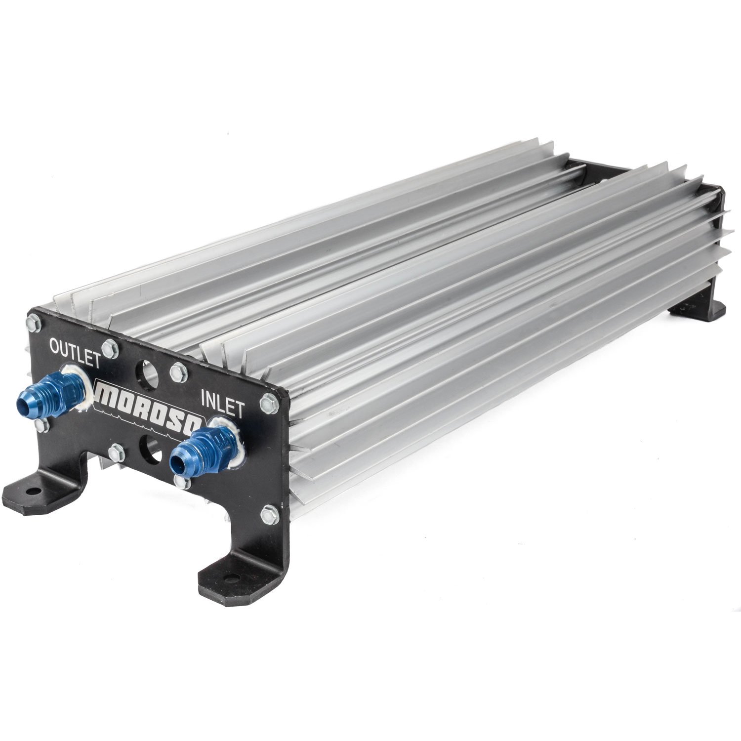

For your heat exchanger, trans cooler or radiator? I have dual fans on my heat exchanger and my transmission cooler. High temps will also kill the transmission pretty quick. Try to keep the trans under 185, 160 to 180 is optimal operation temp. Anything over 200 and you are starting to burn up clutches.
Chrismnj
Chrismnj
Sep 17, 2015
1,227
2,121
NJ
radiator, I will try to fit bigger trans cooler in there,
Moroso Heavy Duty Transmission Cooler/Filter
Part Number: 710-41205
not sure where to put it don't want to black radiator too much there is also a SC cooler going in, maybe under a truck closer to transmission.
